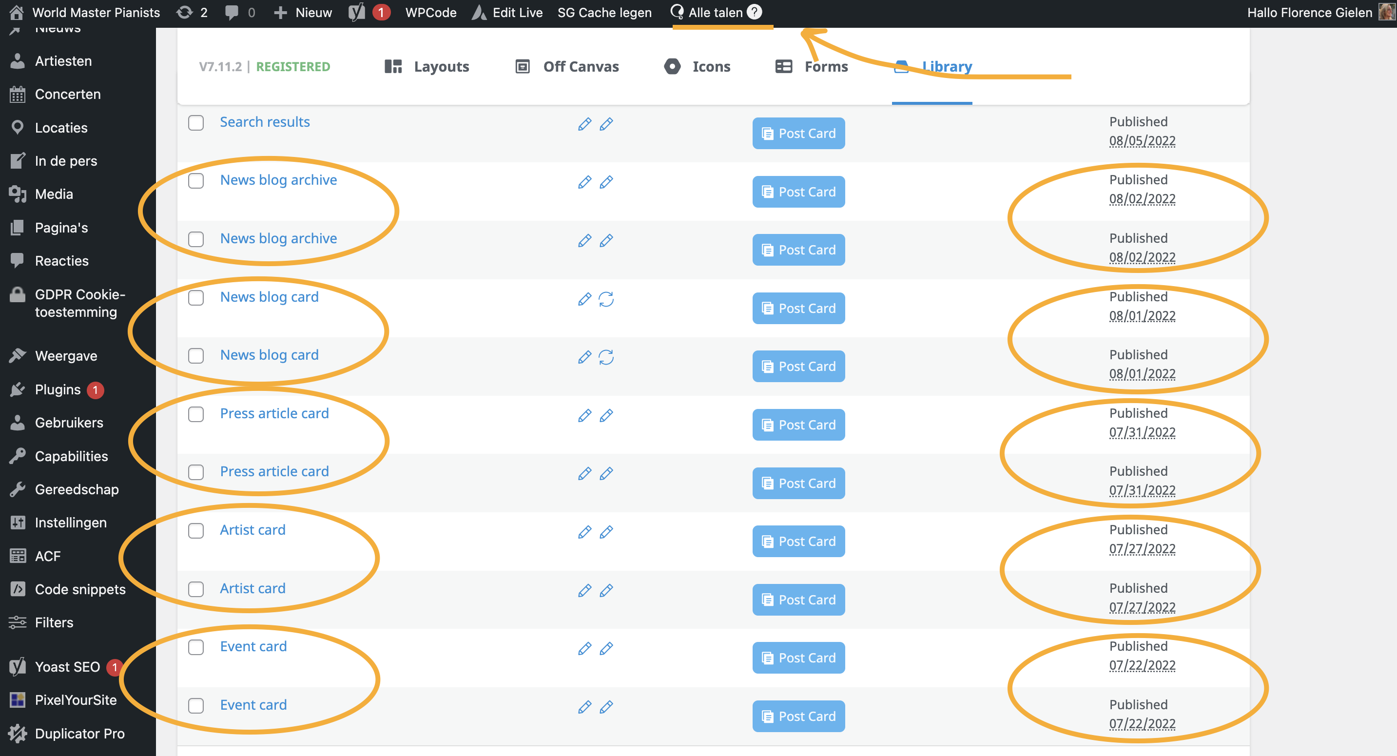

I am so sorry, but I don't know.. I've updated WPML without working on the website the past couple months. Only this month have I actively worked on the website and started noticing it - and I contacted you not long after. But it might have the same cause as the duplicate media?
What's strange about these duplicates is that they seem to be translations - however, when I go to the post card librabry > and click 'english' at the top, they don't show up. But when I click 'all languages' they do show up. And they all seem to have been published at the exact same time.
November 15, 2023 at 4:49 pm #14819053
WPML Supporter since 08/2022
I appreciate your response.
Regrettably, I must inform you that you will need to re-establish the connections for the translations manually by following the instructions provided at this link: https://wpml.org/faq/how-to-link-already-translated-pages/ .
Please identify each untranslated "Post Cards" and reattach them to the appropriate language, ensuring that you set the correct default language if necessary.

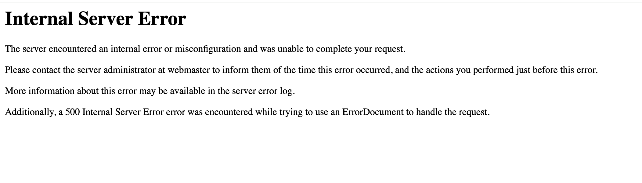

November 17, 2023 at 5:06 pm #14865363
frisoV-2
Please just help! It's been 10 days! All of these issues are the same issue. WPML is duplicating things. I tried removing the translations of everything and now my entire website is down.
