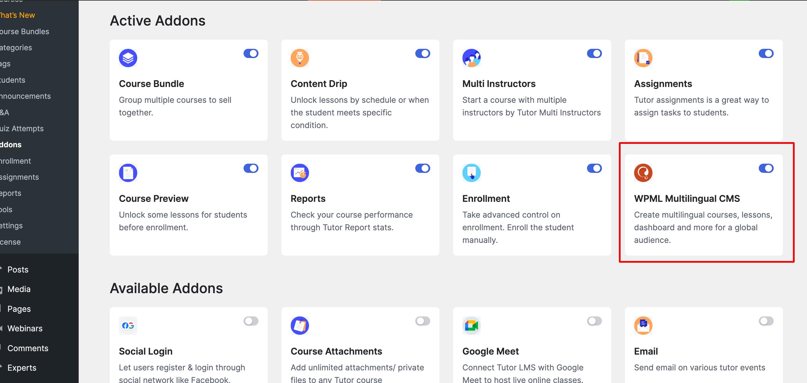

This addon is already install and set it up but still having same issue.
April 25, 2025 at 12:54 pm #16968634
camillef-5
you can see here

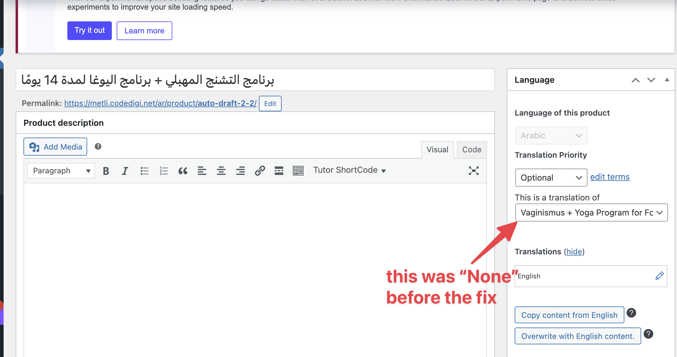

Checking the products, I noticed that 24040 was not the translation of 24038. I changed Translation of "NONE" for Translation of "Vaginismus + Yoga Program for Fourteen Days" and saved: hidden link;
As far as I can see, now it's possible to add the Arabic product to the cart. Can you please confirm?

The problem was that the bundled course and its translation weren't connected. So, you have to go to the secondary language product of the course and edit it. Make sure it's a translation of the original language course. Check the screenshot attached, please.
Best Regards,
