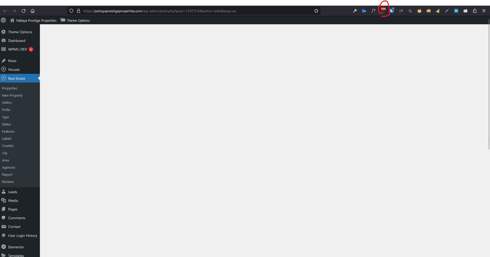

I have been using WPML on many different sites but never have encounter this problem. The issue that I am currently facing on this particular site [hidden link; is that the edit screen for property post type is taking really long to load. This occur mostly in the draft properties. Basically what happening is every time when draft property post are load, it either take about 100s + or not load at all.
Here this is some error I get from console log.
action "wpml_action"
data '{"key":""}'
endpoint "WPML\\Media\\Translate\\Endpoint\\PrepareForTranslation"
nonce "6f62450781"
It could be with WPML media translation ?, fyi I have already turn this options off in the settings.
Anyway Can you please give us any suggestion on this can be improved.

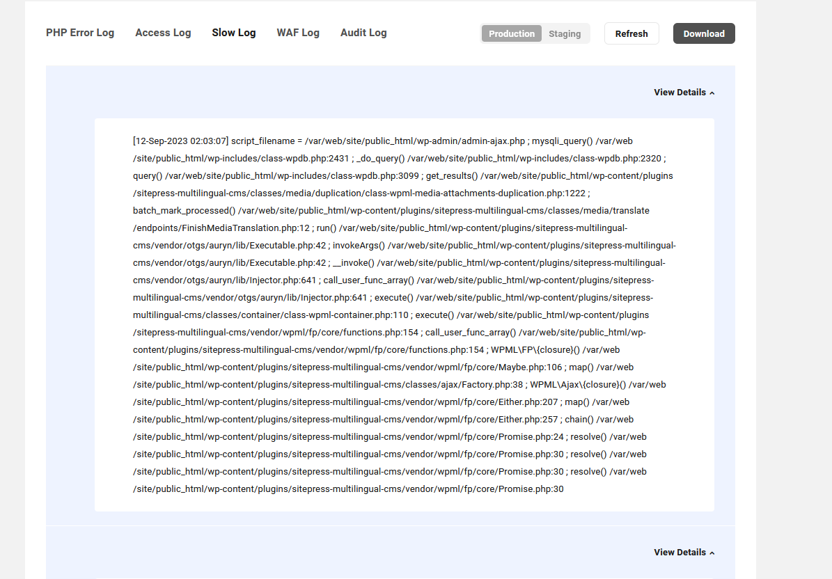

what actually happening right now is, in some case loading the property post edit screen, load super slow or sometime it don't even load at all.
For more info here this is a slow log I get from the hostings, it look like the source is coming from the WPML plugin itself.
Please kindly suggest me any solution or assist me with this and not the debug of letting me deactivate the plugins one after another.
Thank you
