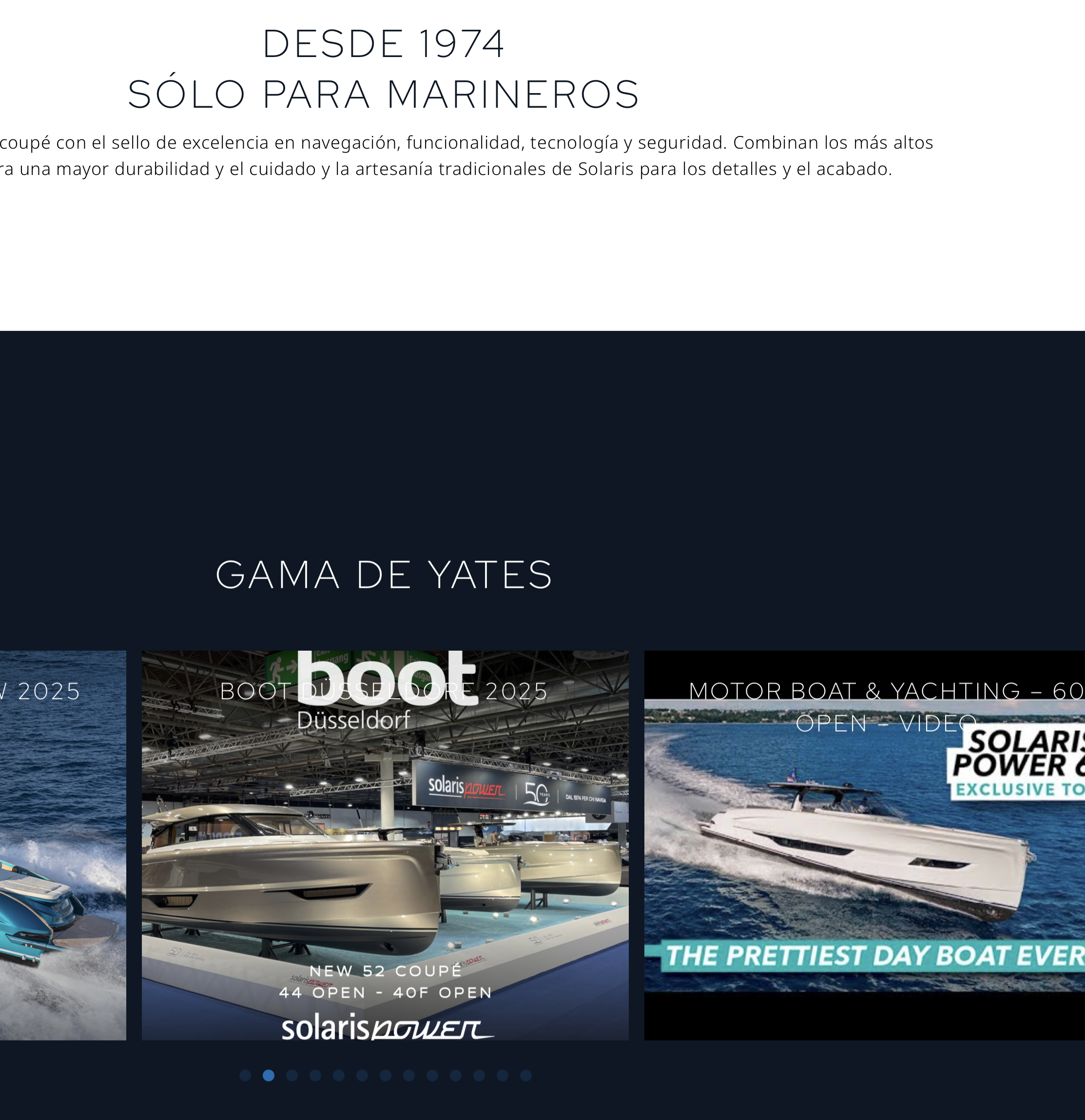

I am trying to use Elementor Loop Grid to filter posts with terms and tags. It works correctly in the default language (English), but there is an issue with filtering in secondary languages. Posts are not translated. You can see the issue on this page: hidden link
The loop grid query is not filtering correctly in secondary languages, resulting in wrong filtering.

No, even if the posts are not translated, they are normally shown in all languages.
They are not filtered properly in the secondary languages that is the topic of this ticket!
I suppose the issue was caused by the tag strings being automatically translated after the latest WPML update, which caused the filtering query of the Loop Carousel in secondary languages to not match the translated tags.
Going into Taxonomy Translation and "Copy to all languages" all tags seems to have resolved the problem.
