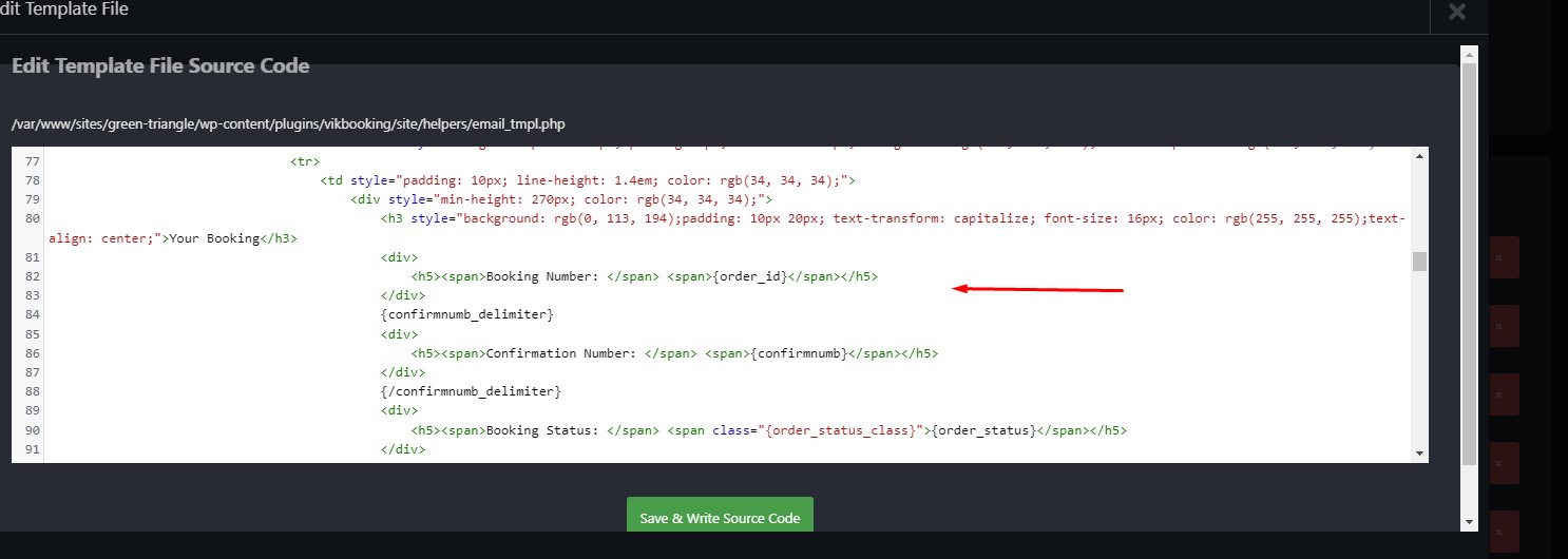

January 29, 2024 at 8:54 am #15236561
Dražen
my both colleague suggested a fix and this needs to be adjusted by the plugin author, we can not fix the issue for them. Or they can join our program and we will be glad to help them in making this plugin compatible.
I have checked the file and can see the strings are not translatable, image attahced.
Please contact them further as they need to follow our suggestion or join our program.
