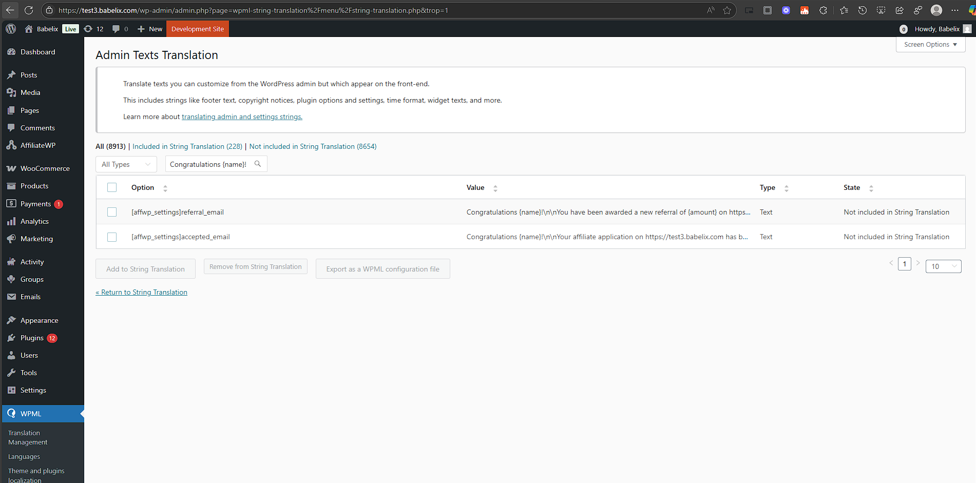

July 9, 2025 at 8:48 pm #17221078
Thank you very much for the test site!
According to AffiliateWP, the plugin does not yet support translation for email templates:
Lastly, when translating the email content sent to your affiliates in AffiliateWP » Settings » Emails, there is currently not a way to set multiple versions of each email for each language separately. As a workaround, it is recommended to include a version of each language you are supporting combined in the main, default language email settings for each email content section. Also, email template tags must remain in English.
Source:
Surely they could also use WPML String Translation to translate the texts from admin screens, but for this, you would need to add the strings again.
Please try this:
Go to WPML > Translation Management > Dashboard > Other texts and search for something very random that will not lead to any search results.
Once no string is found, you will see options that allow you to locate strings.
Use the option to search for texts in admin screens.
Here, search for the texts from the email, then add them to WPML String Translation and translate them.
Guide:
https://wpml.org/documentation/getting-started-guide/string-translation/finding-strings-that-dont-appear-on-the-string-translation-page/#register-admin-and-setting-strings-for-translation
Now, create a new affiliate in a second language and check if this solved the issue.
If this does not solve the issue, I would suggest you contact AffiliateWP about it and ask what state they are in obtaining 100% compatibility with WPML.
