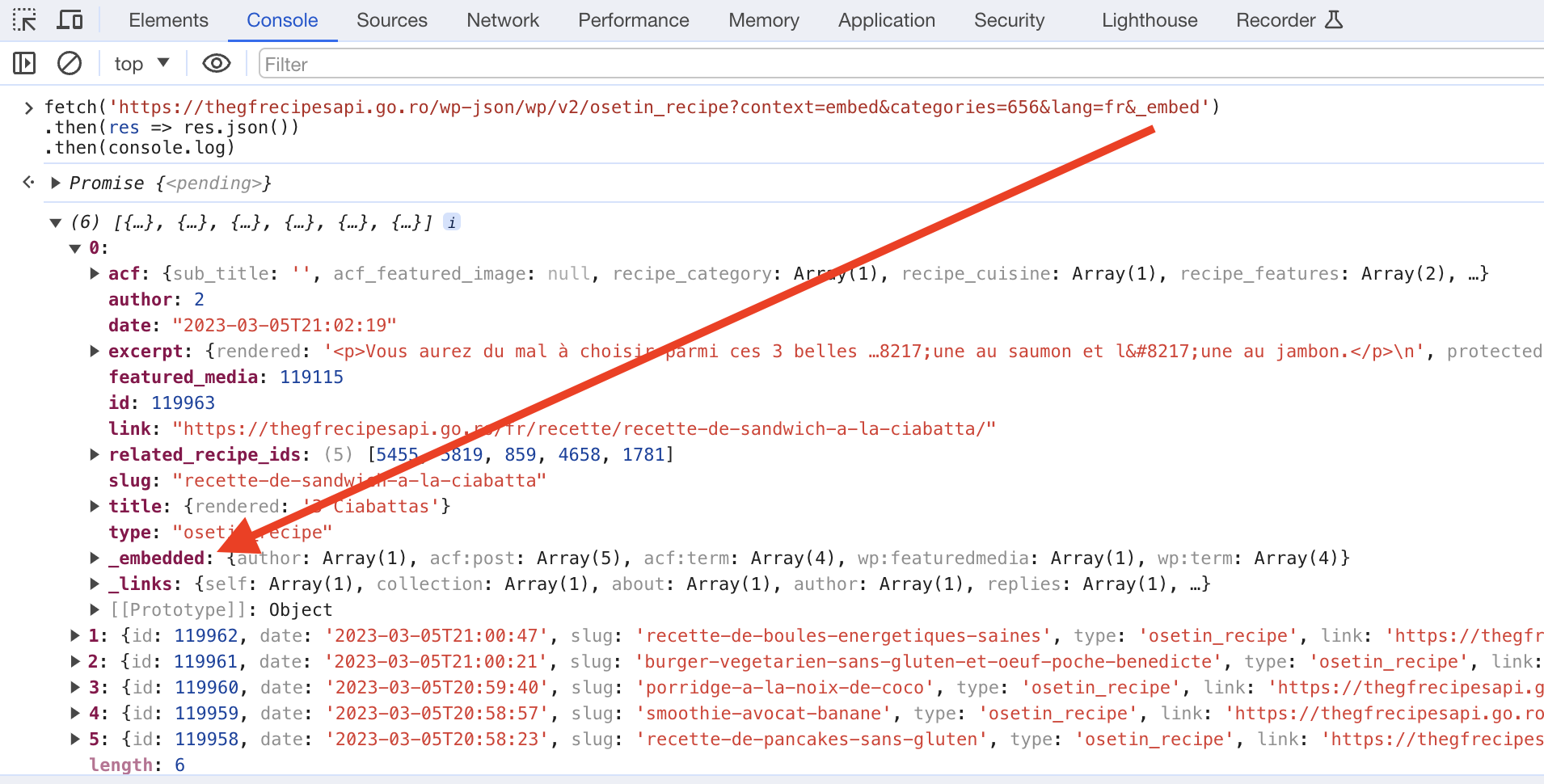

Nigel WPML Supporter since 02/2016 Timezone: Europe/Madrid (GMT+02:00) |
I have found that using 'lang' as the parameter to specify language in the request (you are using 'wpml_language') appears to fix this problem. You can see in the screenshot I used 'lang=fr' in the request and the response includes the expected '_embedded' property. Could you please modify your requests so that they use 'lang' as the parameter to specify the language. |

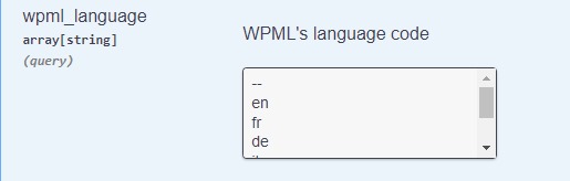

raduV |
Swagger API extract WPML_language (attached a screenshot) |
