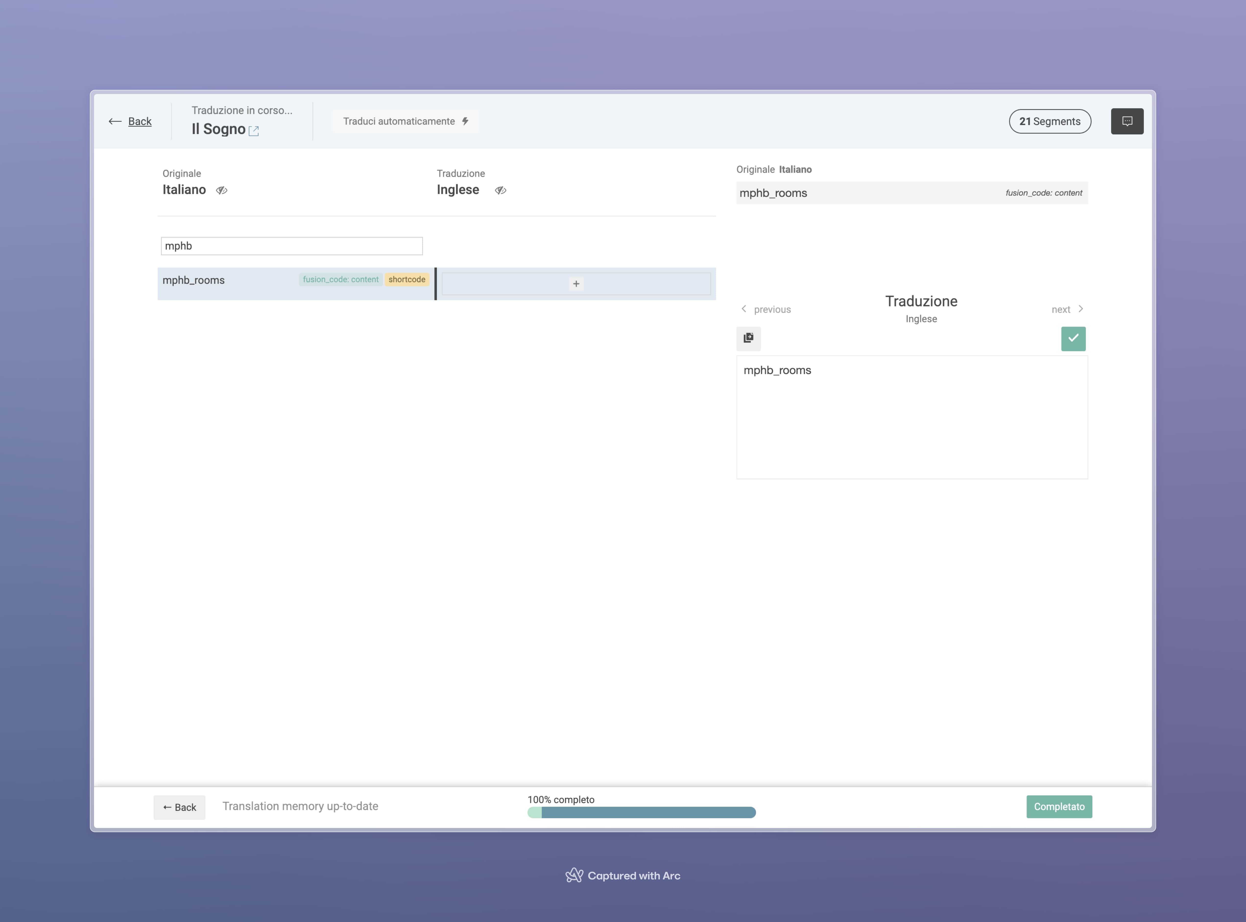

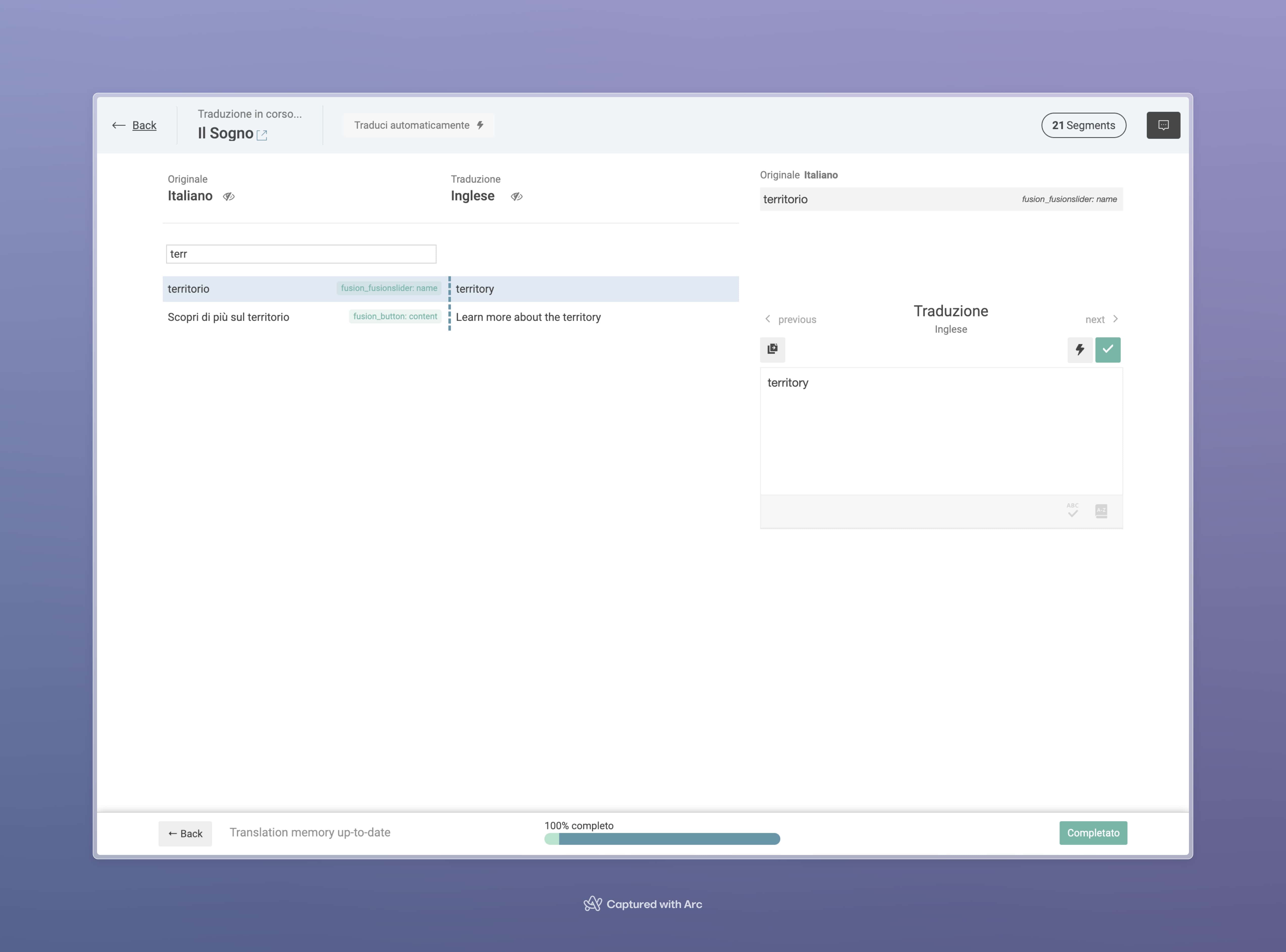

Perhaps it was a temporary error, I'm glad that the 500 error is not happening anymore. As for the broken layout, I analyzed a few pages and saw that some shortcodes were either untranslated or not correctly translated.
In the "Il sogno" page for instance, the hero slider was translated to english, but it shouldn't (see screenshot). Also, on the "Gli alloggi disponibili" part, the shortcode itself didn't have any text assigned to it in the translation (also see screenshot). It's recommended to manually search for shortcodes and links, as they might not always show up directly on the Translation Editor. Here's a detailed explanation, in case you find it necessary:
https://wpml.org/faq/how-to-translate-urls-shortcodes-and-html-attributes-using-the-advanced-translation-editor/
Please let me know if you have any further questions.
