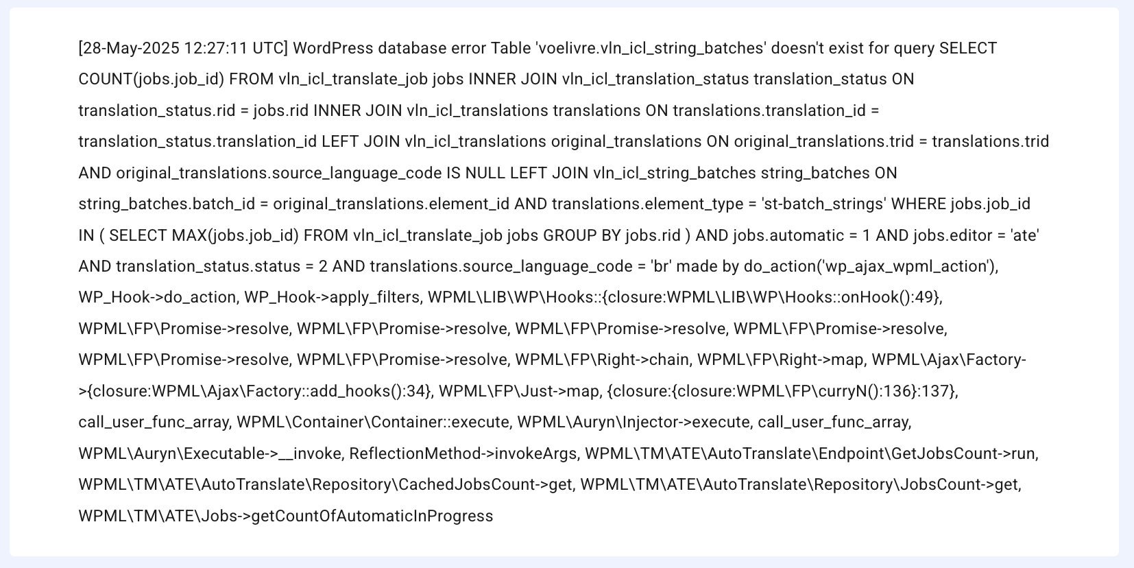

May 28, 2025 at 2:07 pm #17083939
Fabio Fava
Hey Carlos,
I've had contacted my hosting, and the attached image is the last error triggered related to WPML. It seems that it's stopped triggering errors, but I'll keep watching for some more time to make sure it's all good. Your patience is greatly appreciated.
Thank you so much, cheers!

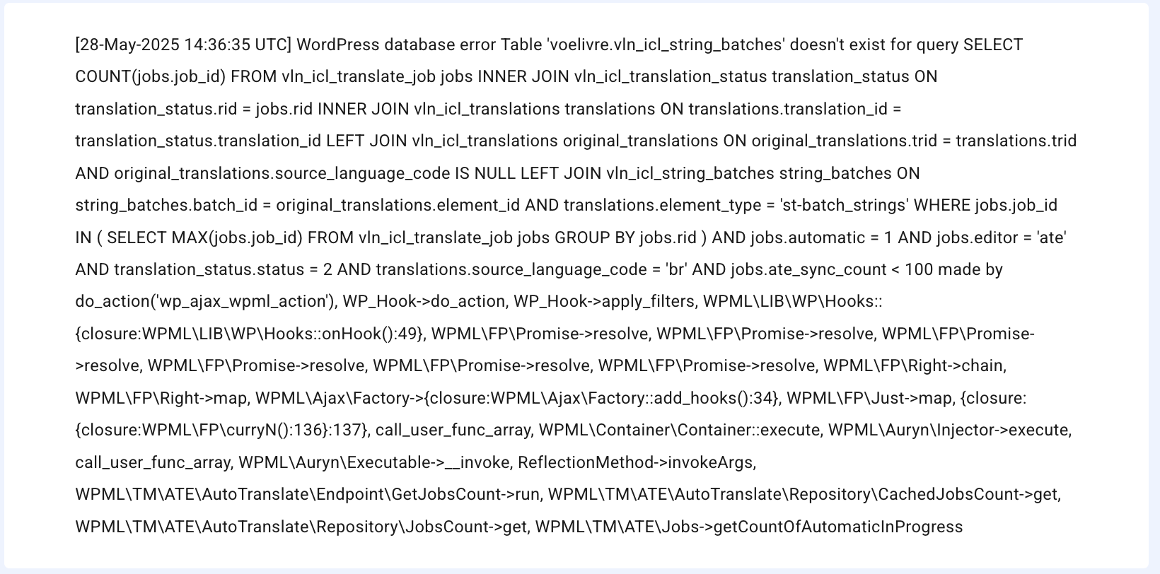

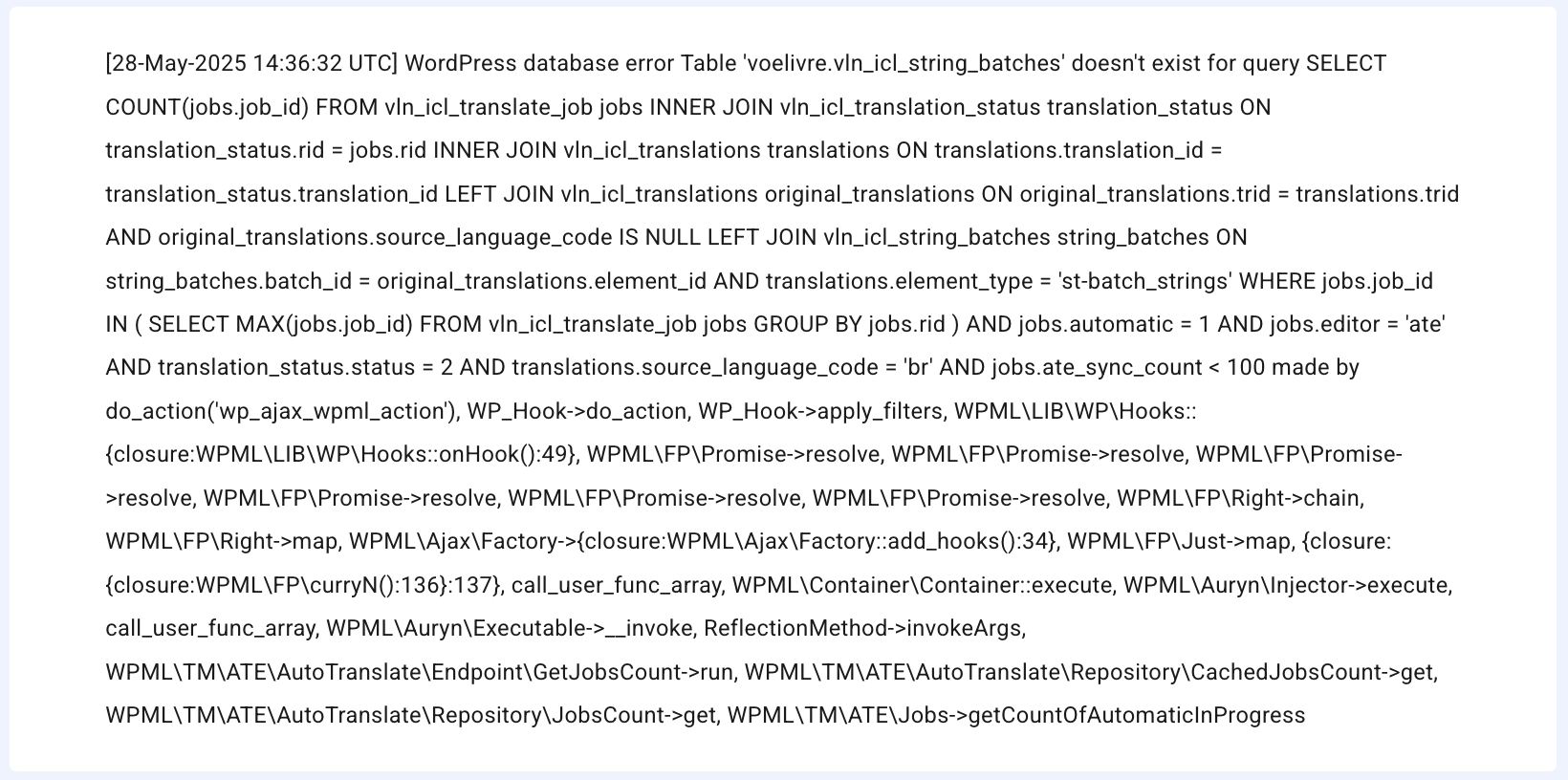

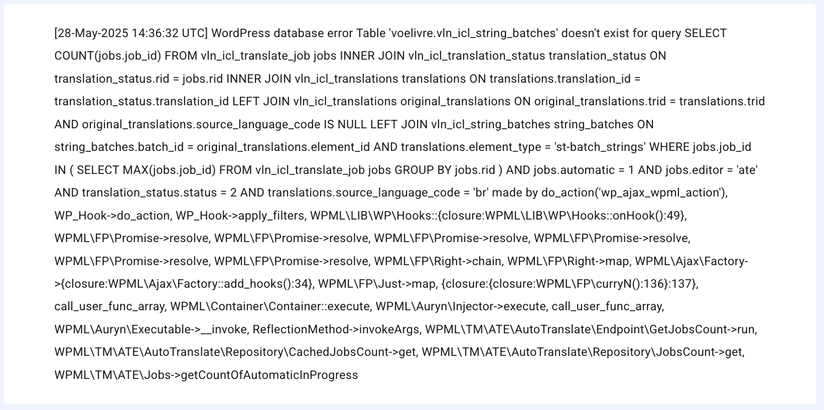

May 28, 2025 at 2:43 pm #17084100
Fabio Fava
Hey Carlos,
As you can see on the attached pictures, I've had 4 more errors triggered on the last hour or so. It seems that when I login to my WP-Admin, errors occur.
I've removed Paid Memberships Pro (PMPro) and WooCommerce (WC) from this website, and I'm affraid there are lots of requests to non-existing pages, products, and remaining WooCommerce, and PMPro membership data left behind.
The site is currently running only Brazilan Portuguese (as a Custom Language, since I've changed its prefix from "pt-br" to just "br"). All other languages are hidden and I'd like to clean all data for the hidden languages, plugins, products, etcetera; is that possible?
Is there any safe way to "clean" WPML from removed plugins (also Theme My Login was removed, among others), so to help WPML to be faster? I've carefully cleaned what I could from the DataBase using Plugins Garbage Collector (not removed any "icl" tables), but I feel that lots of remains are present in many places on the website (strings, etcetera).
I'll keep looking forward from you on my issues, please check the attached screenshots from my hosting Logs.
Thank you very much and best regards
May 28, 2025 at 8:44 pm #17085443
Carlos Rojas
WPML Supporter since 03/2017
I have added the missing table, so the latest error won't appear again 🙂
To remove the information of any language, first you must disable it, and then you will see the option to remove the information in that particular language, as described in this link: https://wpml.org/faq/how-to-completely-remove-a-language-from-your-site/
