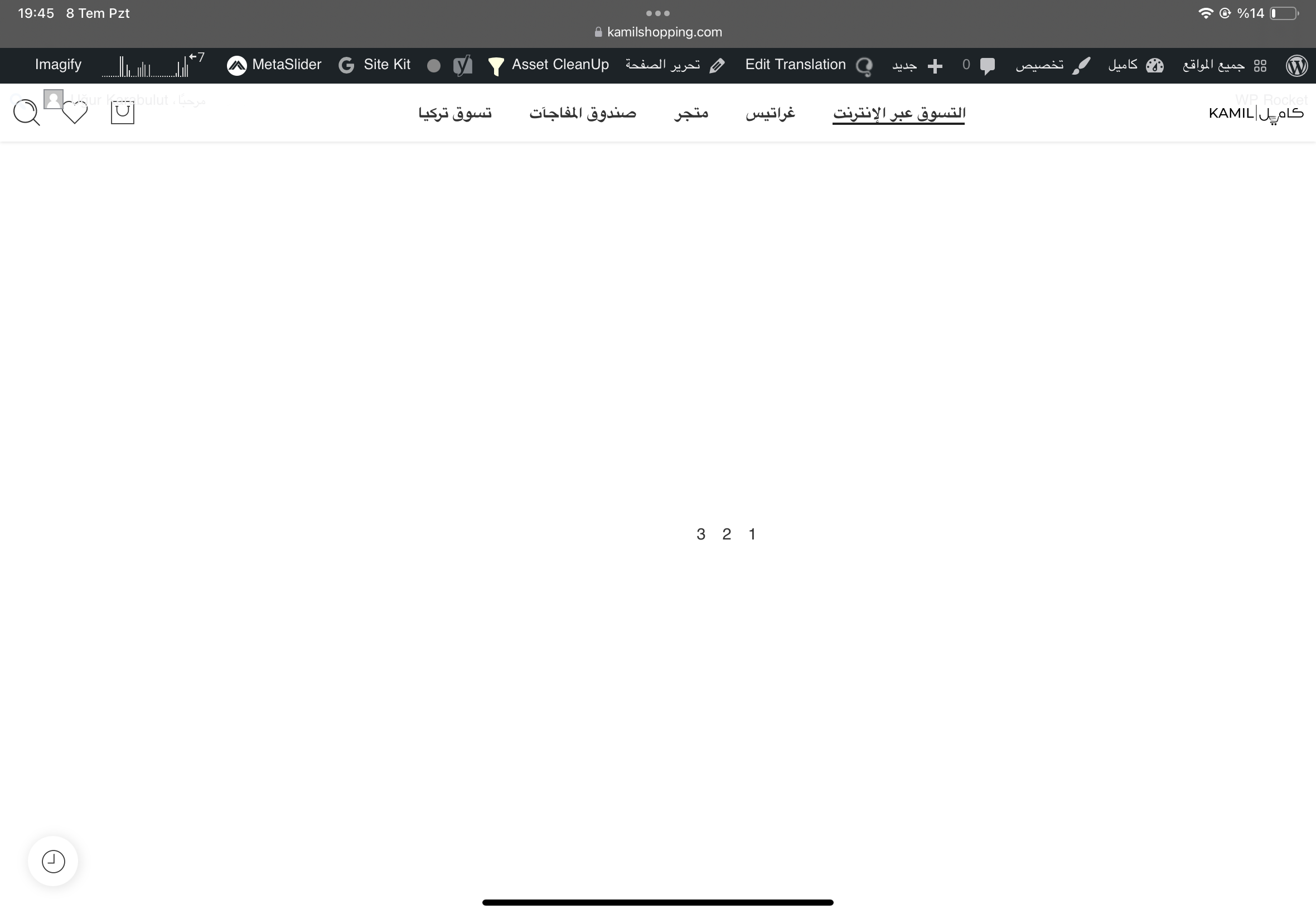

I am trying to fix a layout issue on my website hidden link using WPML.
Here is the video about problem.
And ı attached a ss may it helps to find the source of issue
There is a large space on the right side in the Arabic interface.
How can I remove the large space on the right side in the Arabic interface?

Regarding this problem, while the tablet also has this problem, the product slider has the same problem on mobile.

It appears that MetaSlider is causing the issue. Please reach out to the theme author to report this issue. If you don't receive a response, you can attempt to resolve it using the following custom CSS code. Go to WP > Appearance > Customize > Additional CSS and paste the code there.

I appreciate your volunteering to help. Thank you so much. Theme authors no longer offer support. This code you gave is much more useful, the remaining problems of the site have been solved and the product slider works on mobile too. Only metaslider is not working, it is not moving at the moment. The only problem is that Metaslider does not work in the Arabic interface.

The issue isn't related to String Translation. It's caused by the "text-indent: -9999px;" which is affecting the Metaslider on iPad or tablet devices. I've provided the custom CSS code to address this earlier.
