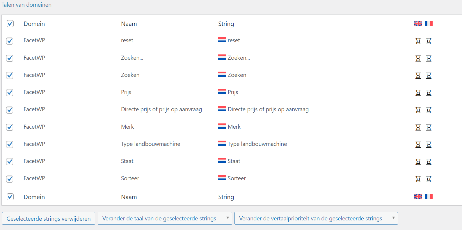

In the same dashboard (string translation) I translated the strings from facetWP. I got popups saying the translation has been saved. But when looking at the front end, it still shows in the default language.
I then selected the strings and pressed on the button "translate" under the "translate selected strings" to see if that would help. (Still in the string translation dashboard). Now there are hourglas icons next to the strings with the message "waiting for translator to translate to ..". I cannot edit anything regarding these strings.
Can you please advise? Am I missing something?
Thanks in advance!

Hi!
It might be that:
- the strings are lying inside the translation basket at WPML > Translation Management > Translation Basket
- or you already created translation jobs for those strings and they are available at WPML > Translations to get translated with the WPML Translation Editor.
Also, it could be that they are already assigned to a translator.
You should be able to complete those jobs by going to WPML > Translations or cancel those jobs by going to WPML > Translation Management > Jobs.
I hope this will solve this issue for you.
Best regards
Andreas

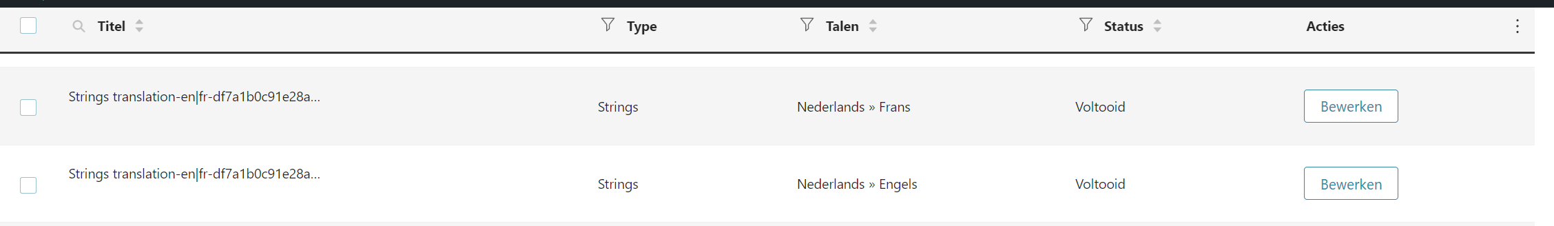

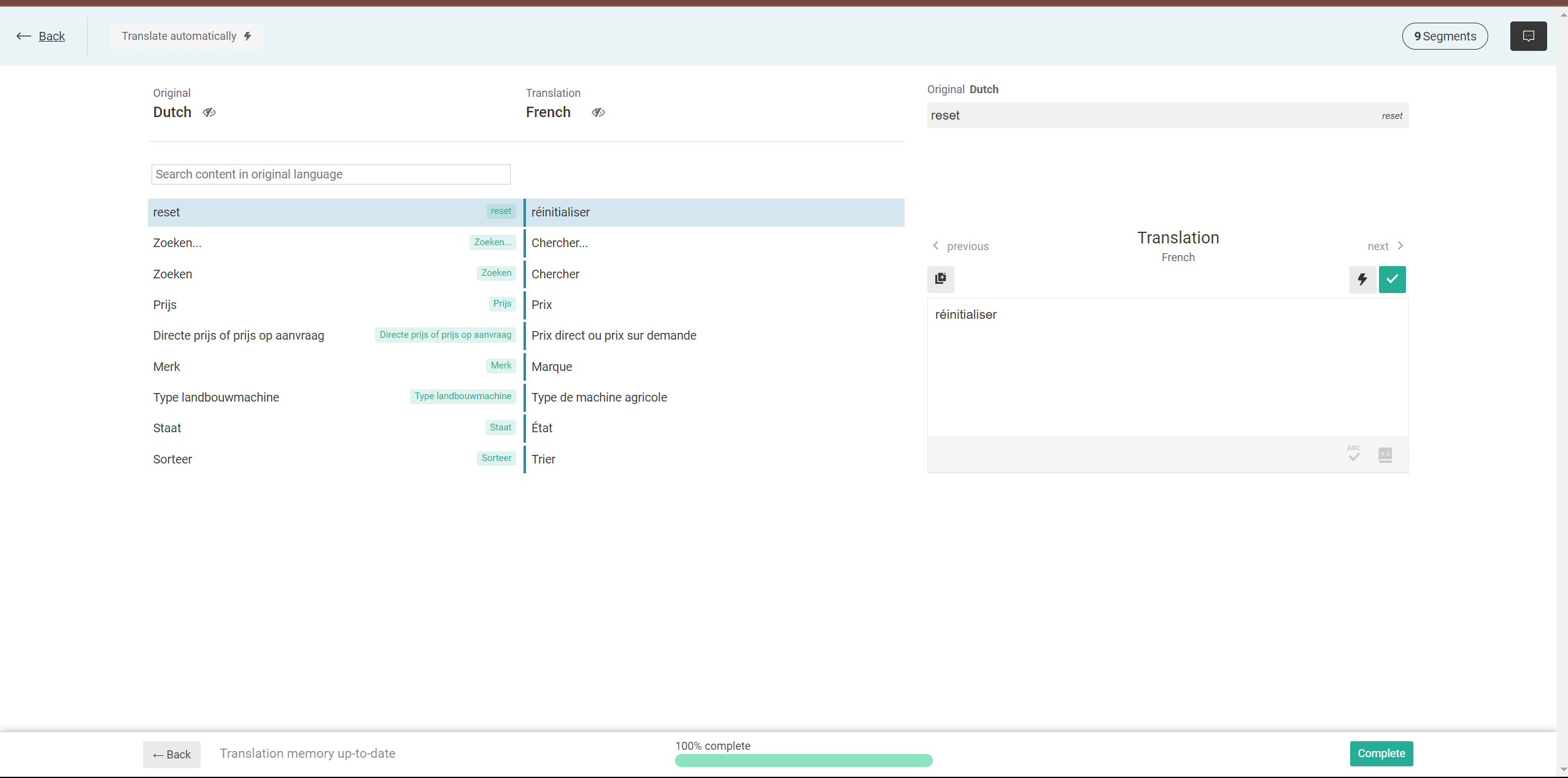

Thank you for your assitance. I was able to complete the jobs in WPML > Translations. But this did not make any difference on the front end.
So now I translated them in string translation and WPML > Translations. But they still show the default language on the front end.

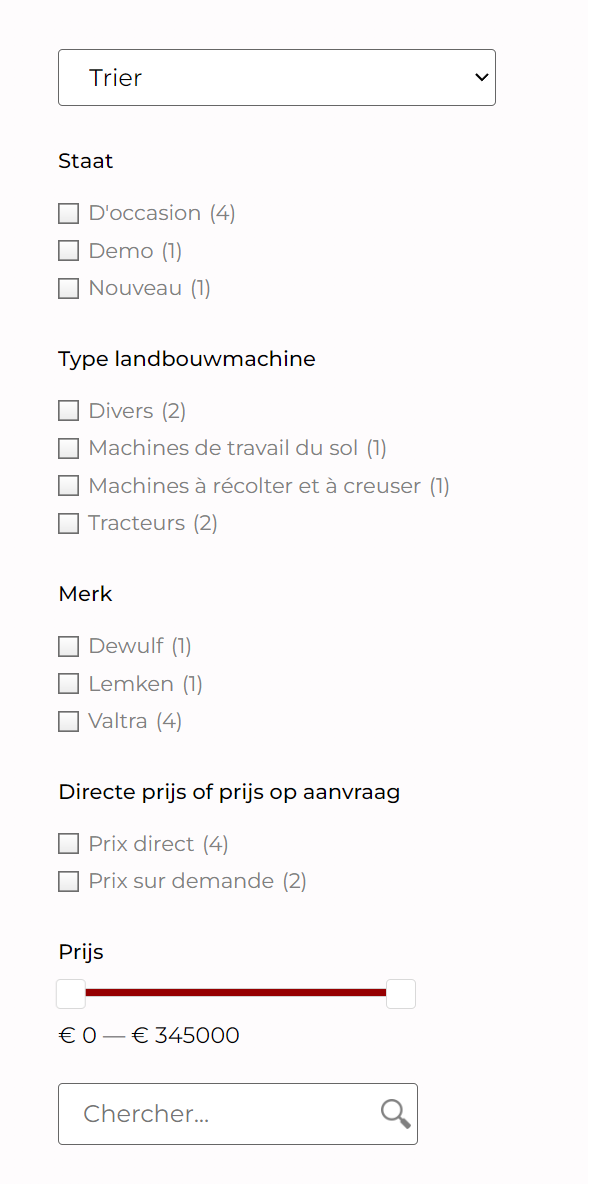

We were able to translate the facetWP with these "workarounds".
For translating the facet choices we used a custom code snippit that is recommended by facetWP when there are no translation plugins.
For the facet labels we changed the title names in the 2 other elementor archive templates.
So now the facetWP filter is fully translated.
We could close this ticket, but still it should not be necessary to be using the code snippet to translate the facet choices?
