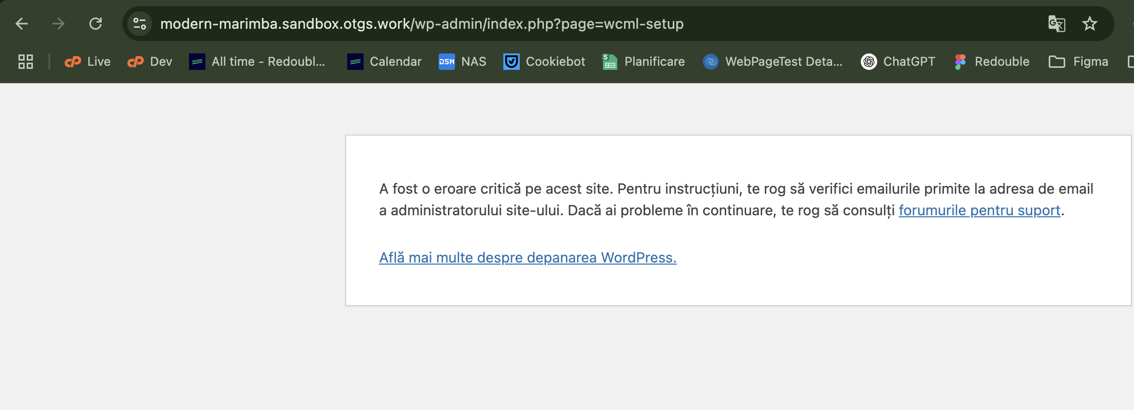

cristianI-5
Hi Dražen,
Thanks for your quick reply and for providing the sandbox environment.
I’ve accessed the sandbox and attempted to install and activate our custom payment gateway plugin (WC_TBI_Blocks_Gateway) to replicate the issue. However, upon doing so, the sandbox crashed with a critical error screen, without any detailed error message.
Since this is a different environment from our dev site (where we initially encountered the fatal error related to accessing a protected property), it’s unclear whether this is caused by the same issue or something else within the sandbox.
Could you please:
Enable WP_DEBUG and WP_DEBUG_LOG in the sandbox environment so I can identify the exact error?
Or check the PHP error log for more details?
Once I have the actual error output, I’ll be able to confirm whether the same Cannot access protected property exception is being triggered, or if something else is going wrong in this environment.
Thanks again for your support — I’m ready to continue the investigation once we can see the specific error.
Mihaela
June 23, 2025 at 8:20 pm #17162508
Bobby
WPML Supporter since 04/2015
Hi Mihaela,
Unfortunately these sandboxes don't have FTP access therefore if a fatal error happens we have to scrape it.
Would you possibly happen to have a staging site where we can access it and take a look at the issue there?
If not we can create a staging site for you using our Cloudways environment which allows FTP access.
Also, just to verify..is this plugin custom? Are you the developer of it?
It's important to note that while we will do our best to assist, support for non compatible and custom plugins is limited.
