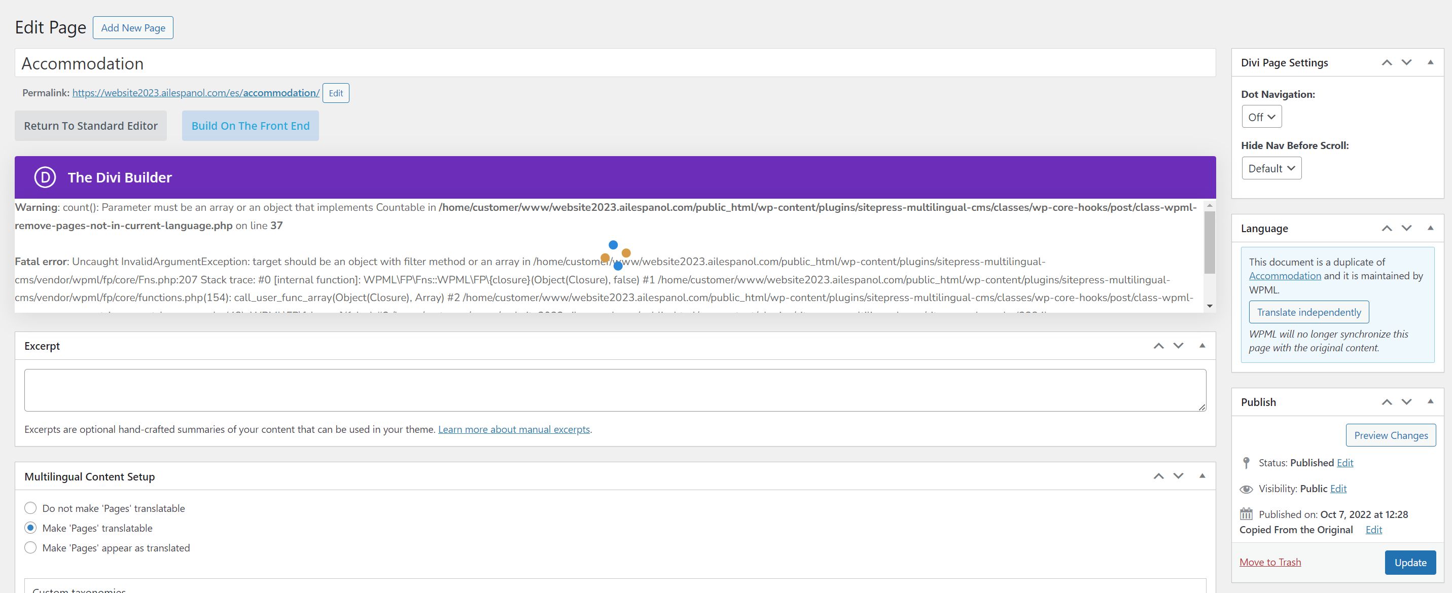

Further testing. I have just done the following:
1) I deleted the Spanish translation for the page Accommodation (I listed all Spanish pages, deleted the Spanish translation of the accommodation page and permanently deleted the page from trash).
2) Using the classic editor, I started the process of adding a Spanish translation.
3) I pressed "overwrite with English content" and pressed OK to the warning popup.
4) My intention was then to press "Translate independently". However, before I could do this the "InvalidArgumentException" was displayed. See screenshot.
I believe that this test result is significant.
