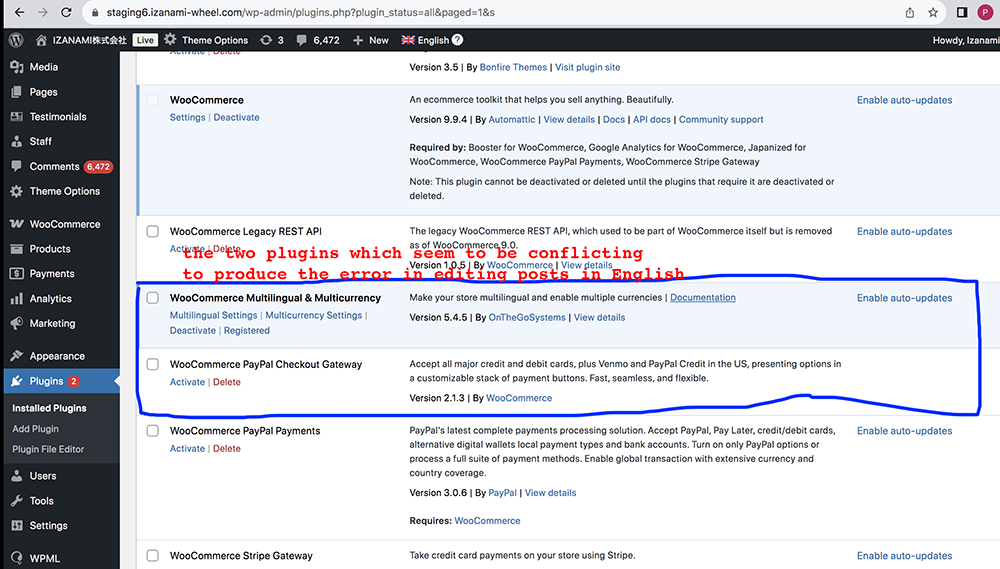

I have performed the checks that you have listed, working in the parent theme (Virtue Premium) and activating only Woocommerce and Woocommerce Multilingual and Multicurrency.
By activating the plugins one by one, the plugin that produced the error when attempting to edit posts and portfolio items in English is the plugin, "WooCommerce PayPal Payments"
When the WooCommerce PayPal Payments plugin is active together with Woocommerce Multilingual and Multicurrency, there error is present.
With either of these two plugins deactivated, there is no error.
I hope this helps. Let me know if you need further information from my end, thanks.
June 23, 2025 at 1:40 am #17157847
Issei Miura
Screenshot of the two conflicting plugins as described above

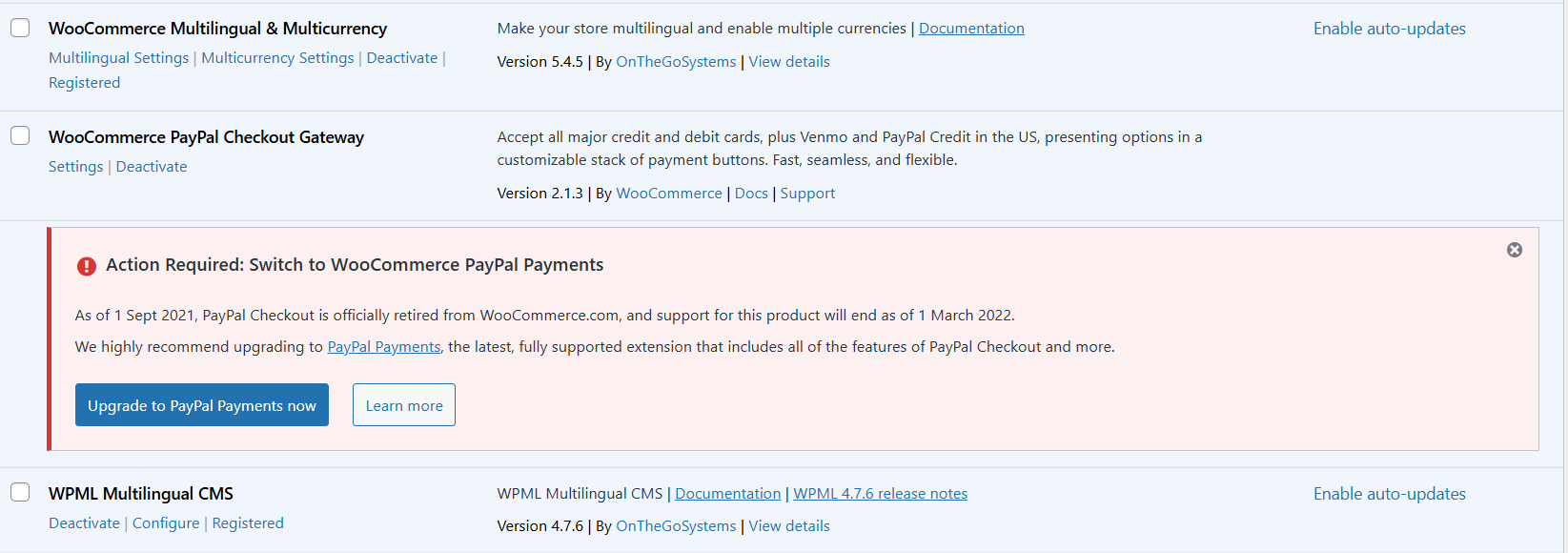

Thank you for the updates. I was able to reproduce the bug. It occurs when both the Classic Editor plugin and WooCommerce PayPal Payments are active at the same time. This appears to be a compatibility issue.
Please note that the WooCommerce PayPal Checkout Gateway plugin is no longer supported. So, make sure you configure the WooCommerce PayPal Payments plugin instead. After that, activate WooCommerce Multilingual and check if the issue still occurs. You can refer to the attached images for more details.
