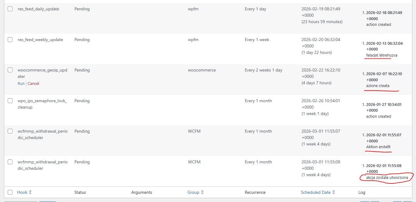

I noticed that some admin text (e.g. “action created”) has been translated, and that the translations appears to be randomly displayed. See attached screen shot made from the English language. Are you sure this is not causing an issue?
There is no reason to translate all this admin texts. How can we have this fixed?
