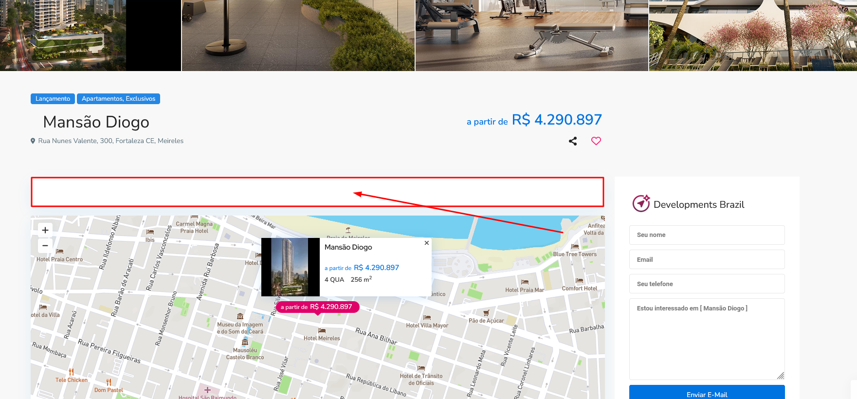

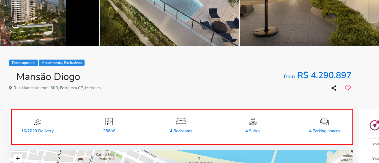

Its missing the overview area in the property (screenshot 318 and 319)

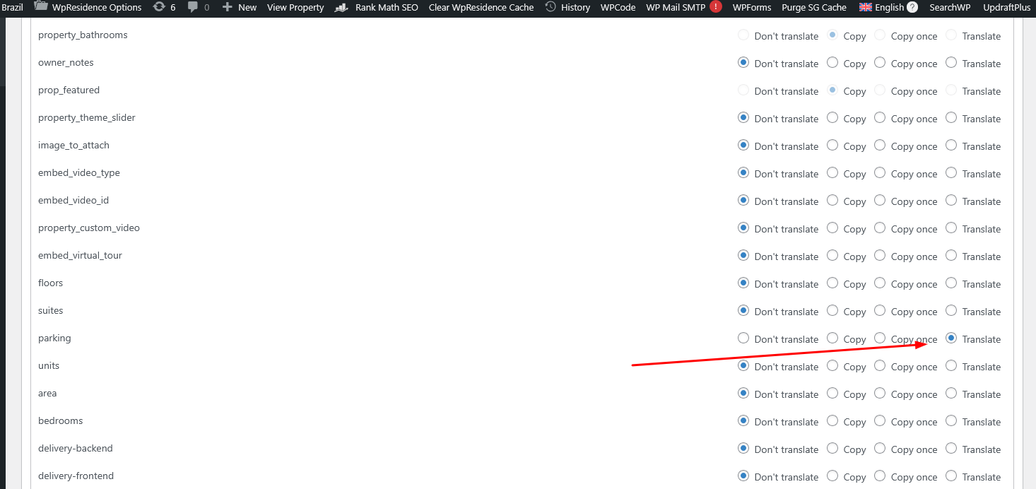

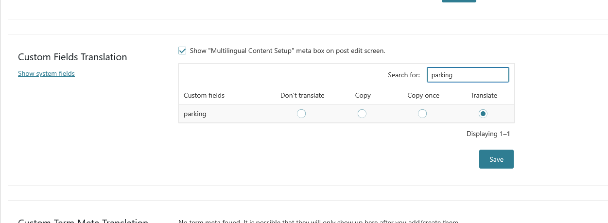

I gave it a try in the settings with parking, because all are disabled (screenshot 320 and 321) but it´s still not working.

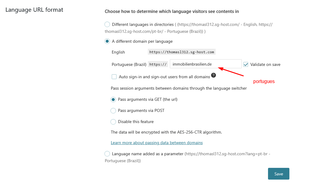

ps. I always use language with 2 different domains, because last tome was always set to directories

As I am using the WPML URL format: A different domain per language
there is
hidden link the main language (english)
and I am unsing this domain: hidden link as the second language (portugues) domain
As I said that their is already a live instance running - on whichone we are not working and can't also not working - I am doing all work new on temporary domains before I switch them.
June 5, 2025 at 7:49 pm #17112208
