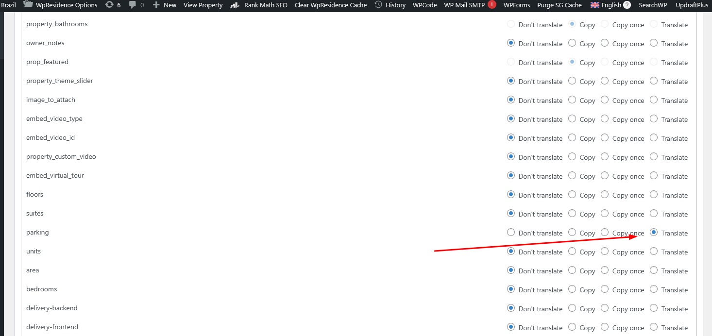

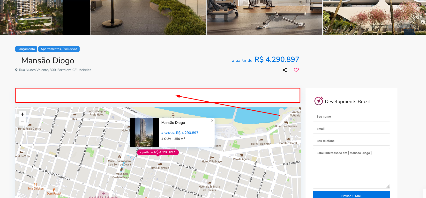

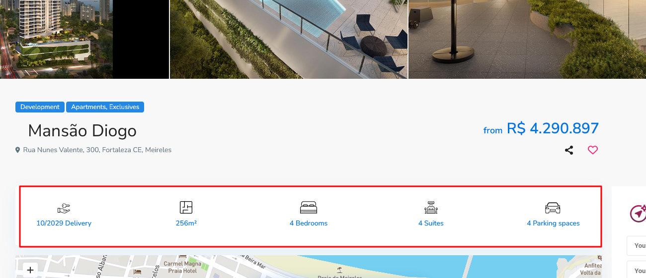

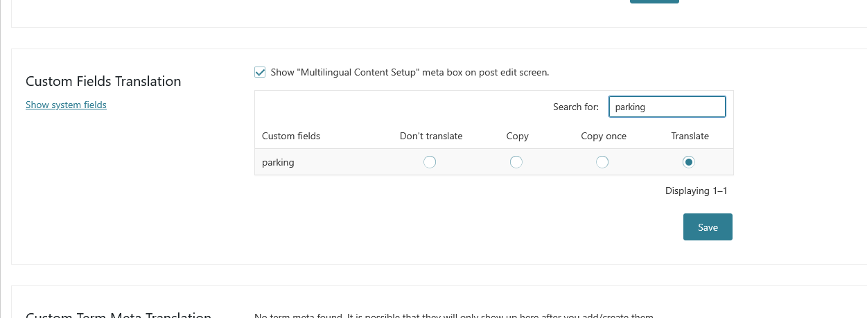

Its missing the overview area in the property (screenshot 318 and 319)
I gave it a try in the settings with parking, because all are disabled (screenshot 320 and 321) but it´s still not working.

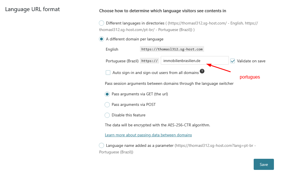

June 5, 2025 at 1:37 pm #17110438
thomasL-104
It's a temporary domain of siteground to create a website. As there is a live instance with lots of problems of the translations, I decided to create it again from zero to have less problems...but...still problems occur

No.
As I am using the WPML URL format: A different domain per language
there is
hidden link the main language (english)
and I am unsing this domain: hidden link as the second language (portugues) domain
As I said that their is already a live instance running - on whichone we are not working and can't also not working - I am doing all work new on temporary domains before I switch them.
