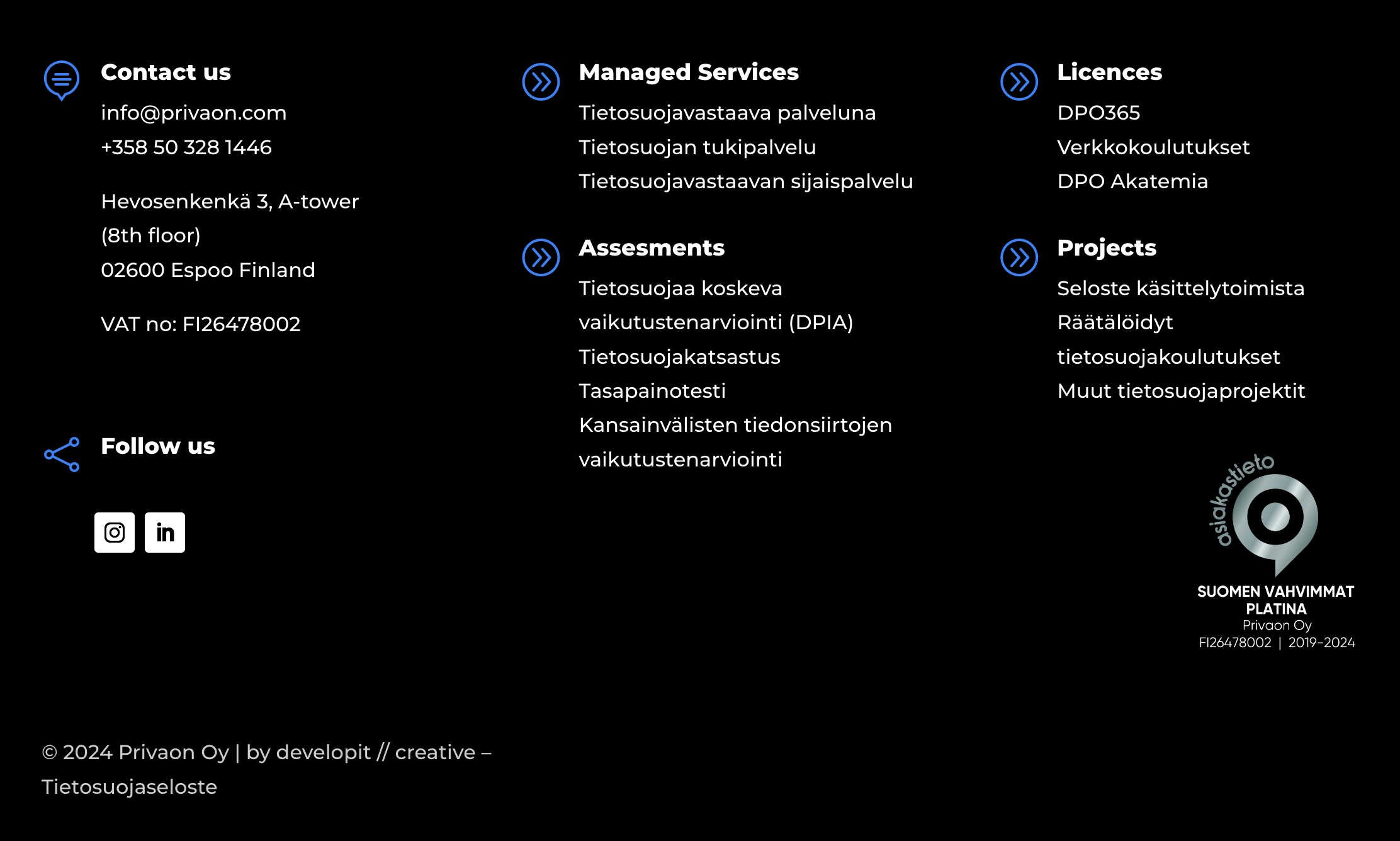

I was translating the site footer from Finnish to English, which previously worked fine. The issue can be seen at hidden link.
The footer is not fully translated into English; it contains only a few English words and links to English pages.
Why is the footer not fully translated into English despite previous successful translations?
What steps can I take to ensure the entire footer is translated correctly?
May 27, 2024 at 12:36 pm #15674170
Teemu
Hello!
This translated footer worked just fine, but I noticed today that it does not work anymore. There are only the heading texts translated, when you can see that the whole footer is 100% translated.

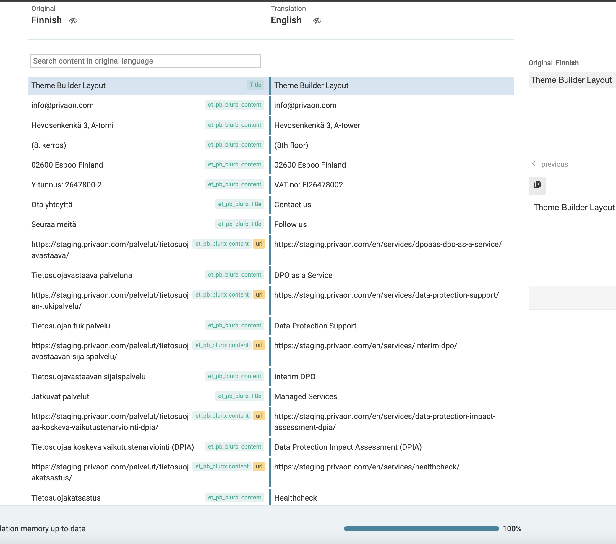

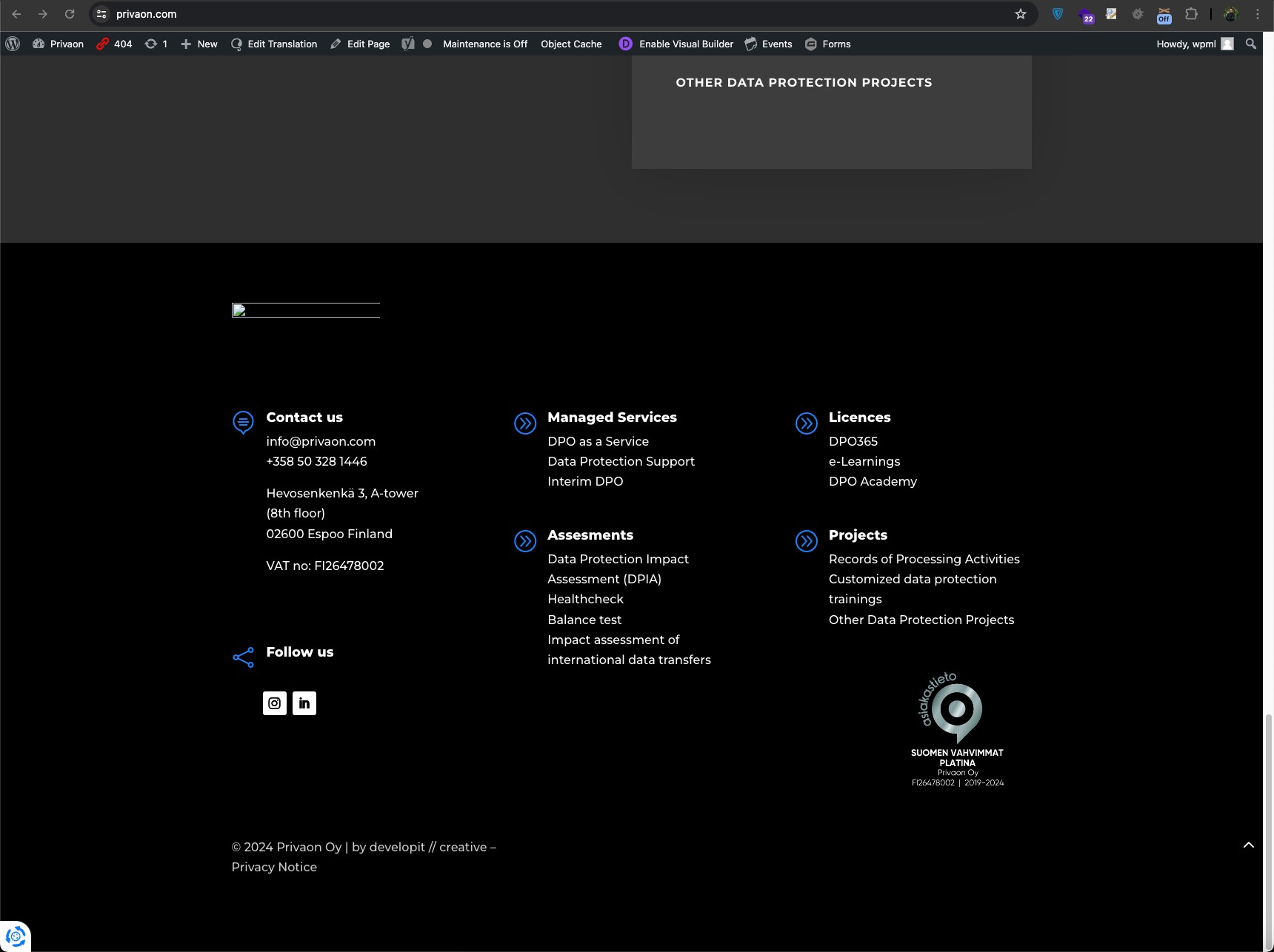

Thanks for the access details. I edited the footer in the default language, made a minor edit, and updated it. (hidden link)
After that, I updated the translation using the WPML editor. Kindly check if the footer is translated correctly. (hidden link)
Osama
May 28, 2024 at 8:12 am #15676661
Teemu
Thank you so much, it works now!
