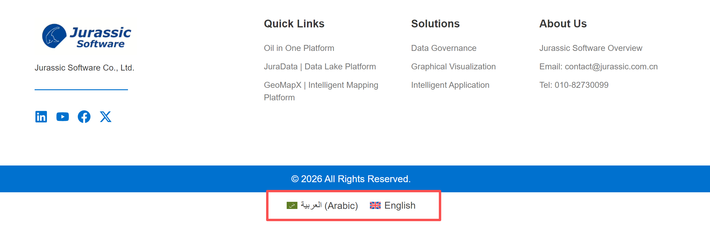

March 13, 2026 at 6:59 am #17894301
minZ-2
The site defaults to English upon entry. Switching to Arabic displays correctly, but switching back to English still leaves the page in Arabic.

minZ-2
Is the incorrect pointing of homeURL and site URL in the database the primary reason why the footer language switcher fails to function properly?
