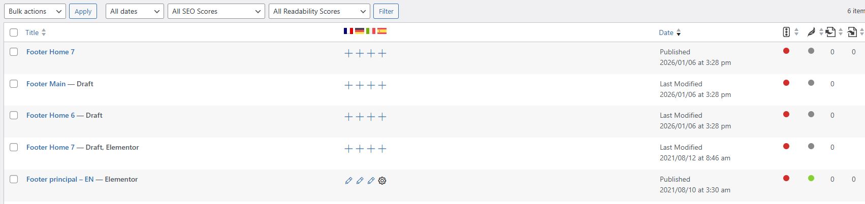

March 18, 2026 at 2:53 pm #17908576
Christopher Amirian
WPML Supporter since 07/2020
Hi Alain,
Would you please check the video below?
You would simply go to WP Dashboard > Footers, Select the Footer in question and click the + icon or gear icon or pencil icon next to it to do the translation of the text like any other page that you do in WPML.
For the media, you will need the WPML > media Translation.
Thanks,
