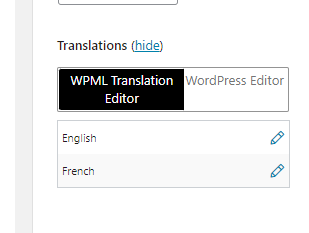

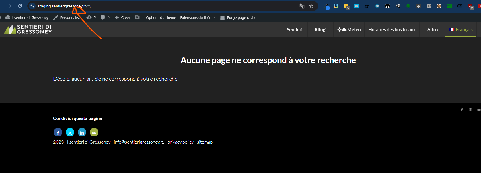

Hi. After completing the translation of my Italian website in English, I've started the French translation. I have an issue with the homepage already: when I switch to French, I have an error message "Page not found" (see FRENCH error screenshot). The translation is completed, as you can see in the TRANSLATION IS OK screenshot.
I can safely send you information about how to connect to the staging environment where you can do whatever you want.
I've tried deleting the French page and re-creating it: same result.

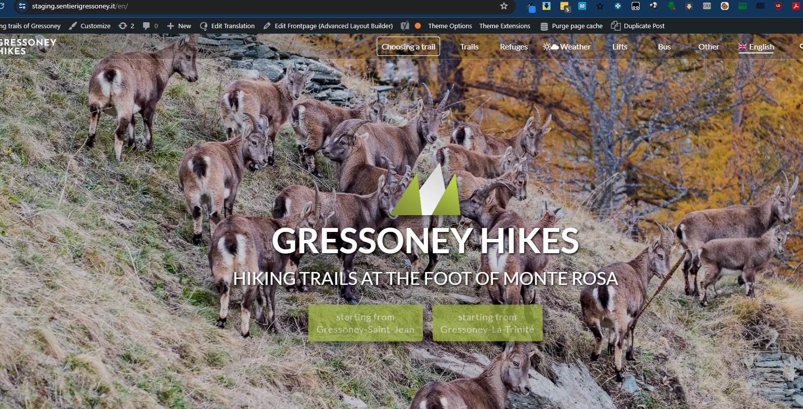

I've also attached a copy of the Italian and English homepage, that are working as expected.

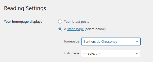

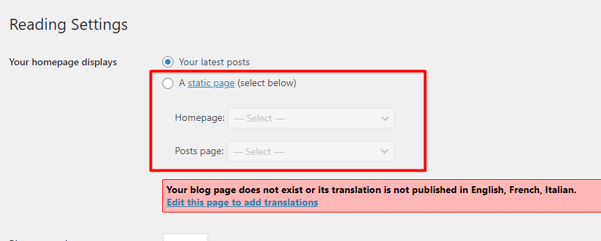

The homepage was set to display the latest posts in your WordPress settings, I changed it to show a static page and selected the Italian homepage then the issue was resolved. Please see here: hidden link
Please try the following steps on the production site and let me know if that helps:
1. Go to Dashboard > Settings > Reading > "Your homepage displays" section
2. Set it to the Static page option
3. Select the Italian page and save the changes
Kind regards,
Mohamed
