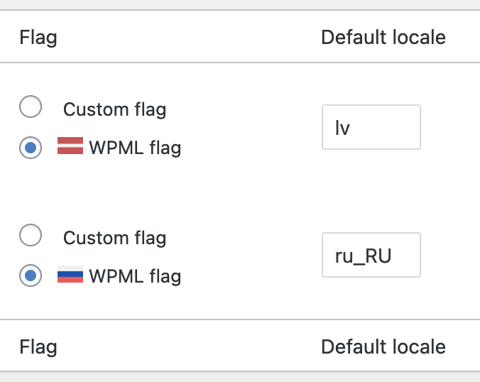

By playing with various settings I have found the culprit of the underlying problem myself.
The reason why Latvian language was not used in the first place, was because of a mismatch in the locale code formats used by WordPress, WooCommerce and WPML. WordPress and WooCommerce identify Latvian simply as "lv" (ISO-639 language code), WPML however as "lv_LV" (ISO 639, AND a ISO-3166 country code).
So by simply changing the default locale value for Latvian language to "lv" under the WPML Edit Languages settings does fix the issue. And the Woocommerce relies on the _lv.po file again and the front-end is displayed in Latvian.
