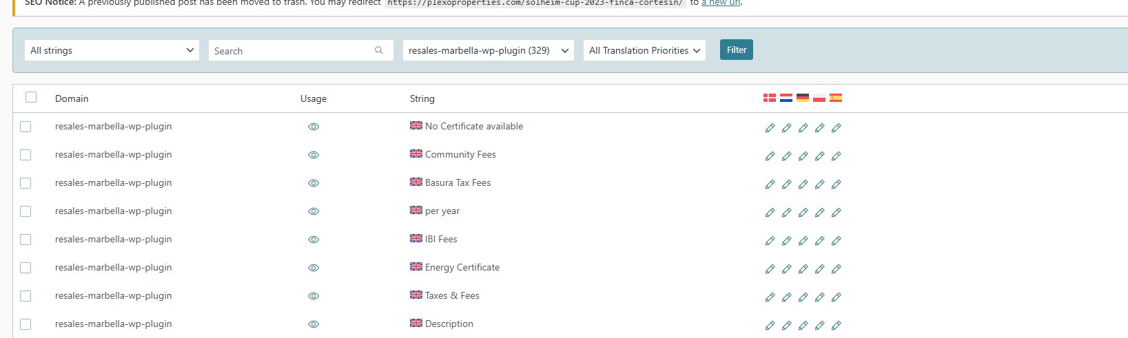

All is done in the string translation of wpml.

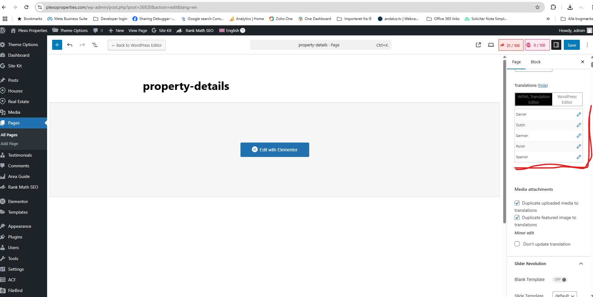

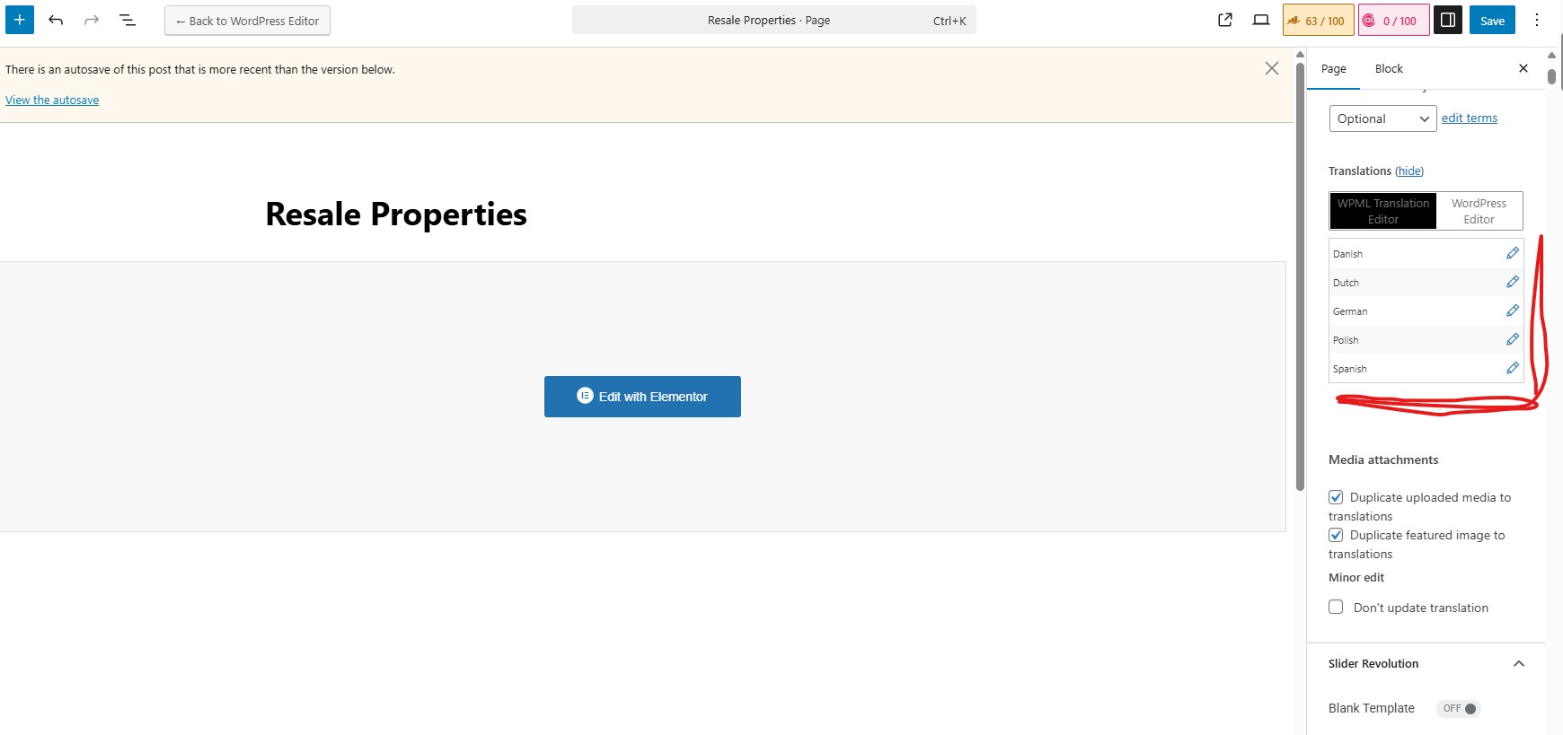

The issue is also that when you are on this page : hidden link
The shortcode is only the one that maks the property filter and the images of the properties. The tekst below that is in Danish and that is as expected - so the page is in danish or some other langauge - the master is always the english version
The problem is that selecting an property makes it change to property details and this works fine on the english version hidden link
But If I was on the danish version or one of the other langauge and selected an image it change to english on the detailed page even that the page is translated to the right langauge.
When I then manually add the da/de/nl/pl just after the domain name it shows the right page - it is like wpml dont see the right page and the just take the default

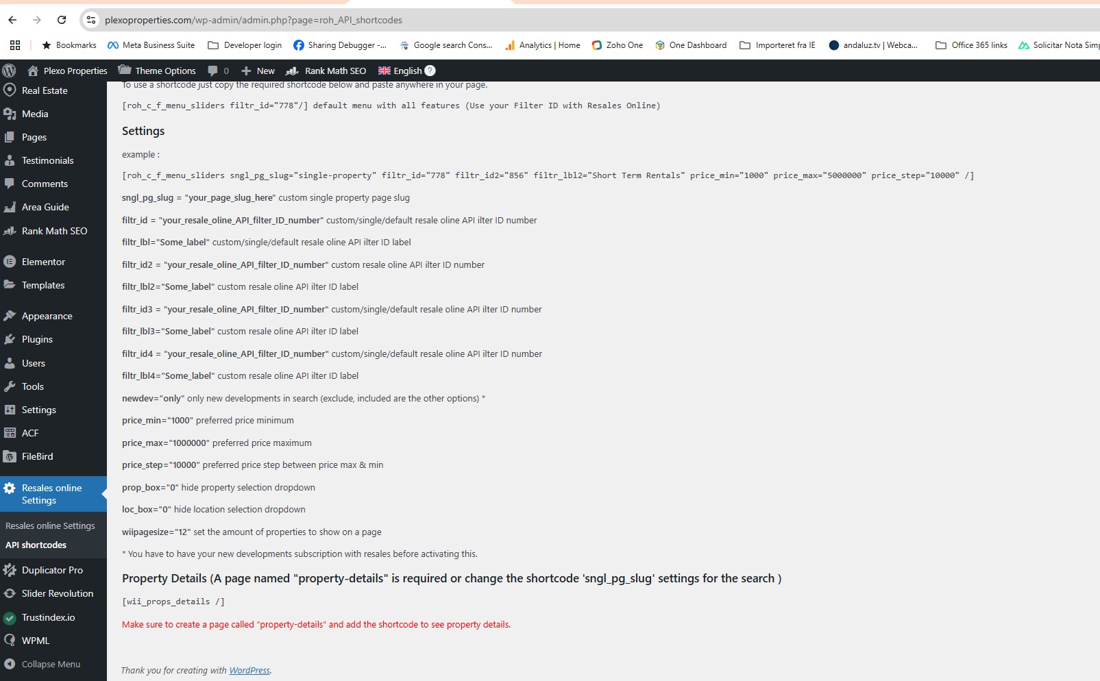

Please login and go to this hidden link
There you have the explanation but I think the page you must read is the shortcode page.

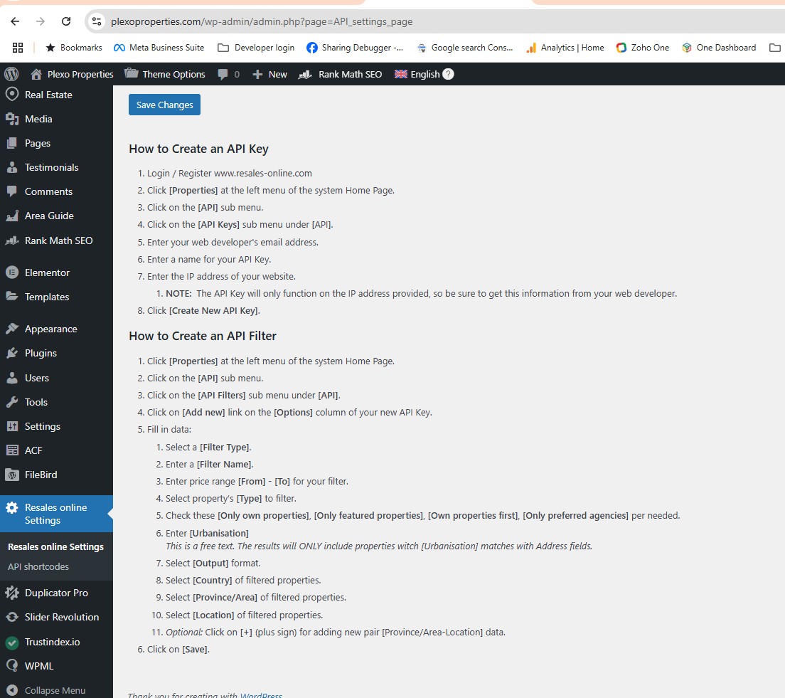

In the meantime, I checked the shortcode in the API settings here: hidden link and I could not find any option to filter the properties by language. Could you check with the developers to confirm whether this is possible?
I also reviewed the string translations at hidden link , but I did not see any way to translate the listings generated from your Resales-Online server.
