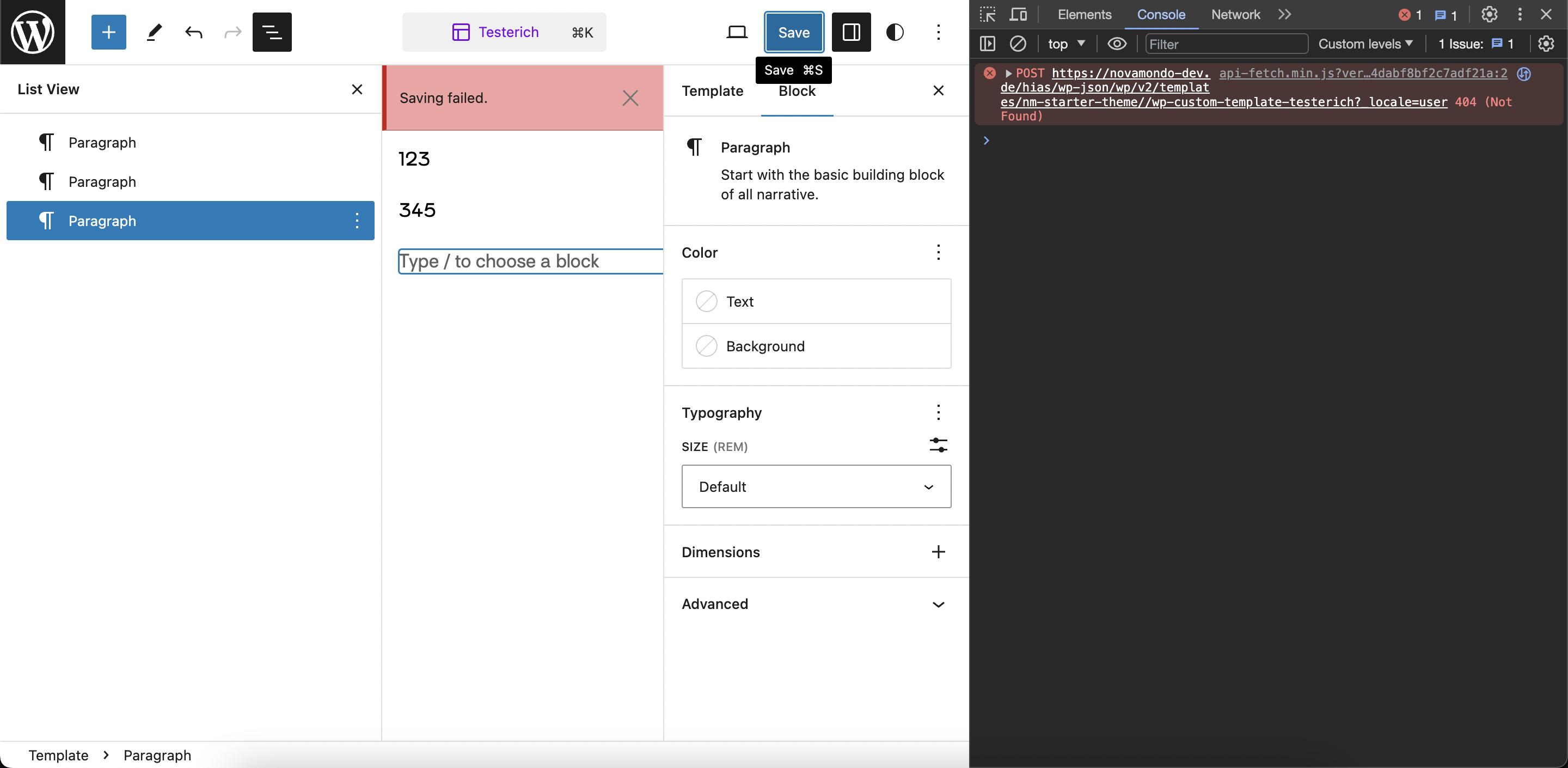

bastianv-2
I am trying to: Create a new template / change template content for English (second language, first is German).
Link to a page where the issue can be seen: See attached screenshot
I expected to see: Successfully saving the template
Instead, I got: "Saving failed." on page save.
This issue occurs only when WPML is active. If deactivated, there is no issue.
However, this error only occurs if you select "English" in the WP admin menu and then go into the site editor. Neither creating a new nor changing existing templates is working here. The error is always "Saving failed." If language is German and we try the same, it works just fine.

Hi there
Your default language is DE, correct? And you can edit and update templates in German without any problems, but trying to edit/update templates in English is not working, yes?
Your intention is not to use the translation editors to translate the template from DE to EN, and instead to use the normal WordPress editor, switch between languages, yes?
The templates are a feature of your theme? It looks like you are using a custom theme.
Would it be possible to get a copy of the theme (you can zip up the theme files and share a link to dropbox, wetransfer or similar here, the links are automatically hidden).
What kind of template were you editing when having this problem? (Or does it not matter?)

Hi there and thank you for your quick reply!
"Your default language is DE, correct? And you can edit and update templates in German without any problems, but trying to edit/update templates in English is not working, yes?"
That's correct.
"Your intention is not to use the translation editors to translate the template from DE to EN, and instead to use the normal WordPress editor, switch between languages, yes?"
Also correct, we manually translate each page via WP editor.
"The templates are a feature of your theme? It looks like you are using a custom theme.
Would it be possible to get a copy of the theme (you can zip up the theme files and share a link to dropbox, wetransfer or similar here, the links are automatically hidden)."
Yes, we are using a custom theme. However, when switching to a standard WP theme, the error still persists. In this regard I don't think it is necessary to share the theme.
"What kind of template were you editing when having this problem? (Or does it not matter?)"
Our goal is to have a "standard" template for english pages. At the moment, we can not create a template in the site editor which is then available to select when editing an english page. From our understanding, the only way to have that template available when editing an english page is by creating it in the site editor after selecting english in the admin menu.

Understood.
I tested on my local test site with twentytwentythree theme and can reproduce the problem.
I searched and found an internal ticket about this, we have had two reports of some variation of this in the past. I'm adding this thread to that ticket, which should help bump the priority.
Note that this only occurs when WordPress is installed in a sub-directory (which is the case on my local site and appears to be with your site).
Unfortunately I don't have a workaround for you.
Do note, though, that you can translate the template (as described in our documentation here: https://wpml.org/documentation/getting-started-guide/translating-content-created-using-gutenberg-editor/translating-sites-that-use-full-site-editing/).
But if you want a different layout on different languages (rather than just translating texts that appear in the template) that's currently not possible.
I'll let you know when there are any updates from the developers relating to this.
