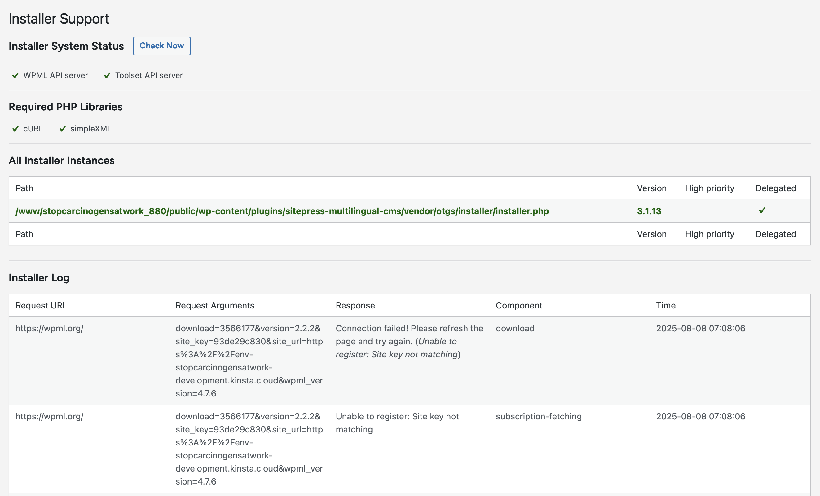

Jasper
Thanks. But for that I need to update but I have a communications problem, for which I need to contact uhm... you. See screenshot attached.
August 8, 2025 at 7:26 am #17304477
Alejandro
WPML Supporter since 02/2018
Whenever you migrate you'll need to change the sitekey. Maybe you have the sitekey fom another domain registered at the moment and that can be fixed by going to plugins > Add New > Commercial and then remove the sitekey and add it again.
In 4.8 the sitekey will be removed automatically when you migrate using that version to make it more on the nose, by the way :).
Anyways, if you can check it out in 4.7.6 and see it works, then you can leave it like that and use that version even know since it's already stable. 4.8 is still a beta (a stable one) so it's a but risky to use that on a live site, but it does work a bit better with the glossary feature.
