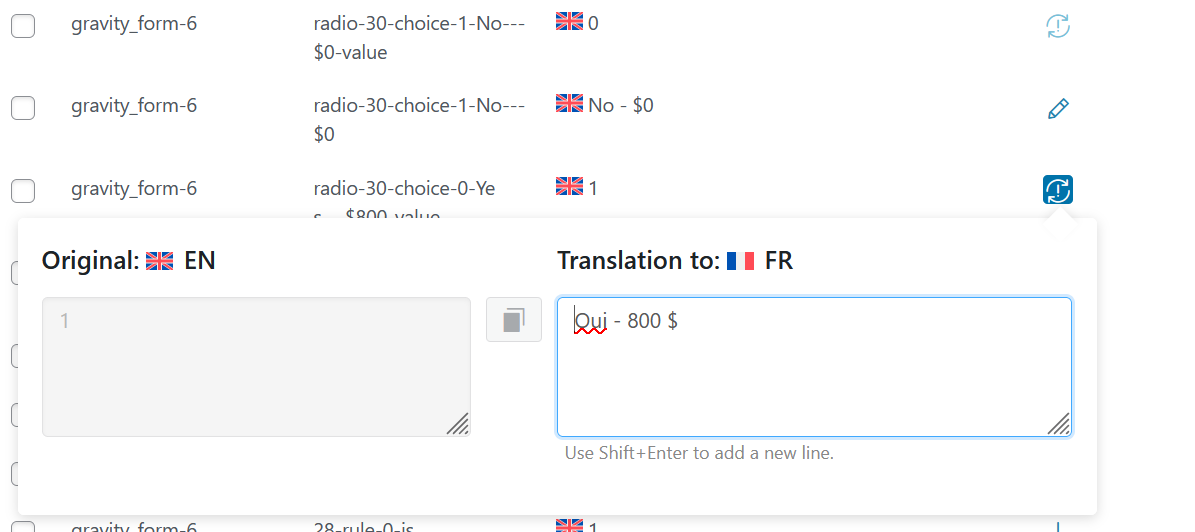

Our second-tier supporter has provided a workaround for this issue. Please proceed with the following.
1. Go to WPML -> Strings Translation.
2. Select the domain gravity_from-6.
3. Find the strings with 0 and 1 under the name radio-30-choice-1-No---$0 and radio-30-choice-0-Yes---$800-value and change the translation of 1 and 0 to the same strings.
Please see the attached screenshot.
