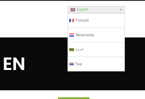

I have a rather simple question but can’t find the answer. I use shortcode [wpml_language_selector_widget] to place language switcher and trying to stylize it in the Language switcher options, Additional CSS. My problem is the languages in the drop-down list are too close to each-other. I need to increase the space between them and padding doesn’t help:
.wpml-ls {
font-size: 14px;
padding: 15px;

Thank you for contacting WPML Support. I’ve tried to visit your site but it seems your site is coming soon mode that’s why I can’t see the language switcher.
I just added the WPML language switcher with the [wpml_language_selector_widget] shortcode on my test site and I’m able to add the space between items by using the below CSS:
.wpml-ls-statics-shortcode_actions .wpml-ls-sub-menu a {
    padding: 20px 5px;
In the custom CSS section of the theme and now it looks as in the attached screenshot. Could you please try to use the above CSS and see if this resolves your issue.
Here is my test site link: hidden link
Here is a doc for more details: https://wpml.org/documentation/getting-started-guide/language-setup/language-switcher-options/how-to-fix-styling-and-css-issues-for-the-language-switchers/
If the issue still persists, could you please try to disable the coming soon mode for a moment so that I can access to your site and provide you with correct CSS according to your site.
Thank you

Hello, thank you for the code. It helped to increase the space between languages, but I also need to increase the padding top and bottom of the first item so it would look the same size as the sub-menu items. Also some padding to the left. I have enabled the site.

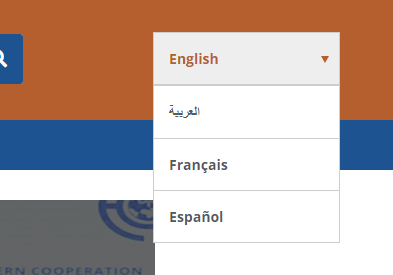

Thanks for enabling the site. Can you please replace my previous CSS with this one:
.wpml-ls-statics-shortcode_actions a {
    padding-top: 18px !important;
    padding-bottom: 18px !important;
    padding-left: 15px !important;
And it will look as in the attached screenshot. You may update the CSS values 18px/15px to any number according to your needs.
Please let me know if this resolves your issue or if you need further assistance with this issue.
Thank you
