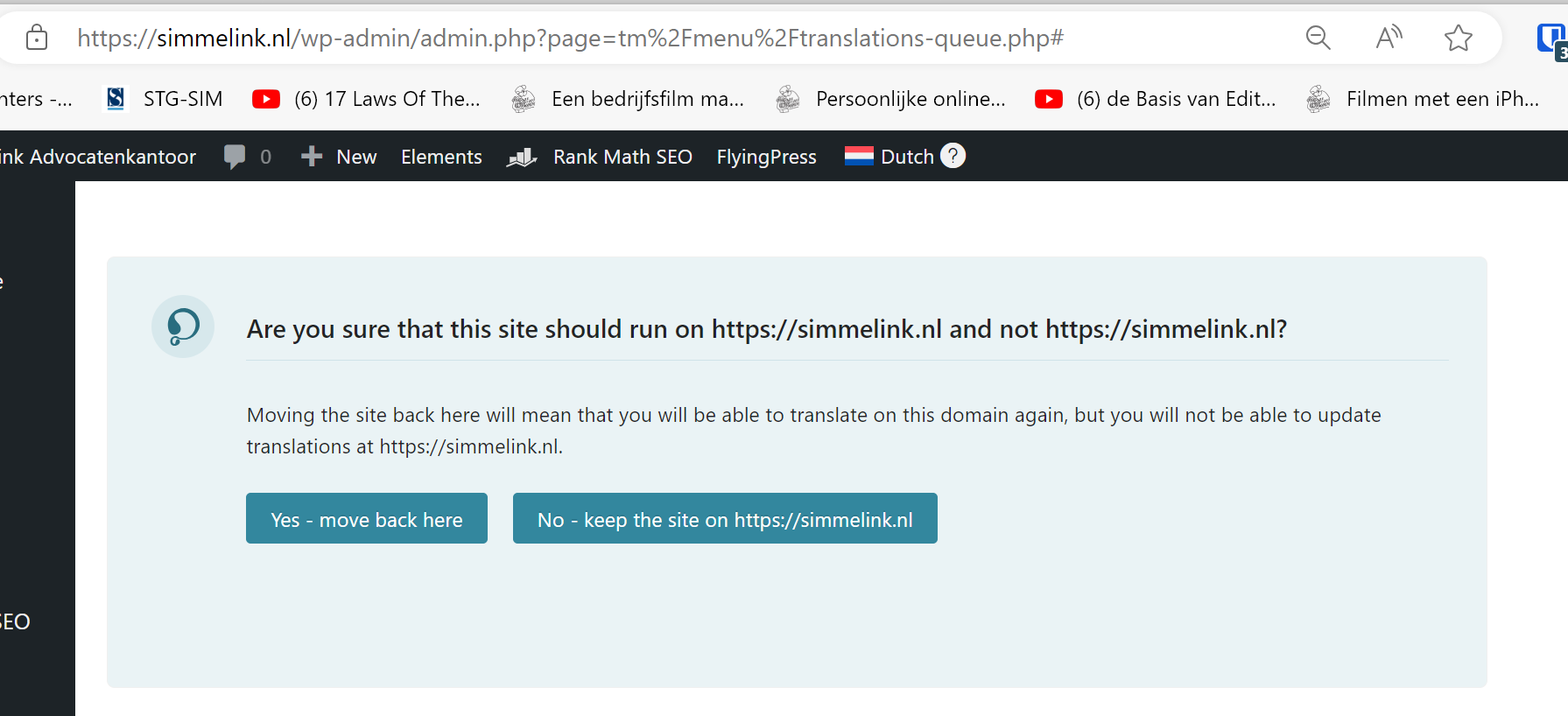

I'm using a development/staging site (hidden link) for all the work. When I'm finished with the changes I push this staging environment to Live (hidden link).
But now with WPML, how can I do this?
On the development site I get the message as I have inlcluded the attached screenshot.
What is the best way that I work on the staging environment and push to the Live environment?
Thanks.

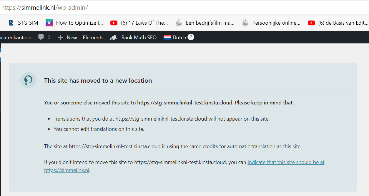

This morning I pushed my site from Development to Live. I'm hosting my site at Kinsta.com and I'm sure the migration went successfully.
When I logon on production, I get the following message, see attachment.
How can I solve this?
October 9, 2023 at 9:57 am #14537983
WPML Supporter since 08/2022
Thanks for contacting WPML support. This is a known issue and we have an errata for this. Check out this link https://wpml.org/errata/persistent-warning-this-site-has-moved-to-a-new-location/ and try the workaround provided and let us know how it goes.

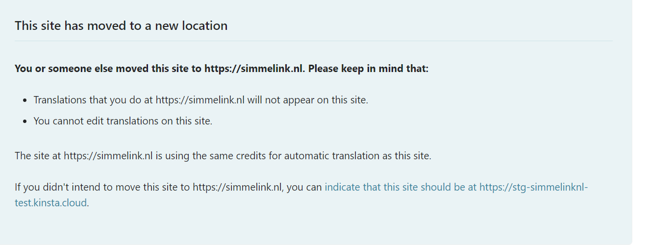

I applied your suggested changes to the PHP-config.
A few minutes ago I did a migration from the Test-enviroment to Live.
After I logged on into production hidden link I get the message, as shown in the attachment of this message.
What does it exactly mean? And are the translations, that I did on the Test-environment successfully published to the Live-site? Can I always do the translations on Test?
October 9, 2023 at 4:31 pm #14541667
Thanks for your reply.
Ok, please click on the link "indicate that this site..." and it should allow you to use the Translation Management on your production site.
