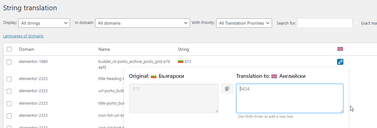

The client was unable to translate a few words on a page, even after using WPML's Advanced Translation Editor. The untranslated strings were part of templates created with the Porto Templates Builder and custom Elementor/Porto Modules.
We recommended the client to register the custom Elementor widgets for translation using the WPML Compatibility Test Tools plugin, as per the documentation: https://wpml.org/documentation/related-projects/wpml-compatibility-test-tools-plugin/registering-custom-elementor-widgets-for-translation/.
Additionally, we provided a custom XML configuration to be added in WPML settings to ensure the strings from the custom modules are available for translation:
<wpml-config>
<elementor-widgets>
<widget name="porto_archive_posts_grid">
<fields>
<field type="ID of the template">builder_id</field>
</fields>
</widget>
</elementor-widgets>
</wpml-config>
The client was instructed to:
1) Go to WPML>>Settings>>Custom XML Configuration.
2) Add the provided WPML language configuration and save it.
3) Update the specified template to refresh the translation settings.
4) Update the translation.
5) Translate the *porto_archive_posts* id from WPML>>String Translation.
If the solution provided is not relevant due to being outdated or not applicable to your case, we highly recommend checking the related known issues at https://wpml.org/known-issues/, verifying the version of the permanent fix, and confirming that you have installed the latest versions of themes and plugins. If you still need assistance, please open a new support ticket: Contact WPML Support.

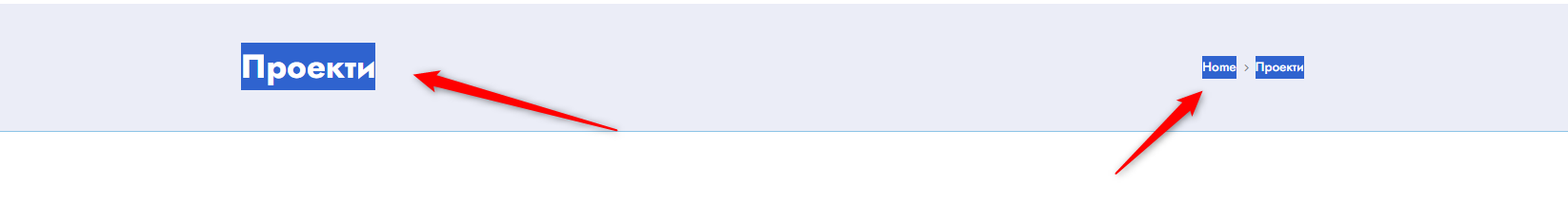

I was able to translate the page except for a few words. See the screenshot.

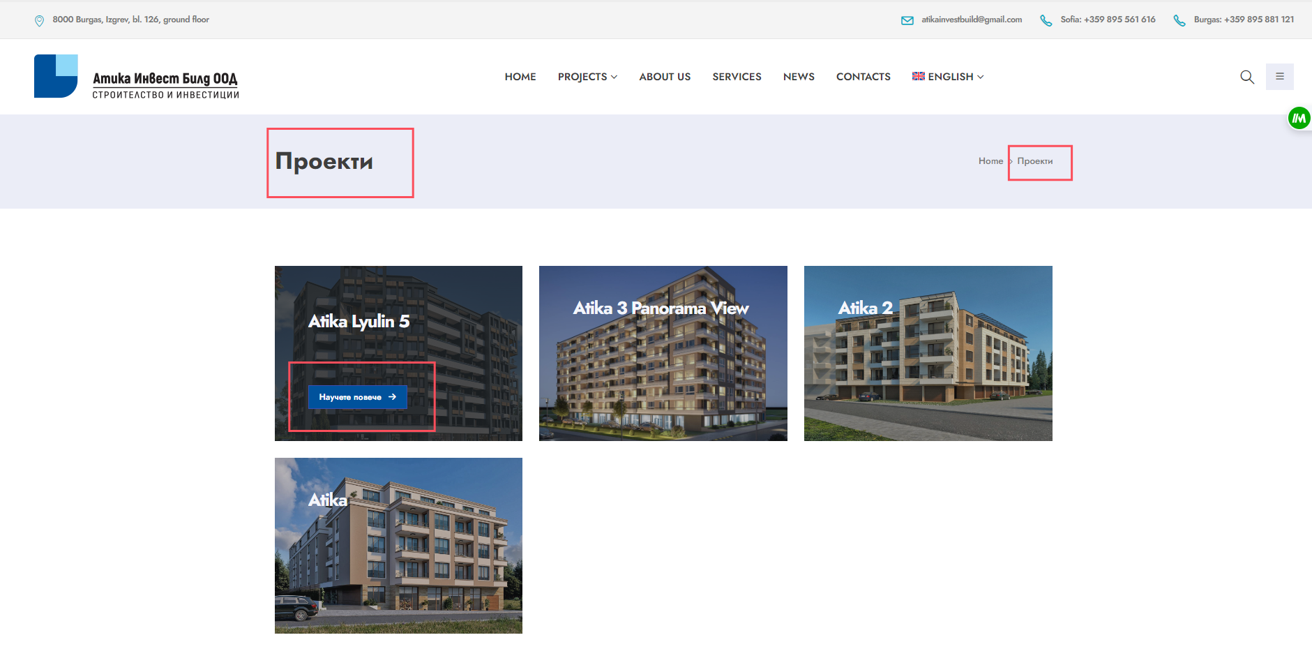

The strings you have mentioned are added by the following templates created using the Porto Templates Builder.
Because of custom Elementor/Proto Modules, those words are not listed for translation in WPML Advanced Translation Editor. Additionally, the Header template is missing the Heading and Bread Crumb settings. So please let us know how you've set it up.
You may have to try the workaround suggested here due to custom Elementor Modules - https://wpml.org/documentation/related-projects/wpml-compatibility-test-tools-plugin/registering-custom-elementor-widgets-for-translation/

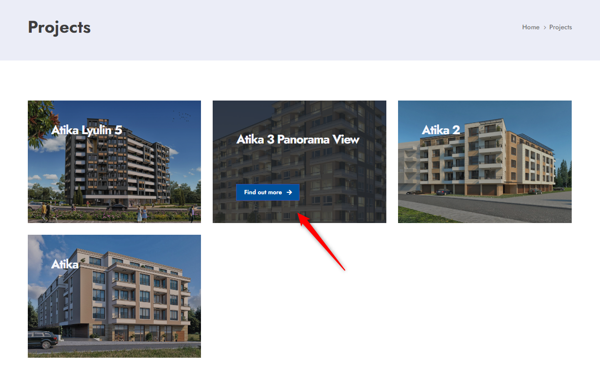

April 5, 2024 at 5:06 pm #15489192
Bigul
WPML Supporter since 01/2013
The Project Post's button link shows the translated text after updating this template hidden link
Please check the URL and attached image for more details and let us know your feedback.
Our compatibility team is still debugging this issue because it looks like a conflict with *porto_archive_posts_grid*.
Thanks!
Bigul

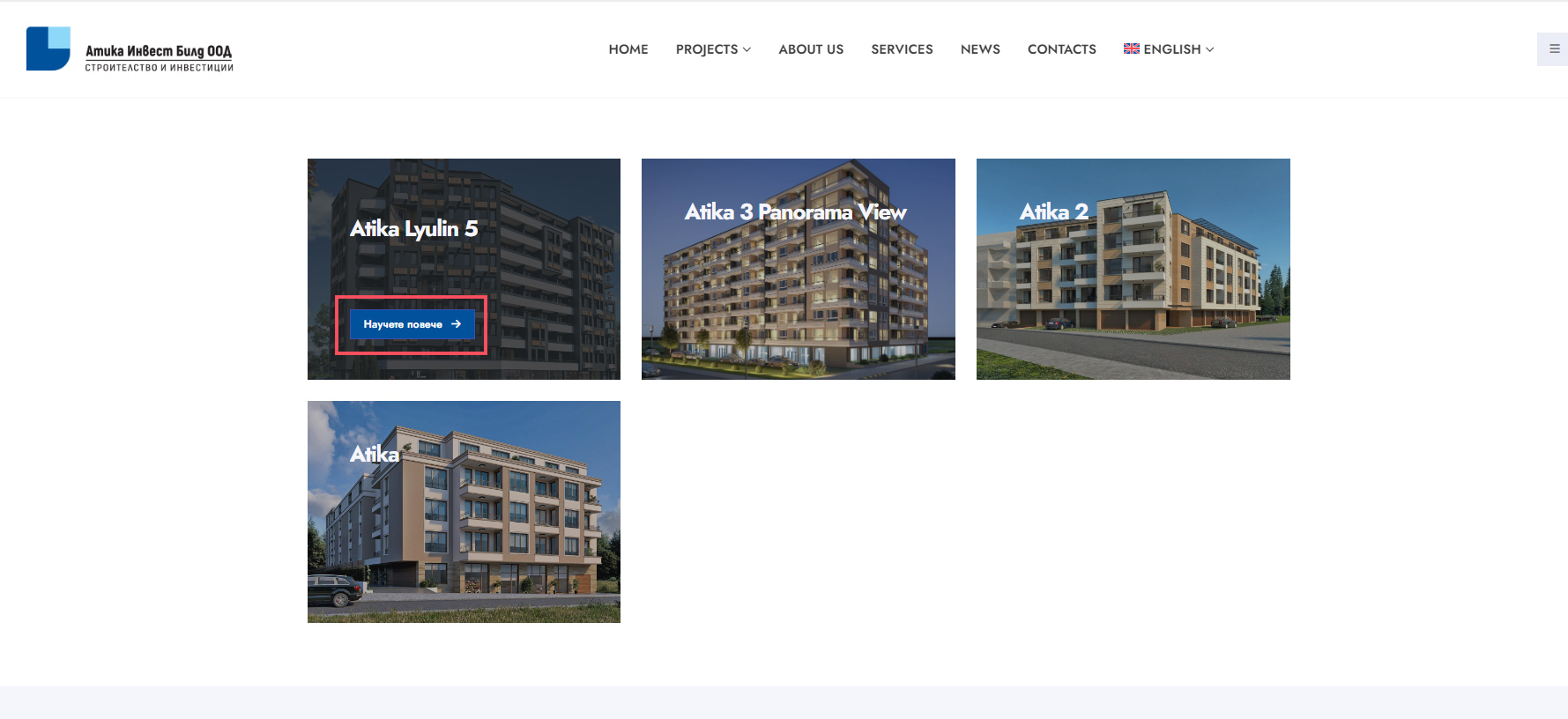

kaloyanB
In my version of the site, the project page is damaged.
How is it in your copy?
I still can't get this button to translate.

April 8, 2024 at 9:09 am #15493222
Bigul
Hi Kaloyan,
Thank you for the updates. It is working fine in our local copies and also the translation was showing as expected in your site on Friday. Please check the following screenshot.
Have you made any changes on the site after Friday?
Thanks!

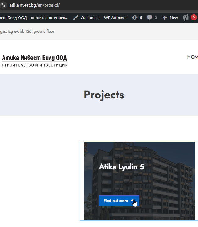

I fixed the page, but this button is not translated again. How do I translate it? How did you translate it?
April 9, 2024 at 10:24 am #15498284
Bigul

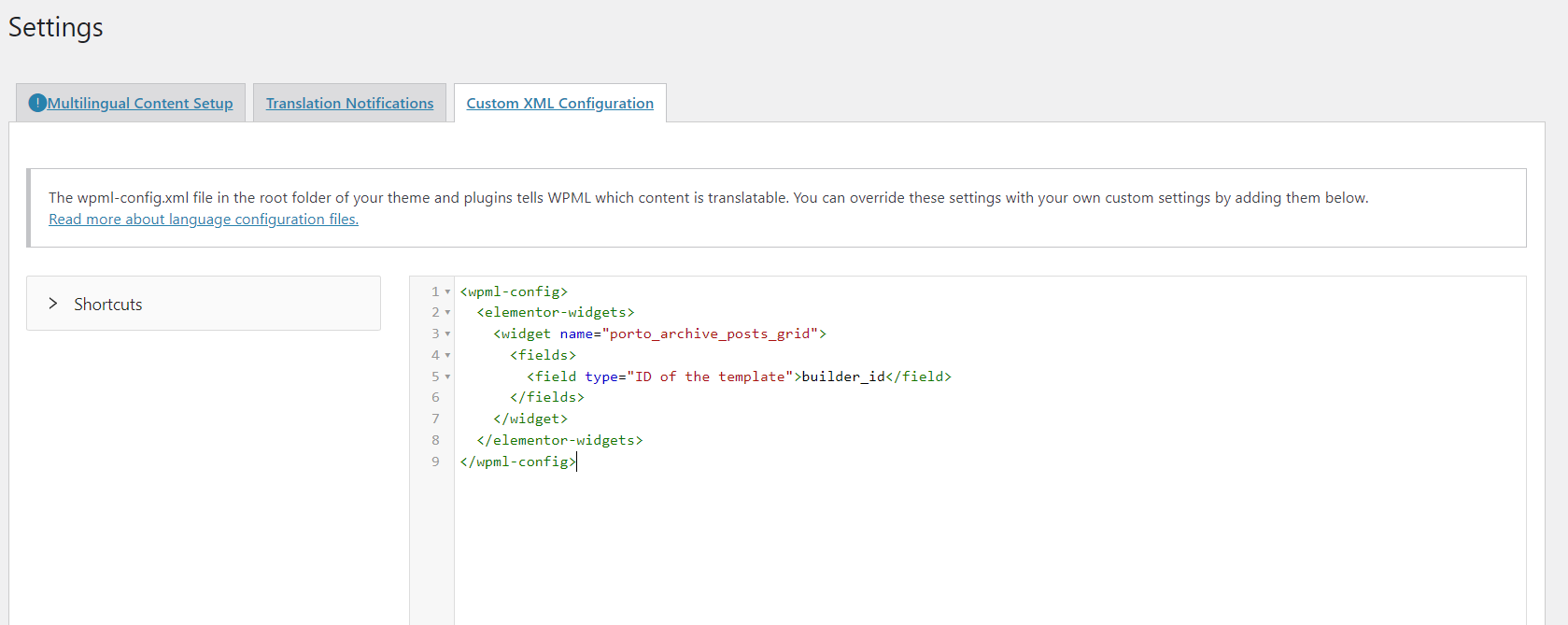

Hi Kaloyan,
Please check it now. The English Project Page button is showing the expected results after the following steps.
1) Visit WPML>>Settings>>Custom XML Configuration
2) Add the following WPML language configuration and save it
<wpml-config>
<elementor-widgets>
<fields>
</fields>
</widget>
</wpml-config>
3) Update the following template to refresh the translation settings
Thanks!
