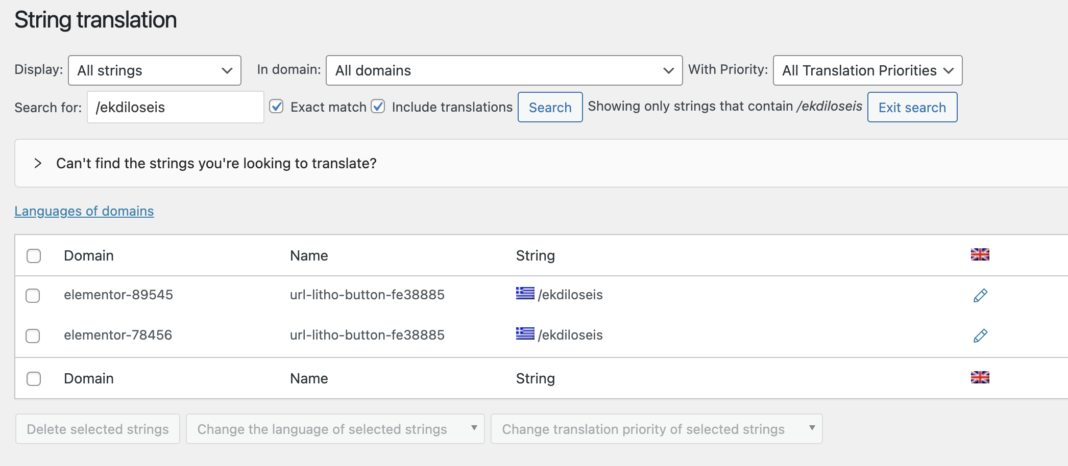

Thank you for the access details!
I was able to locate 2 strings with /ekdiloseis here:

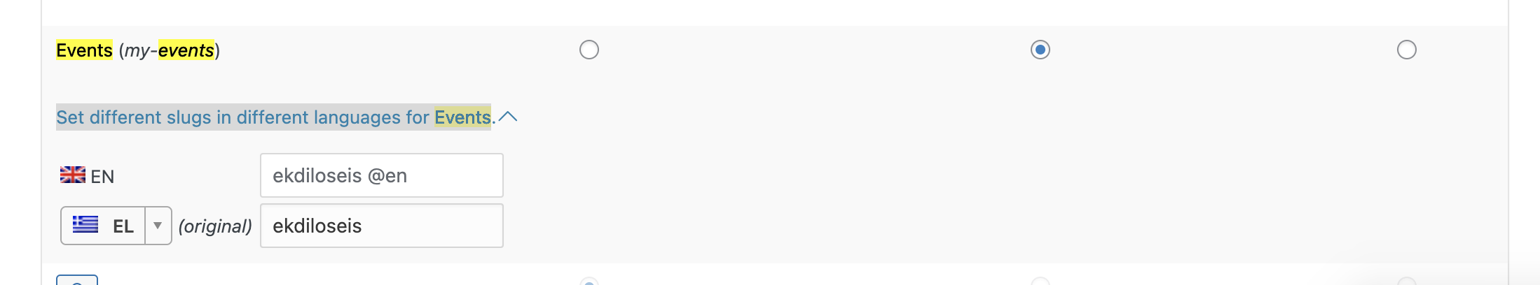

However, I'd recommend translating the slug by going to
WPML-> Settings -> Post Types Translation -> Events (my-events) -> Set different slugs in different languages for Events
