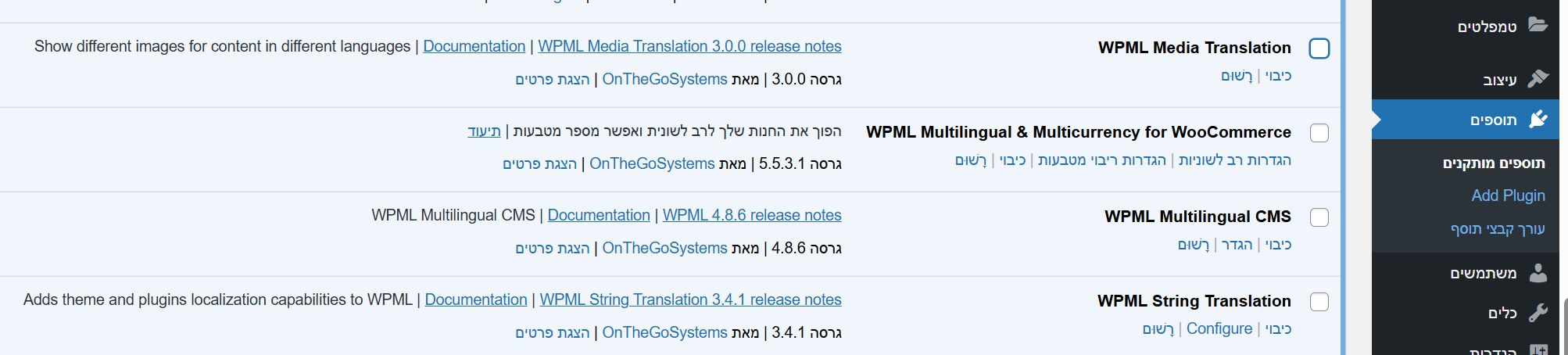

I use a plugin called Robo Gallery which shows the media title below in polaroid mode.
See an example (I have 71 posts and hundreds of pictures) - hidden link
However as you can see the polaroid captions still show the original language (Hebrew).
I ran a full site translation;

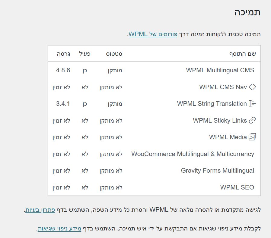

I downloaded and installed the media plugin, you can see the plugin page (see attached); However it says uninstalled in the support page (see attached).
I did translate one picture to test (see attached) but it still doesn't show the translation.
Thanks in advance for any help available.

Regarding WPML Media showing as Not installed in WPML -> Support. This is a known cosmetic issue that will be fixed in a future version of WPML.
Itamar.

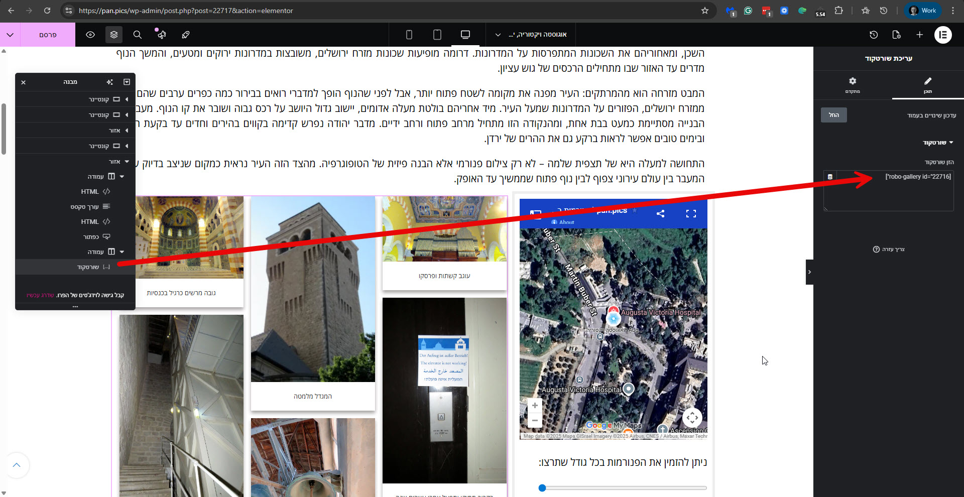

I edited the page you provided as an example of the problem with Elementor, and I could see you are using a shortcode to display the Robo Gallery. Please see the attached screenshot robo-gallery-short.jpg. From that, I learned that you have the post type robo_gallery_table, which is used to create galleries. You need to create a translation for the Hebrew gallery so it shows its English version. The robo_gallery_table post type is not set to be translated. You need to go to PWML -> Settings -> Post Types Translation, and put it to:ניתן לתרגום (הצג רק פריטים מתורגמים). Please see the attached screenshot trans-robo.png. Then you will be able to translate the galleries in RoboGalleries -> Manage Galleries. Later, since you are adding the gallery with a shortcode, you will need to translate the shortcode ID when you translate the page where you added the gallery. Please see the attached screenshot gallery-id.jpg.
If you are not sure how to proceed, I can make those changes and check if it is working. Please let me know.

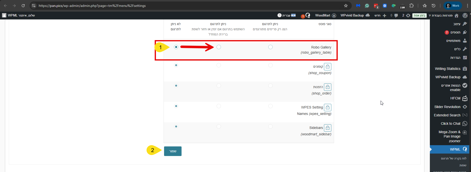

December 10, 2025 at 10:51 pm #17653960
motiP
Thanks Itamar, I followed your instructions, and I see in the robo gallery management that the list has doubled and now there is an English gallery for each.

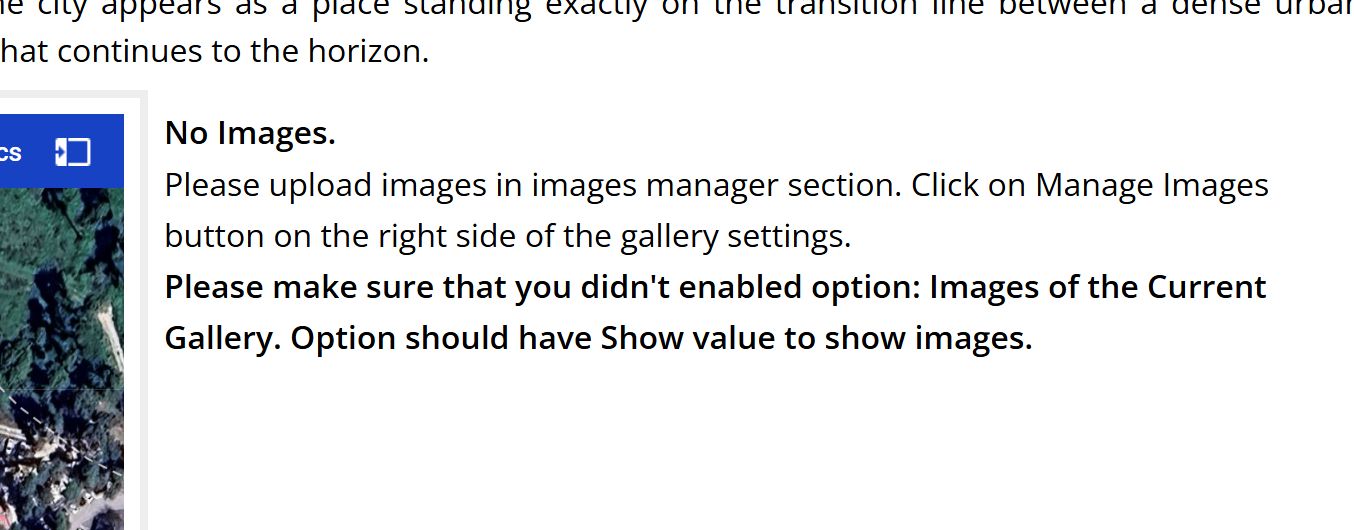

I changed the shortcode and this is the result:
Apparently, all the Robo Galleries are copied and their title is translated, but their content is not - not the images nor the settings (i.e. polaroid etc.).
I tried to re-translate the page, but I still got the same result. There goes 3,804 credits :/

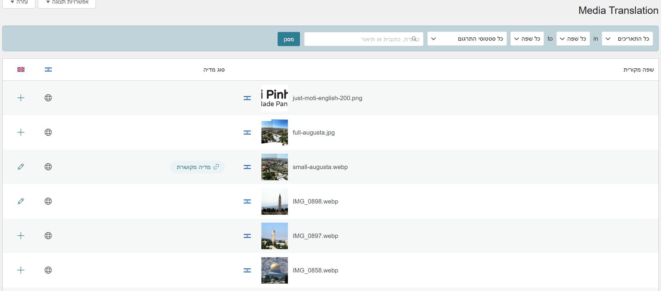

Furthermore, checking the media translation page I've notice that none of the media titles didn't translate automatically.

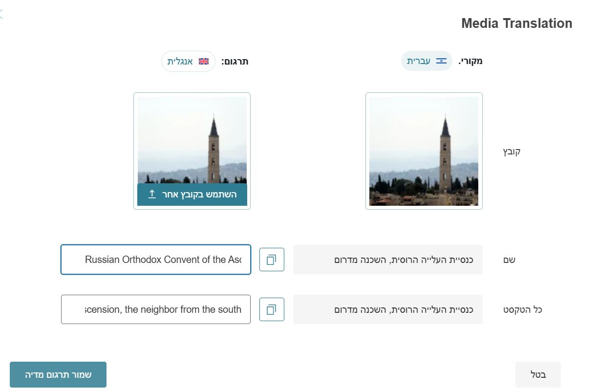

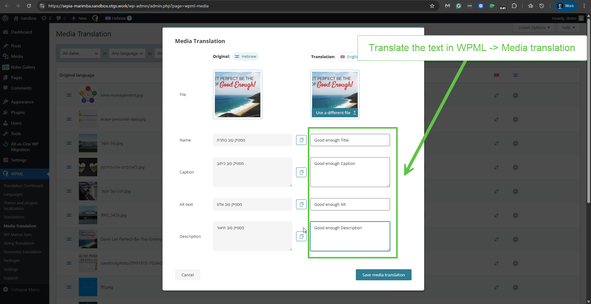

Thanks for installing the Robo Gallery on the sandbox site. It seems that this plugin has compatibility problems with WPML. However, I have found that if you create a separate gallery in English, it can work, and you can display the images with English titles. The process in this case would be less automatic and more manual. Here is what you can do.
1. Translate the images' text in WPML -> Media translation.
2. Go to Robo Gallery -> Manage Galleries, and switch to English using the admin Language Switcher at the top admin bar.
3. Create a standalone English gallery. (A gallery which is not a translation of a Hebrew gallery.)
4. Insert the translated English images in this gallery. (When you upload images to this gallery, you will get the media library in English.)
5. Publish this gallery and copy its shortcode.
6. Insert the English gallery shortcode in the translated English page and update.

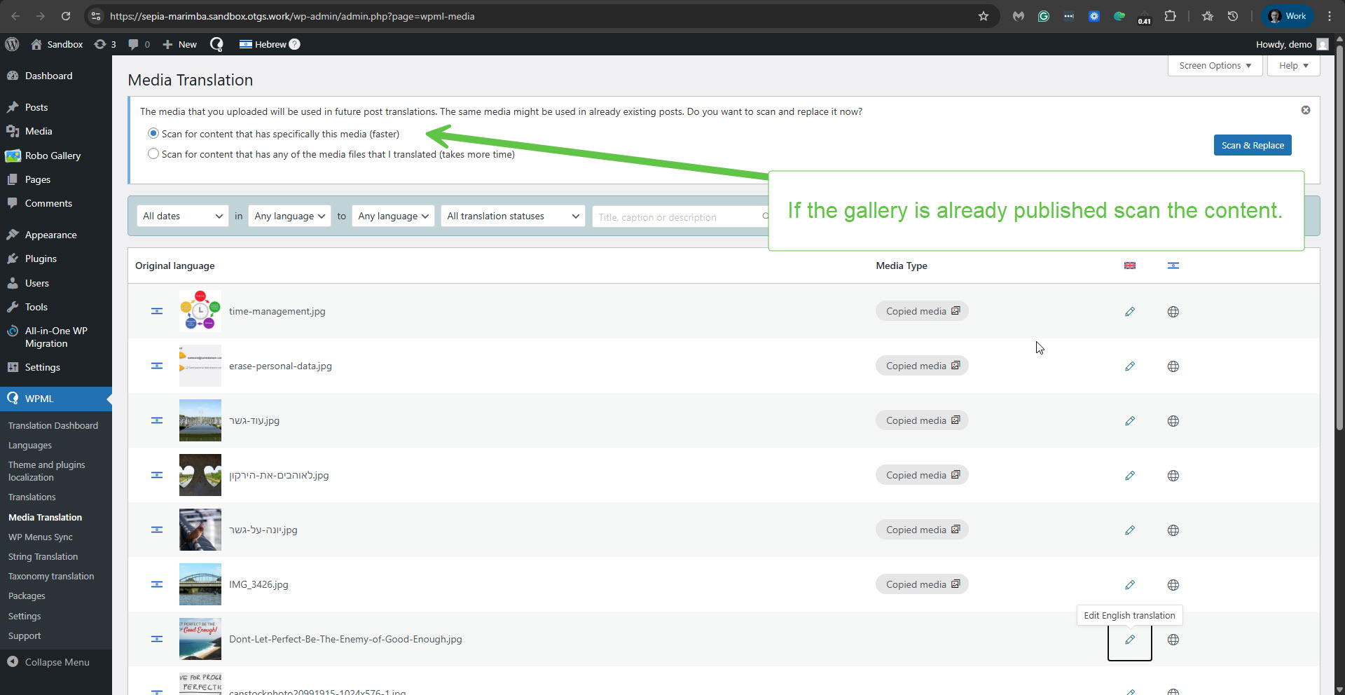

I have a reply from our compatibility team.
Our compatibility developer says that, unfortunately, there is no way to retrieve the image text from a gallery included in the Advanced Translation Editor. This means it can't be translated automatically. Our developer further explains that the post type robo_gallery_tablegallery doesn't need to be set to translatable. This is because it is inserted into a post with a shortcode (gallery ID 49, for example, will be used in HE and EN. Fortunately, the gallery stores the image IDs in a custom field rsg_galleryImages. So we can automatically translate the image ID, but the caption and title will still require manual translation in Media translation. Here are the steps to follow.
1. Go to WPML -> Settings -> Custom XML Configuration (tab).
2. Insert this XML code.
<wpml-config>
  <custom-fields>
    <custom-field action="copy" type="post-ids" sub-type="attachment">rsg_galleryImages</custom-field>
  </custom-fields>
</wpml-config>
3. Click the Save button.
4. Go to WPML -> Media translation, and translate the images' text. Please see the attached screenshot trans-in-mt.jpg.
5. Scan the content to be reflected on the pages and posts. Please see the attached screenshot scan-content.jpg.
Now the images' text will show translated on the English pages.
We check this on the sandbox site, where you can see and experiment with it.
Please let me know if you have any further questions.
Itamar.

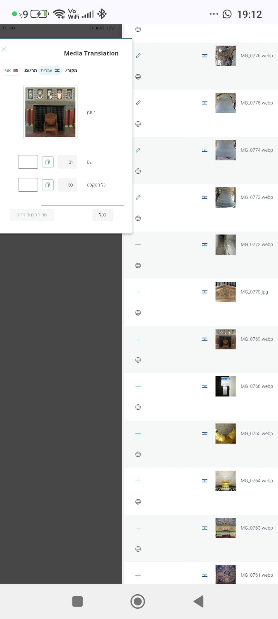

December 19, 2025 at 5:18 pm #17678753
motiP

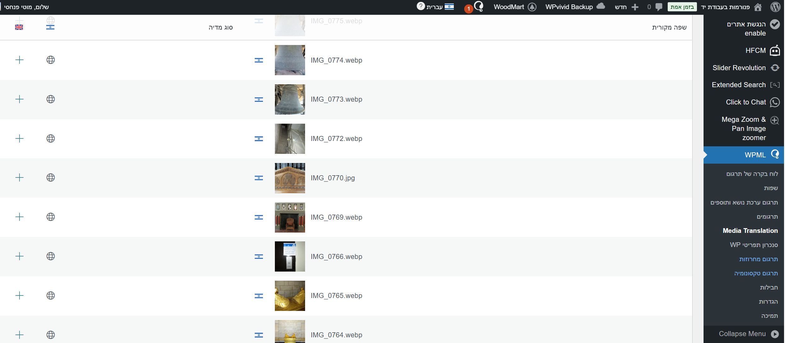

Yes, this resolves. It works even without scanning.
However it is very annoying that I need to translate manually over 1000 media files. I wouldn't mind if the media translation UI/UX was so horrible. No "next" button, not responsive so I can't do it on my phone... (see attached picture). Such a bad experience. Is there ANY way to improve this?

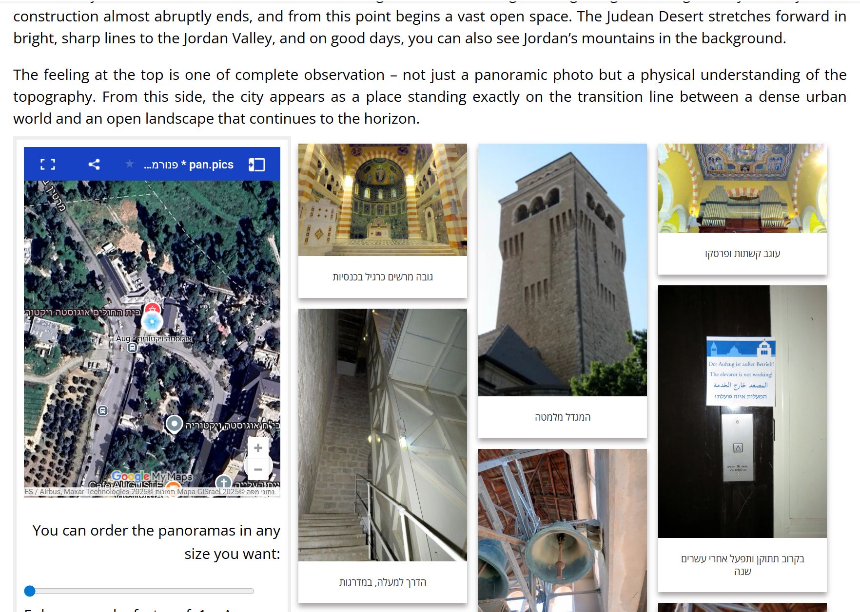

December 19, 2025 at 9:13 pm #17679188
motiP
I've answered to myself - well if this Robo Gallery is not so compatible, perhaps I'll use one of the recommendations. So I installed Justified Image Grid, which I took from WPML's site:
https://wpml.org/plugin-functionality/gallery
And... SAME RESULTS. The picture titles do not translate automatically, it does work when I add a translation manually (did for one picture), without that all the titles stay in hebrew.
See: hidden link
