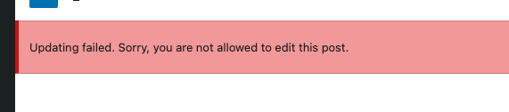

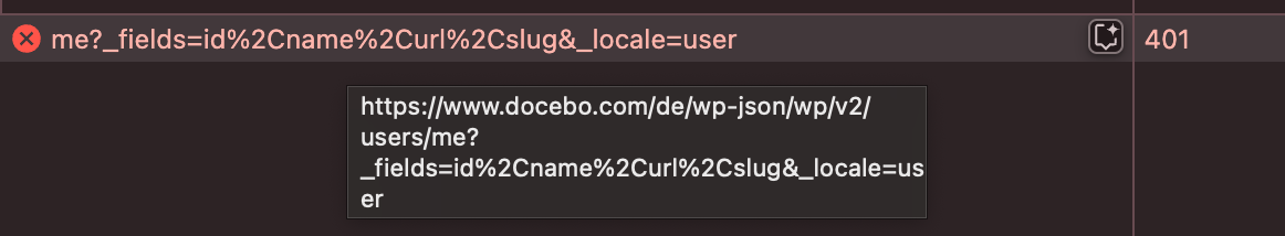

March 5, 2025 at 2:44 pm #16779529
claudioE
I just updated the plugin. The issue persists.
It seems to only occur during within the Gutenberg editor. Classic editor seems to be fine.
Attached is the message I get when I try to save a translation and this is the error in the console.

March 6, 2025 at 8:59 am #16781839
Alejandro
WPML Supporter since 01/2018
The problem here is that the REST call is done using the language directory when it shouldn't.
This is something that was fixed before, but I wanted to ask if you have any custom code that you can temporarily remove and see if the problem continues? if not, then would it be possible to switch the theme to a default one adn see if the problem continues?
if the directory is not there, then the REST call should work, that's what's currently blocking you and that's not happening on a clean site, so there must be some configuration or code altering this behavior.

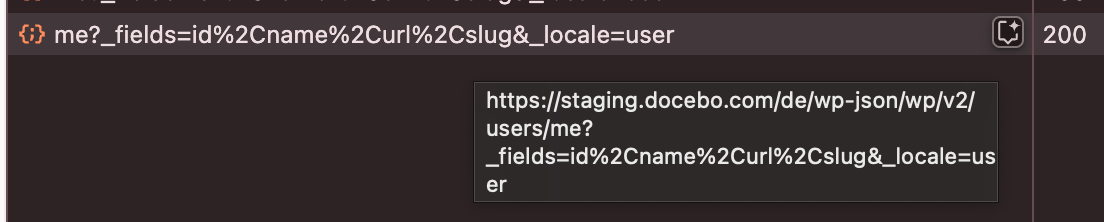

March 7, 2025 at 1:47 am #16785848
claudioE
After investigation, we think the issue is not related to the language directory.
Notes from our technical lead.
-The language URL-prefixed API calls work perfectly on staging and on our local machines (screenshot)
-The problem still occurs if I disable everything but WPML and switch to the Twenty Twenty Five base theme
-The WPML_REST_Request_Analyze class specifically appears to expect that the language slug is present in the URL
-The API routes on the development site work perfectly, and in fact they return different data based on language prefix, showing the appropriate language's pages and posts based on the specified base slug — which seems to be as intended by WPML (this is on another environment, staging.docebo.com)

March 7, 2025 at 5:38 pm #16789578
Alejandro
there are a few things here:
- One site is PHP 8.1 and another 8.3, this suggests that the server config is not the same among servers.
- The site with the 401 error has a lot of errors happening on the console while the other one that works has only 1. you might want to check them out
You have a different server configuration so are you 100% sure one site is not under something like a firewall or cloudflare, something like that? .
Here's a video showing the differences that I could find: hidden link
