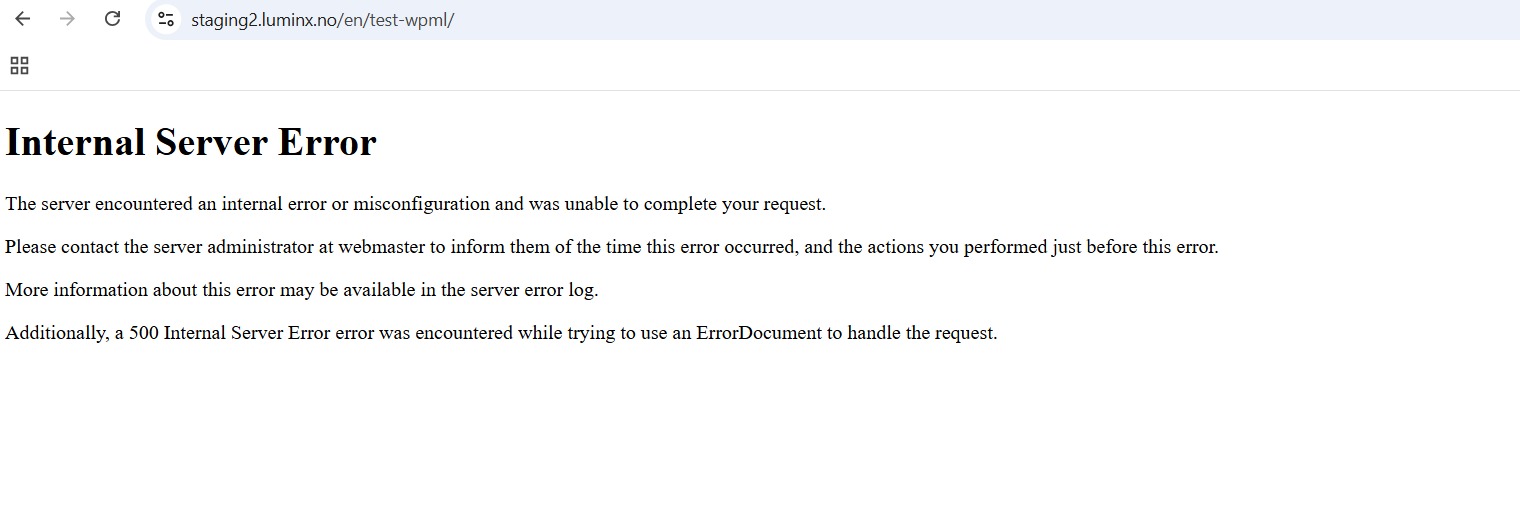

Problem 1 – 500 Internal Server Error
The problem occurs when switching languages.
Steps to reproduce:
Open the Norwegian page: hidden link
Switch the language to English → hidden link
Switch back to Norwegian.
The website sometimes returns a 500 Internal Server Error.
Error message displayed:
The server encountered an internal error or misconfiguration and was unable to complete your request.

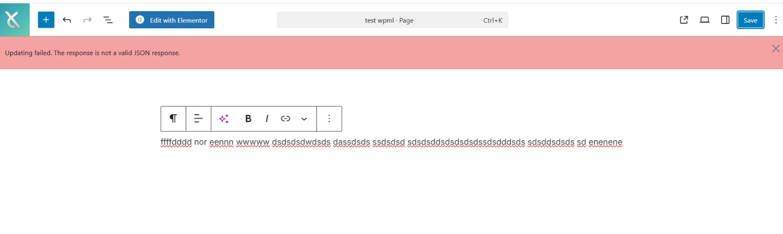

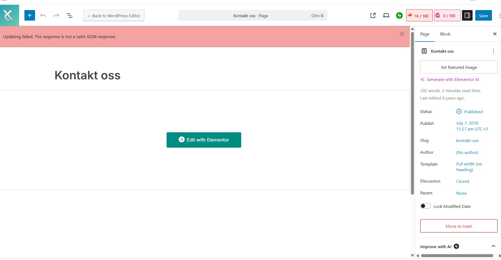

Problem 2 – Error while editing translations
When editing or saving translations in WordPress, I sometimes receive the following error:
“Updating failed. The response is not a valid JSON response.”
Additional information:
The issue started after activating and configuring WPML.
WordPress otherwise works normally.
Server settings appear to be correct.
The issue occurs intermittently.

March 12, 2026 at 9:53 pm #17894071
Aleksandar Gligoric
Hello WPML Support Team,
I am experiencing a persistent issue with WPML on my staging site:
Staging site URL: hidden link
Whenever I try to access certain pages, especially /en/wp-json/ or /en/test-wpml/, I get a 500 Internal Server Error.
The Apache error log shows the following message:
[core:error] [pid 39635:tid 39635] [client 94.253.188.89:12148]
AH00124: Request for staging2.luminx.no:/home/u3-ds6phfvu4ix1/www/staging2.luminx.no/public_html
exceeded the limit of 10 internal redirects due to probable configuration error.
Use 'LimitInternalRecursion' to increase the limit if necessary.
Use 'LogLevel debug' to get a backtrace.
I suspect this is caused by a redirect loop related to WPML language directories (/en/, /no/).

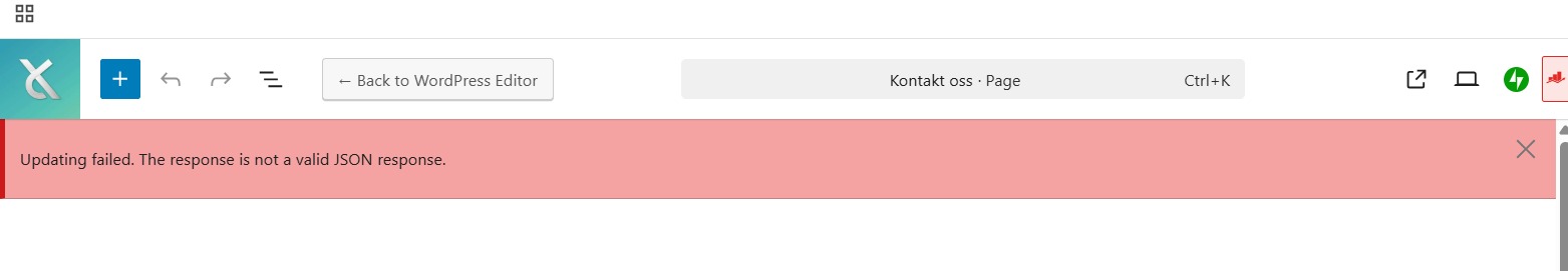

March 16, 2026 at 10:27 pm #17901792
Aleksandar Gligoric
I have checked again and can confirm that the issue is still occurring.
1. When I try to save a page, sometimes the save goes through successfully, but quite often I encounter the error: **“Updating failed. The response is not a valid JSON response.”**
2. I have also recorded a video demonstrating another bug. The issue happens on the frontend when a user switches from one language to another and then switches back to the original language. At that point, an **“Internal Server Error”** appears.
Please take a look at the video where the issue is demonstrated.
March 17, 2026 at 4:27 am #17902132
Shekhar Bhandari
WPML Supporter since 03/2015
Hello there,
Thank you for the video, I checked as you shown and fix it by following the steps as mentioned here: https://wpml.org/faq/why-is-htaccess-getting-overwritten-with-the-language-folder-on-my-wpml-website/
I have added the snippet here: hidden link
Please check and confirm if this fixes the issue.
