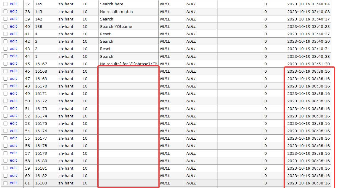

We have cross-checked your database locally. As of now, 117 strings have been translated. However, that data was lost from the database on 19.10.2023 between 04:00:00 and 09:00:00. Please check the attached image for more details. Therefore please investigate the actions on that day with the help of the hosting team.
The string translation is working as expected when I retranslate one of the strings. Please check the following screencast for more details.
Thanks!

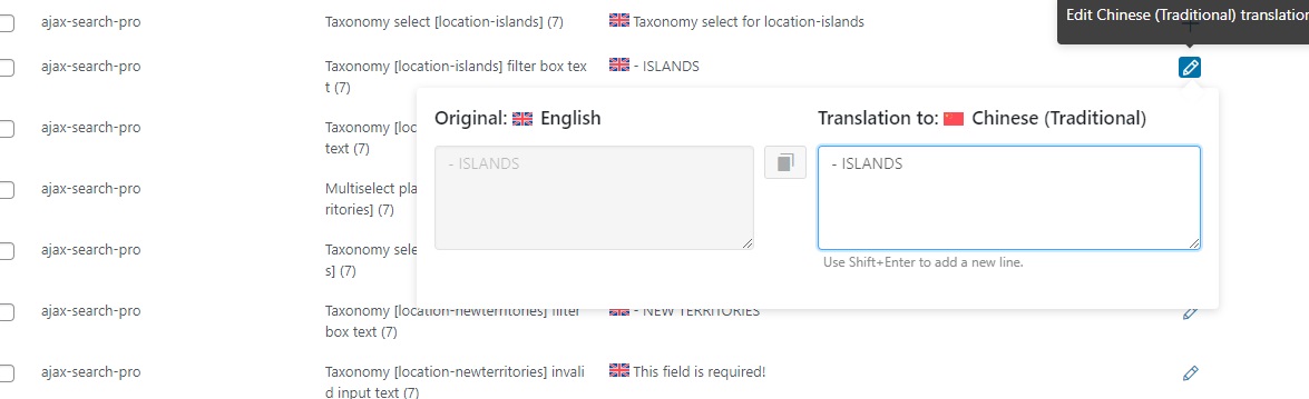

Thank you for the updates. The *ISLANDS* is one of the strings translated, but lost the translation in the Database on 19.10.2023. But I can retranslate it without any issues now. Please refer to the following screencast for more details.
If you are still having problems with it, please share a screencast for a better understanding. You can share the screencapture video via Google Drive or Dropbox.
Thanks!
