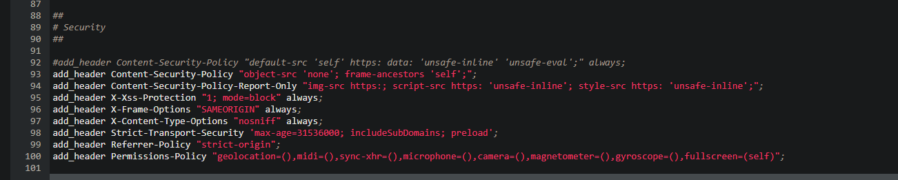

We've applied all your suggestions, but neither the automatic translation nor the translation strings assignment is working yet.
We couldn't find the header:
add_header Access-Control-Allow-Origin "*";
in the Nginx config file (spec-settings.conf).
Could you please confirm that those changes were successfully done on our side to proceed with the research?

I have another feedback and could you perform the following changes?
You need to rehash (restart) your Nginx server after making changes.
Modifying anything alone won't do any good without it as the config will not be applied.
I would suggest to test by commenting out these security headers:
add_header Content-Security-Policy "object-src 'none'; frame-ancestors 'self';";
add_header Content-Security-Policy-Report-Only "img-src https:; script-src https: 'unsafe-inline'; style-src https: 'unsafe-inline';";
add_header X-Xss-Protection "1; mode=block" always;
add_header X-Frame-Options "SAMEORIGIN" always;
add_header X-Content-Type-Options "nosniff" always;
add_header Strict-Transport-Security 'max-age=31536000; includeSubDomains; preload';
add_header Referrer-Policy "strict-origin";
add_header Permissions-Policy "geolocation=(),midi=(),sync-xhr=(),microphone=(),camera=(),magnetometer=(),gyroscope=(),fullscreen=(self)";
Could you perform a backup and try the steps mentioned by our 2nd Tier Support? Let me know how it goes.
August 16, 2023 at 3:15 pm #14239107
o-i-wpml
Hello Kor,
Thank you for your guidance and support.
I followed the steps you provided, including commenting out the specified security headers in the Nginx configuration file. After making these changes, I rehashed (restarted) the Nginx server as suggested. I'm pleased to report that the issue has been successfully resolved. The desired changes have taken effect, and everything seems to be functioning as expected.
