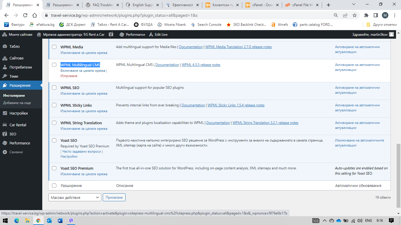

I am trying to:actived WPML
Link to a page where the issue can be seen:hidden link
I expected to see:
Instead, I got:

I couldn’t find row whit id 777 in wp-icl-translations table and I restore all data base from back up. Now I install WPML again and start configuration. First not recognized pages, menu and logo, then I change the language option of every page from English to Bulgarian(originally I keep the Bulgarian version because have a problem to migrate from Q-translate to WPML.
However when I start to upload logo, boom 💥 again fatal crash errors!
