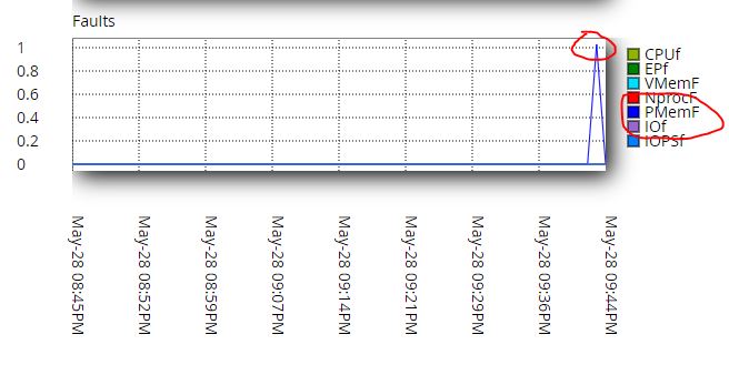

The Error is shown as a "PMemF" in Cpanel.

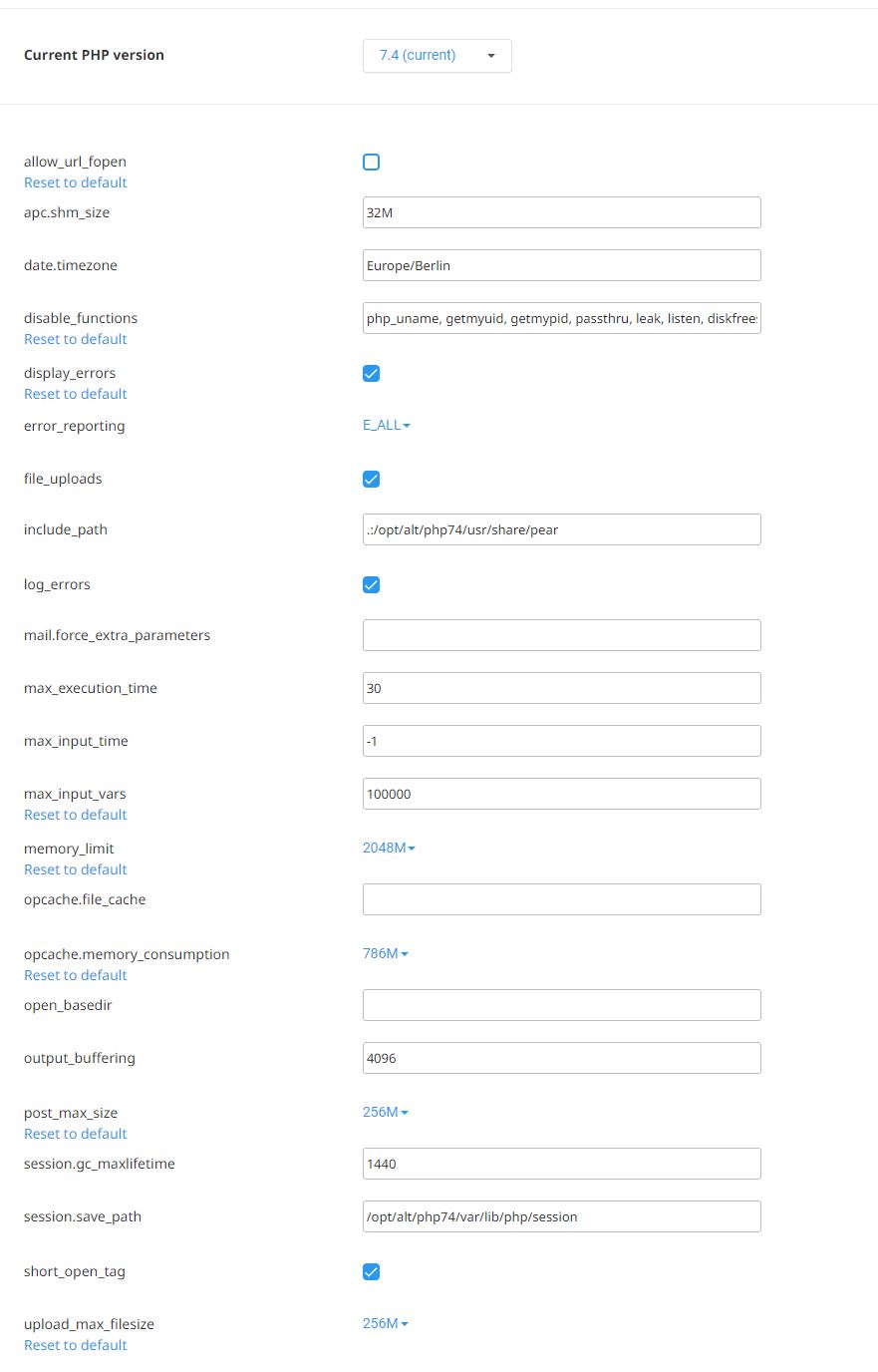

Thank you for getting in touch. After reviewing the screenshot you provided, I observed that the "max_execution_time" is set at a relatively low value. I recommend increasing it to 300 or higher to see if it resolves the issue.
Additionally, since the "503 Service Unavailable Error" typically pertains to server-related issues, I advise reaching out to your hosting provider. They should be able to examine the server logs for further insight and assistance in resolving this matter.

I increased the max execution time to 300 but it does not change anything. I get the 503 aprox. 6 seconds after hitting the save button.
The only webserver Error I get after saving is shown in the attached image.
As I previously wrote it seems to be a "PMemF" Error (Memory) but more than enogh memory is available. Tis error is allways triggerd when I try to save the page.

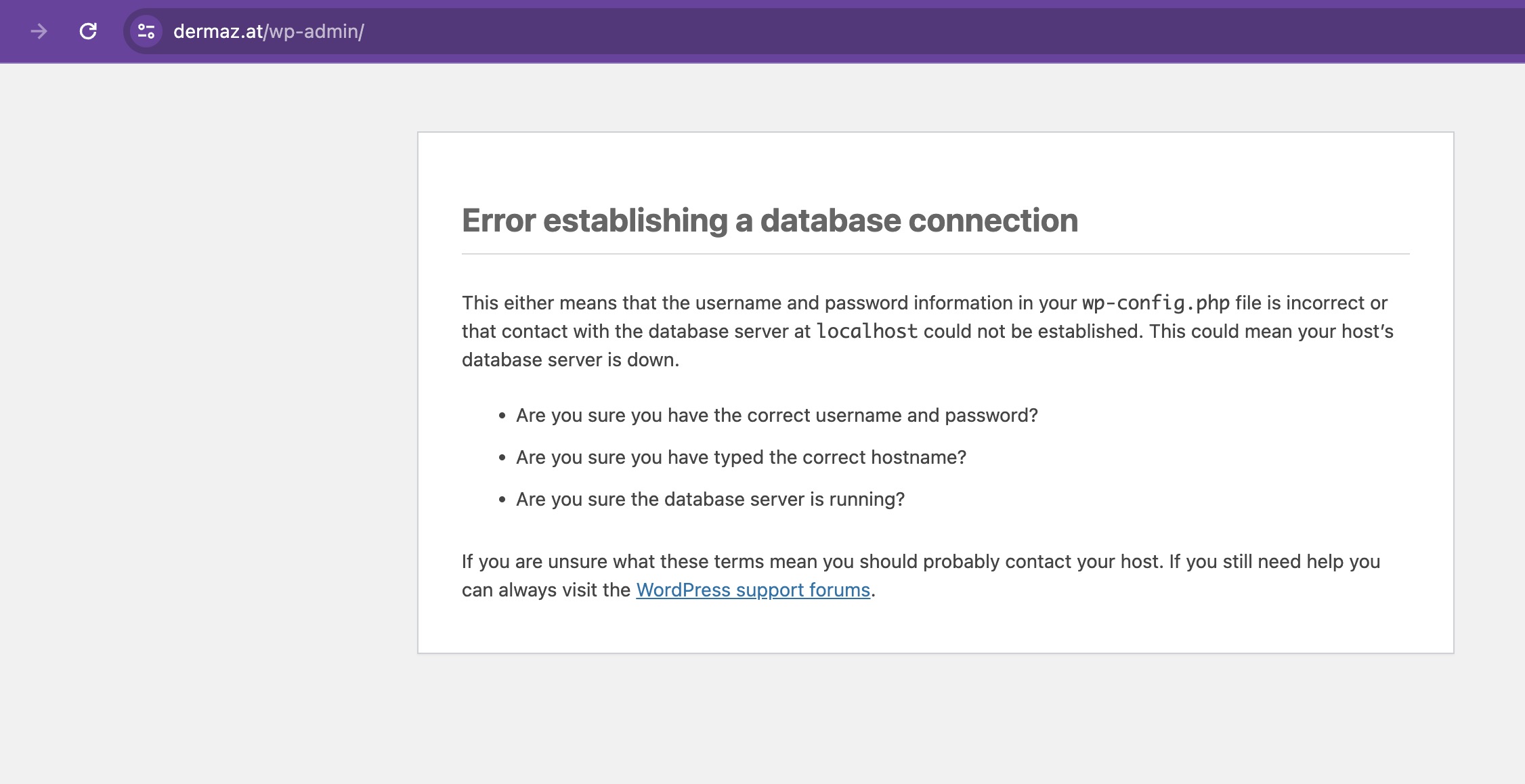

Sorry, I think I broke the site while trying to enable the debug log as explained here https://developer.wordpress.org/advanced-administration/debug/debug-wordpress/ . Could you please check what's going on?
It is showing "Error establishing a database connection" now.

Are you working on the site? I'm still getting "Error establishing a database connection" as shown in the attached screenshot. Could you check?

As I wrote in my initial post. The save page request triggers a PMemF error as seen in the picture.
