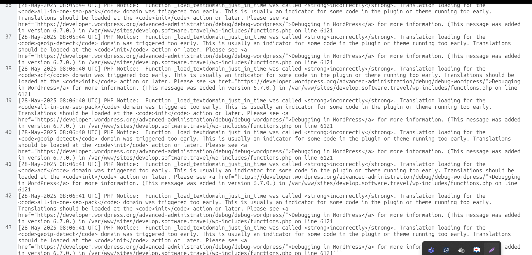

load text domains are issue with loading of translation files coming from each plugin / theme not anything related to WPML or your issue.
From other error log, looks like your server is crashing / timeouts and thus post is not being saved. Error you shared "epoll_wait () reported that client prematurely .." usually points to a server-side timeout or crash, rather than a direct PHP error from WordPress or WPML.
If possible check further for nginx error logs, look for errors or timeouts and this will tell you what you should increase in your server settings, it could be many thing and it is hard to guess like this. I would really advise checking with hosting or server support.

you see my screen for php limits?
There are limits set there that are even higher than what you suggested.
I showed you what errors there are in the server locks when saving a page

but the bug still reproduces
ngnix errors
May 28, 2025 at 8:17 am #17081872
Dražen
error log you shared is not related or helpful in this case. Please share again same nginx server error logs, not WP debug log.
Please confirm you have change server requirement as we suggested, since this is not clear from your reply.
