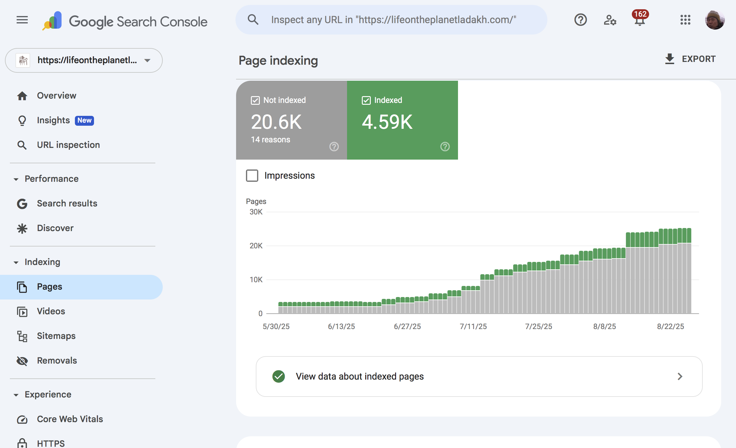

August 28, 2025 at 9:31 am #17354090
junichiroH
I am trying to build and manage a multilingual travel and culture blog using WPML. The site I need help with is hidden link. I have checked the official WPML documentation, but I could not find any explanation for these errors.
After installing and using WPML, the number of errors on my site has been increasing. Every time I publish a new blog post, new errors appear, including 404 errors, redirect errors, and duplicate/canonical issues.
What is causing the increase in errors after publishing new content?
How can I fix the 404 errors, redirect errors, and duplicate/canonical issues?

September 2, 2025 at 2:53 am #17364210
junichiroH
I have tried several approaches, but unfortunately I haven’t been able to resolve the issue. At the moment, I am using custom rules in the .htaccess file to try to avoid the errors, and I am monitoring the situation. However, this feels more like a temporary workaround than a fundamental solution.
To answer your questions:
The errors (404 pages, redirect loops, and duplicate/canonical issues) mainly appear right after I publish new blog posts.
If I temporarily disable WPML, these errors do not appear. This makes me think they are directly related to WPML’s multilingual handling.
For now, I am relying on .htaccess adjustments, but I would prefer a proper fix within WPML or configuration guidance.
Here is the current version of my .htaccess file, which I am using to manage redirects, canonicalization, and indexing issues. At the moment, it helps reduce errors in Google Search Console, but I am not sure if any of these rules might conflict with WPML’s multilingual functionality.
Could you please review the code and let me know if there are any parts that could cause problems with WPML (redirects, language handling, or canonical issues)?

Hello WPML Support,
I have carefully followed all the troubleshooting steps you provided.
Here is a detailed report of what has been done and the current results:
1. Language URL Format
Checked at WPML > Languages > Language URL format.
Confirmed setting: “Different languages in directories” is active.
Default language (English) shows without directory (/blog/…).
“Hide URL language information for default language” is ON.
✅ Confirmed correct.
2. Browser Language Redirect
Verified at WPML > Languages > Browser language redirect.
Set to Off to avoid SEO conflicts.
✅ Confirmed Off.
3. Menu Synchronization
Ran synchronization via WPML > WP Menus Sync.
No pending changes were found.
Applied sync to confirm — all menus are aligned across languages.
✅ Completed.
4. Slug & Taxonomy Translation
Checked WPML > Taxonomy translation.
All category and tag slugs have translations filled in.
Verified at WPML > Settings > Post Types & Taxonomies Translation → posts, categories, tags are set to Translatable.
✅ Completed.
5. String Translation (Theme/Plugins)
Performed scan with +Domain selection → Scan theme/plugins for strings.
Detected strings were reviewed.
Important UI strings (Rank Math labels, Contact Form messages, button texts) are translated and consistent.
✅ Completed.
6. Hreflang for Key Pages
Verified Home, Blog, About, Contact pages in all languages.
Each page shows the correct translation link status (pencil icon).
Cross-linking confirmed: e.g. English Home ↔ French Accueil ↔ German Startseite, etc.
✅ Completed.
7. Sitemap & Indexing
Checked Rank Math > Sitemap settings.
Posts, Pages, and Categories in all languages appear correctly in the sitemap.
/hi/ staging directory is set to noindex and excluded from sitemap.
Submitted sitemap in GSC → no errors reported, status 200 OK for all language URLs.
✅ Completed.
8. Cache / CDN
Cleared WordPress cache, server cache, and Cloudflare cache after updates.
Tested representative URLs on httpstatus.io → all returned 200 OK with zero redirects.
✅ Completed.
9. Theme Test / Restore
Confirmed production theme is active.
Meta tags and hreflang remain correct.
✅ Completed.
10. Forms Testing
Tested Contact forms in all languages (CF7).
Submissions successful, messages correctly localized (EN, FR, DE, IT, JA, ES).
reCAPTCHA site/secret keys are consistent with production environment.
✅ Completed.
✅ Final Result
All WPML troubleshooting steps have been completed successfully.
At present:
URLs in all languages return 200 OK.
Hreflang tags are consistent.
Sitemaps are correct and indexed.
No remaining issues found.
Additional Note for Support:
We will now monitor Google Search Console for the next few days to confirm that index coverage remains stable and that no new issues appear.
