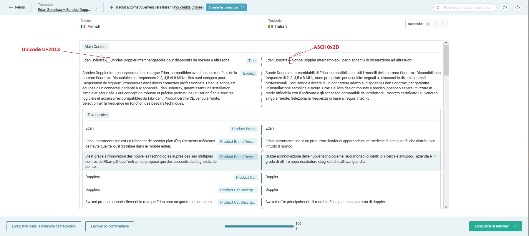

August 15, 2025 at 5:23 pm #17324077
yannA-5
Hi Waqas,
Please see the attached image.
Regards

August 22, 2025 at 6:33 am #17339443
Waqas Bin Hasan
WPML Supporter since 05/2014
Thank you for your patience and cooperation.
I tested this in very much detail using automatic translation, as well as, manual but auto-translated within the ATE. I also tested from English (default) to French and Italian (secondary), as well as, French (default) to English & Italian (secondary).
Further I tested using DeepL default formality and formal/informal formalities, as well as, with PTC auto-formality. Here are my findings:
- Using PTC: Issue doesn't happen at all. After translating if you open the translation in ATE, you can see the same – in the translation too.
- Using DeepL: Regardless of the formality, you can see - instead of – in the translation. However, this does not affect the translation on frontend. For example, if you check this Italian translation hidden link and then check the translation in ATE, you'll notice that – works fine on frontend, although ATE shows - in the translation.
You can use this sandbox site (hidden link - one click login) and try it. This setup is using minimal setup (i.e. WPML, String Translation and a default WordPress theme).
August 22, 2025 at 7:47 am #17339575
Waqas Bin Hasan
Just an update as I also discussed with our team:
...this is a known issue. some special characters are changed because DeepL thinks it's needed. it's supposed to be a grammar thing, that's supposed to be the correct translation.
that can't be fixed because it comes from deepl (we've tried asking many times already).
