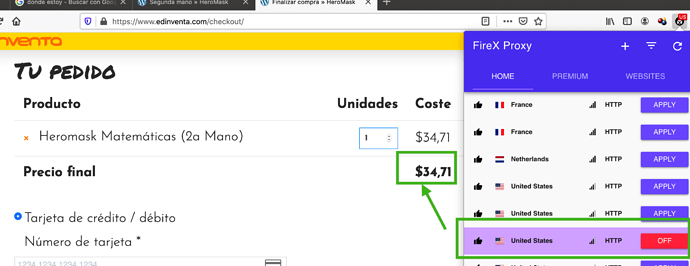

Checkout does show the currency correctly (direct link to check yourself here: hidden link ).

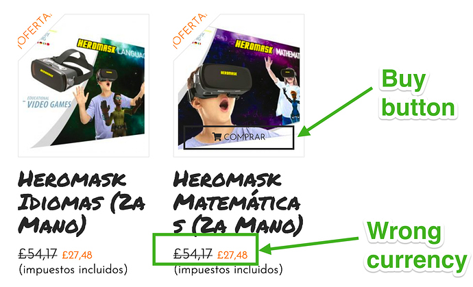

But the currency on the store shows a wrong currency (direct link to check yourself here: hidden link ). The currency should be USD ($) because I’ve set the proxy in United States. However, the price is shown in British Pounds instead.
This is the shortcode used on that page: [product_category category="2"]
Any idea to show the correct currency everywhere? 🙂

Currently, checkout does show the currency correctly (direct link to check yourself here: hidden link ).
Unfortunately the currency on the store shows a wrong currency (direct link to check yourself here: hidden link ). The currency should be USD ($) because I’ve set the proxy in United States. However, the price is shown in British Pounds instead.
Please, see the screenshots I've attached on the first message.

What happens is that different currencies are shown depending of the page. For example, on US (using a proxy to test it):
- Checkout is showing US dollars (perfect!)
- The store is showing British pounds (wrong!)
I've included screenshots on the first message for better understanding as well as links to check yourself along this thread.

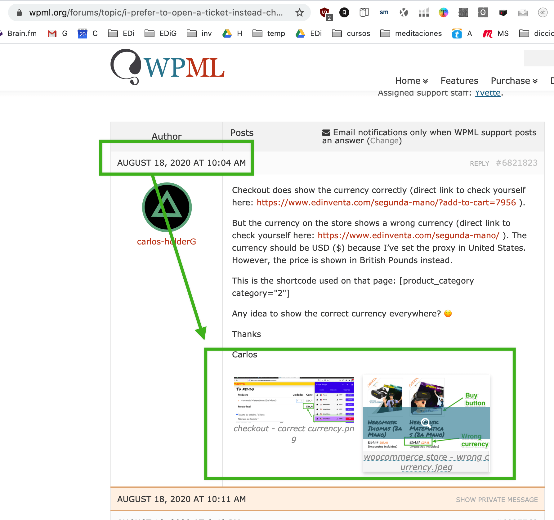

The images uploaded perfectly because I'm seeing them. They are on the first message (message of AUGUST 18, 2020 AT 10:04 AM).
The proxy I've used for testing is a Firefox addon: hidden link
