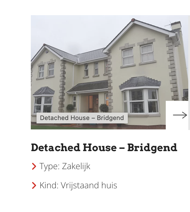

I am trying to translate ACF radio buttons on my website. The issue can be seen on this page: hidden link
I expected to see English values, but instead, I got Dutch values.
How can I translate ACF radio buttons to show English values instead of Dutch?

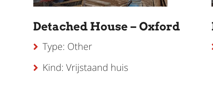

March 18, 2025 at 1:18 pm #16830546
nascoL
Hi Christopher,
Thanks for getting back at me. I see some are translated but not all (see attached screenshot). I have tried the same for the other string also (Kind), but it still shows the Dutch language. if I look at String Translation i see all strings translated. can you pinpoint the issue here?
Thanks!

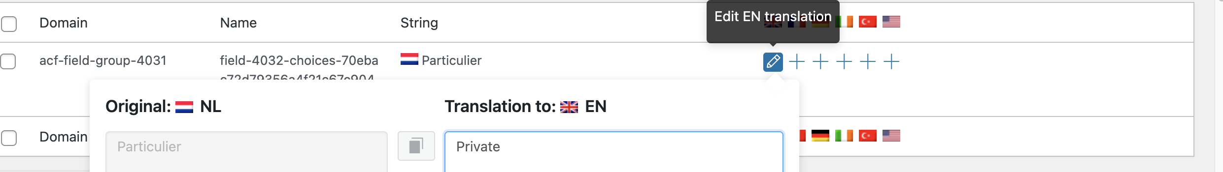

March 21, 2025 at 1:56 pm #16844939
Christopher Amirian
WPML Supporter since 07/2020
Sorry for my late reply, I fixed the code to include other scenarios.
Also I found out that the there was instances of the choices that were detected in wrong language in string translation.
I changed the language source:
https://wpml.org/documentation/getting-started-guide/string-translation/how-to-change-the-source-language-of-strings
Also some instances were not translated and I translated them.
The only problem that is still there is some sort of conflict for the Vrijstaand huis option.
In the code it shows the key as:
vrijstaandewoning instead of vrijstaandhuis
That is why it does not show. If you change the option to something else in the radio of a project you will see that it works ok.
I suggest that for that you remove the option and remove the translations of those options and try to add it at the end of the choices of the radio with slightly different wording and do the translation and see if it works ok.
