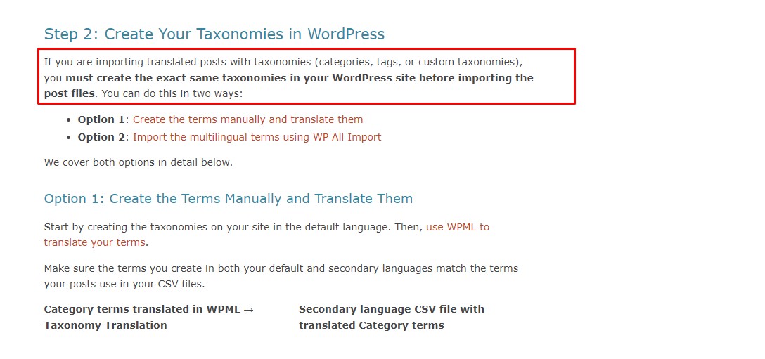

I have checked your conversation with my colleague, and I must say what you are trying to achieve is not possible and not how we recommend using WP All Import with WPML nor how it was intended.
- Mateus Getulio : The option to Auto-Create Terms should be disabled even for the default language import. You should already have all of your taxonomies, including attributes, created and translated before running the import.
Mateus Getulio : This might be related.
bartV-64 : But thats not possible, because all our product data is being imported every night. Sometimes new terms are added that day
In our docs, we clearly mention that taxonomies need to be created before the import and I am afraid that is a required step in order for the import to work correctly, otherwise issue will happen.
- https://wpml.org/documentation/related-projects/wpml-all-import-plugin-website-import-with-wpml/importing-multiple-languages-with-wp-all-import-and-wpml/#step-2-create-your-taxonomies-in-wordpress
I understand your side, but that is not how these plugins work. The best I can advise is to create an import for taxonomies first, make sure they are created and translated, and then import products.
Or hire a contractor to create a custom solution for you:
- https://wpml.org/contractors/
Hope you understand.
Drazen

- hidden link
So you need to create attributes before you run import for variable products, You can create these attributes manually or via attribute import, however you prefer to.
Hope this helps.
