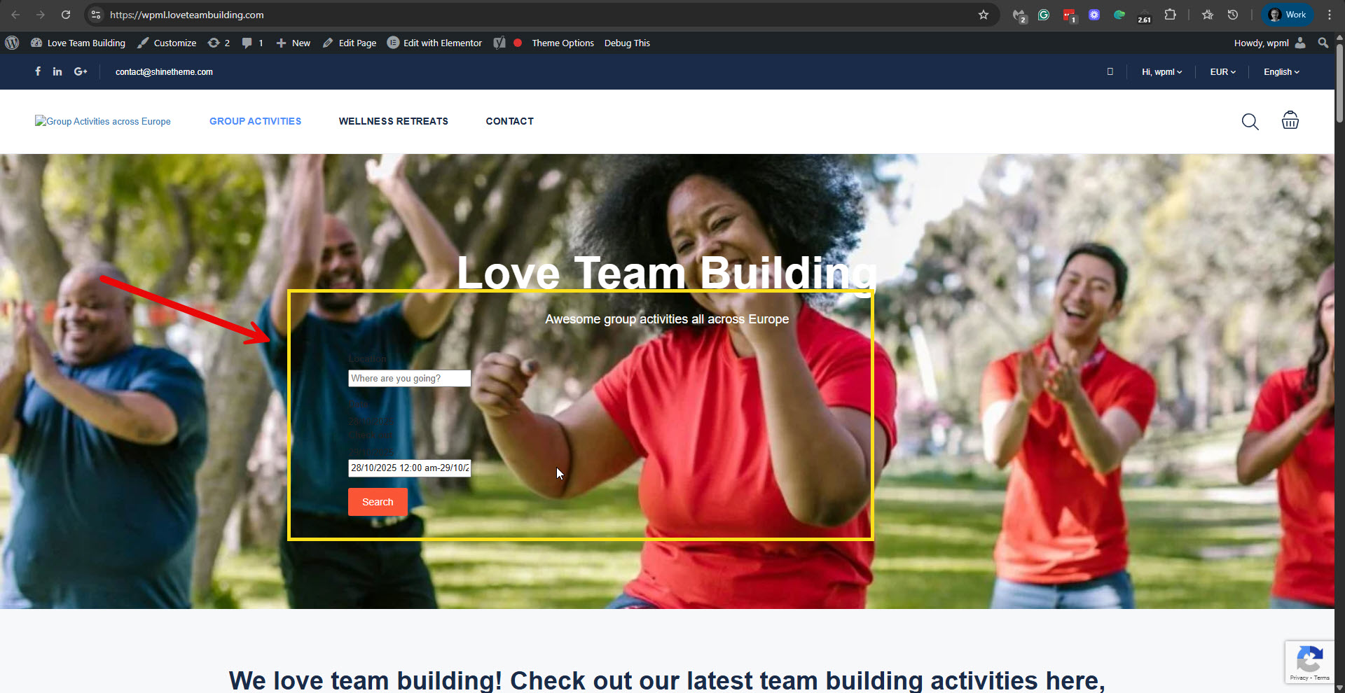

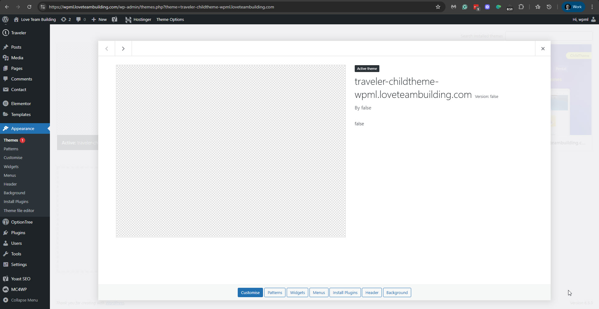

I can see that the layout of the search option in the header breaks when WPML is active. Please see the attached screenshot. I can also see that you are using a customized child theme for the Traveler theme. Please see the attached screenshot. In general, custom code is out of the scope of our support forum. We can try to help further, but we need more information from you, please.

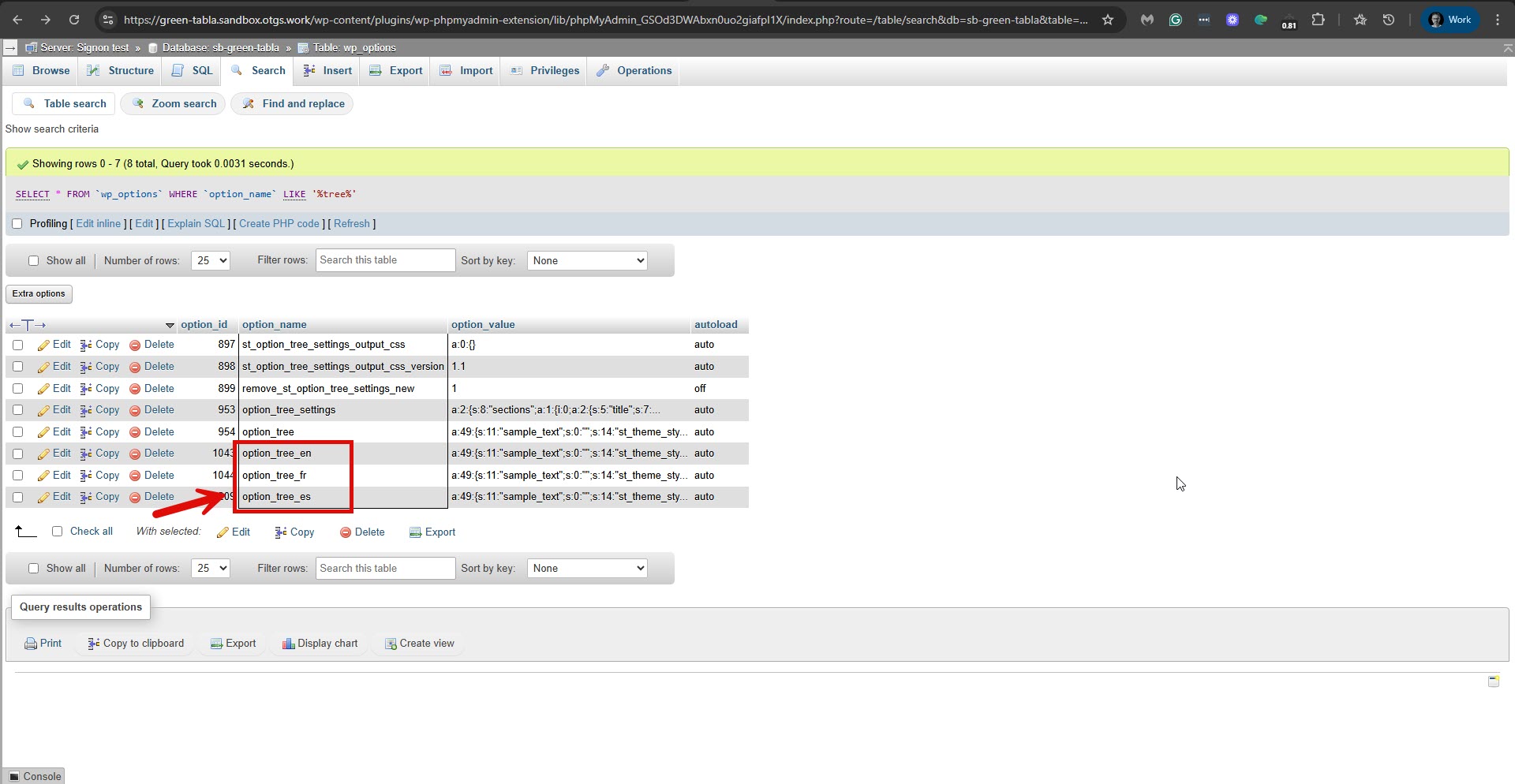

So no thanks to you I was able to find the issue. From what i understand on new installation WPML would create an entry in wp_options table copying the Traveler theme settings from "option_tree" to like "option_tree_en", "option_tree_all", etc. Because WPML was installed 5 years ago, those tables were already present with improper configuration creating this issue of mine where it appeared that settings would be reset when WPML is activated.
The main problem is that even when doing complete wipe/uninstall using your debug page, those tables would be left behind. WPML does not clean up after itself well. You should probably look into fixing that...

Those options that you see in the wp_options DB table come from the Traveler Option Tree plugin. Please see the attached screenshot. WPML did not create them; therefore, it cannot remove them when you reset WPML from the troubleshooting section. You should contact the authors of the Traveler Option Tree plugin and ask for their help with this issue. I also want to mention that the Traveler Option Tree is not officially compatible with WPML.
