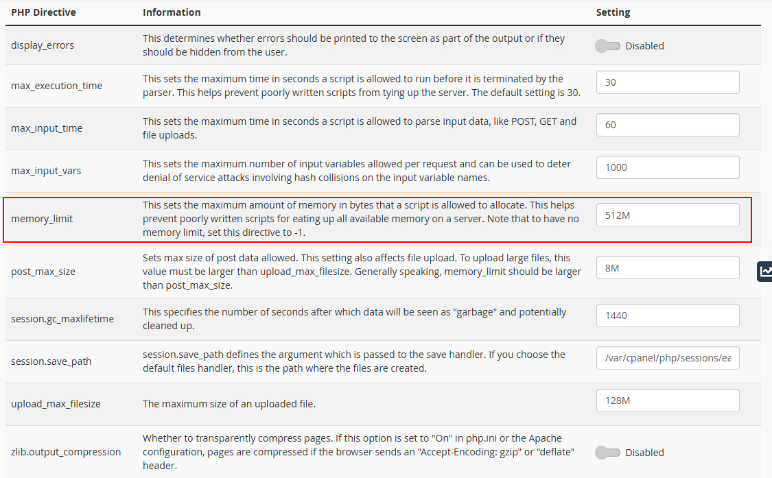

While checking the debug info, I see that the WordPress Memory Limit is below the requirements. The minimum requirements are 128M, but we do recommend 256M and the debug information of your site shows it set to 40M. Please check this link for more details
https://wpml.org/home/minimum-requirements/.
You can increase it by adding the following code in your wp-config.php file, right before the /* That’s all, stop editing! Happy publishing. */ line:
define( 'WP_MAX_MEMORY_LIMIT', '256M' );
define( 'WP_MEMORY_LIMIT', '128M' );
After adding the code you can confirm that the memory was changed correctly from WPML > Support > WordPress > Memory limit.

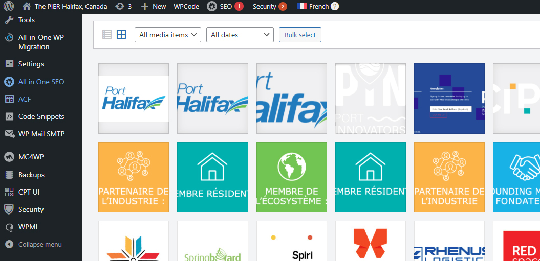

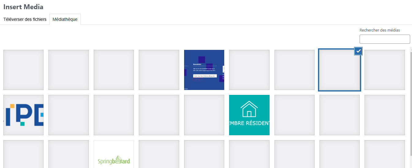

I was able to get the images to display on the French home page. But when I am editing that page in French and go to add or edit an image I am seeing blank thumbnails in the media library. If I go directly to the media library in the WP dashboard with French selected, I see the thumbnails. See the attached screenshots.
I also checked in cPanel and the memory limit for the website is set to 512M.

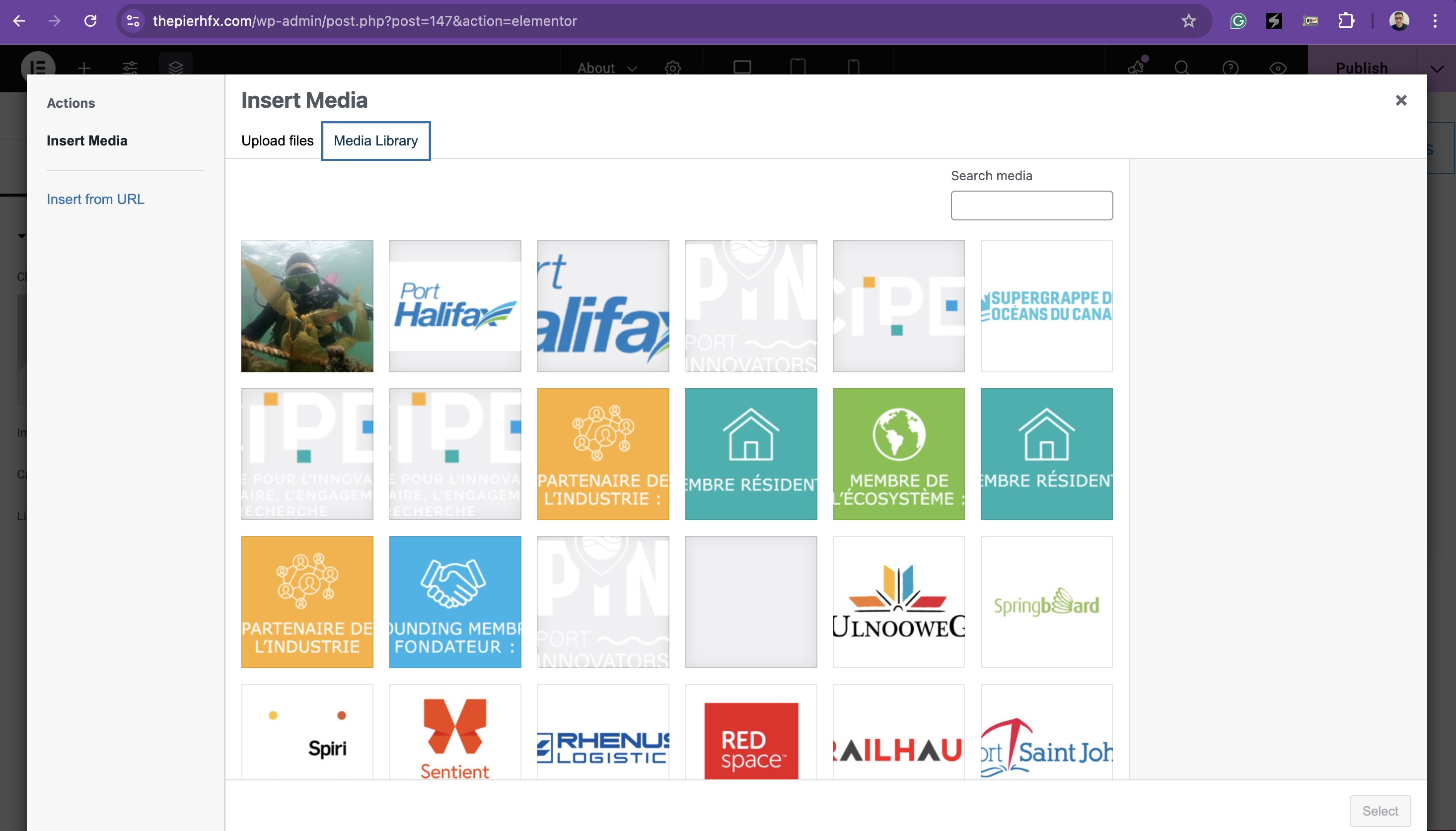

I've tried to edit the page here using Elementor hidden link and inserted a media to check the library. But it looks fine as shown in the attached screenshot. Could you list the steps to replicate the issue?

When I edit the French home page, I still am seeing blank thumbnails loading in the media library when I try to add an image to the page.
