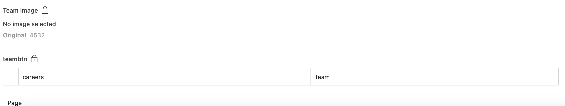

I had my secondary languages translated independently. Initially, the images and repeater fields were showing. I am following this doc https://wpml.org/documentation/related-projects/translate-sites-built-with-acf/, and I chose 'Same fields across languages' on the ACF field option. I want to be able to edit the repeater fields and images across the secondary language.
Images and repeater fields are not displaying in secondary languages. It shows a padlock sign on top and when you hover, it shows 'This field value is copied from the default language and will be kept in sync across languages.'

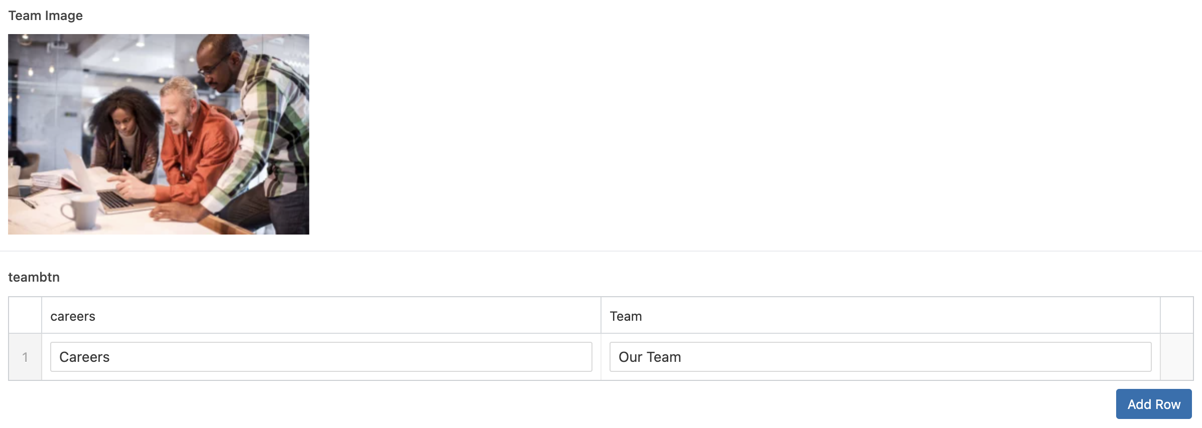

July 23, 2024 at 3:17 am #15990003
luigiK
I have attached an example of an image and repeater fields in its primary language and secondary language. This affected all the pages, they were editable previously. I want to be able to edit repeater fields and image alt in all languages.

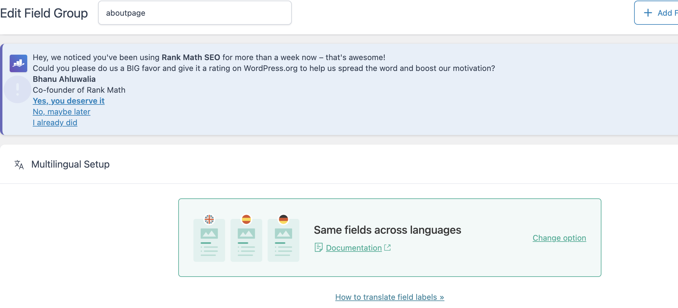

July 24, 2024 at 4:38 pm #15999638
Prosenjit Barman
WPML Supporter since 03/2023
Hello There,
I understand that certain fields aren't manually editable in other languages. This issue occurs because the Translation option for the field group is set to 'Same fields across languages'. This setting ensures that the custom field data are synchronized across languages, preventing manual editing of the fields in other languages. For more details about the setting, please check this link: https://wpml.org/documentation/related-projects/translate-sites-built-with-acf/#using-same-fields-across-languages
To be able to use a different image per language, please check this guide and I hope you'll get a clear idea of the process.
However, if you want the repeater field data to be different in each language or if you want to manually set them for each language version, you can change the translation mode for the field group to 'Different fields per language' or 'Expert'. Please refer to the guides below for more details.
- Different field per language: https://wpml.org/documentation/related-projects/translate-sites-built-with-acf/#using-different-fields-across-languages
- Expert: https://wpml.org/documentation/related-projects/translate-sites-built-with-acf/expert-translation-option/
If you choose the expert mode, you'll have the option to manually change the translation preference for each field. To manually update the fields in other languages, set the translation preference for the fields to 'Translate' and proceed to translate the page again.
