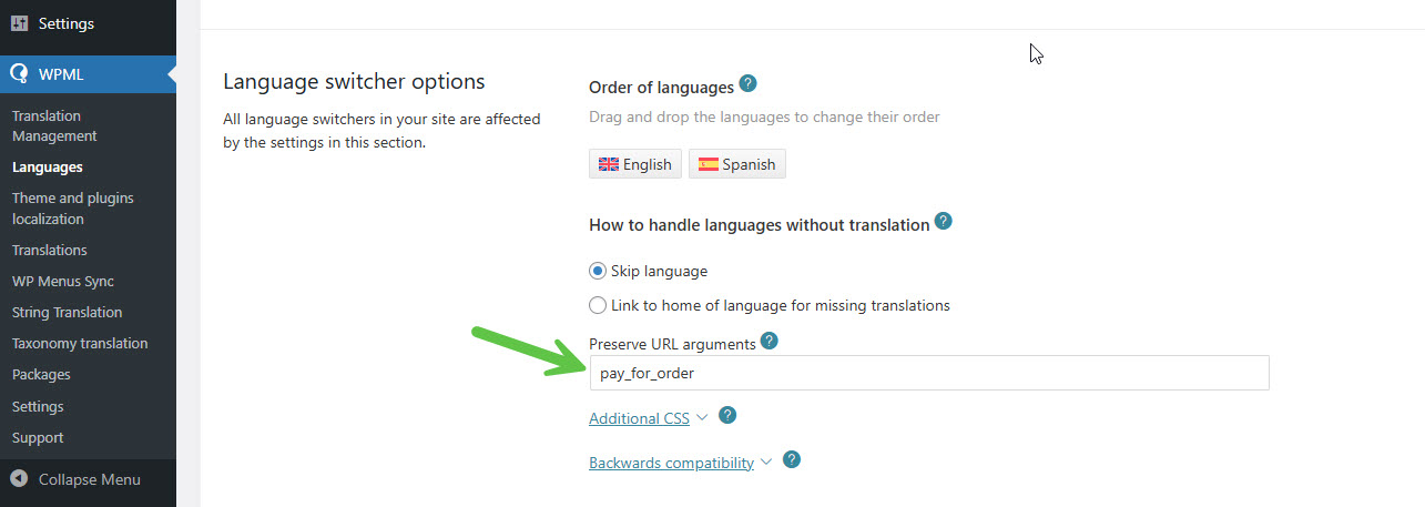

April 17, 2025 at 7:38 pm #16945698
Itamar
WPML Supporter since 02/2016
I've checked things on a fresh WordPress installation. WPML has a feature to preserve URL arguments. You can use this feature to preserve the pay_for_order argument. The setting is in WPML -> Languages -> Language switcher options. Please see the attached screenshot. Enabling this option will preserve the pay_for_order argument when switching languages on an order page. I tried it on my test, and you can see it here.
Please let me know if you have any further questions.
Itamar.
