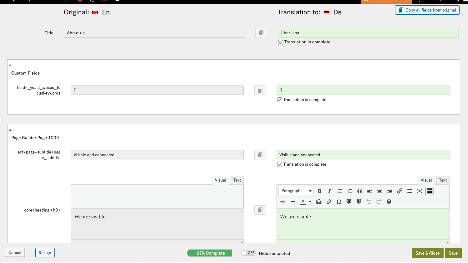

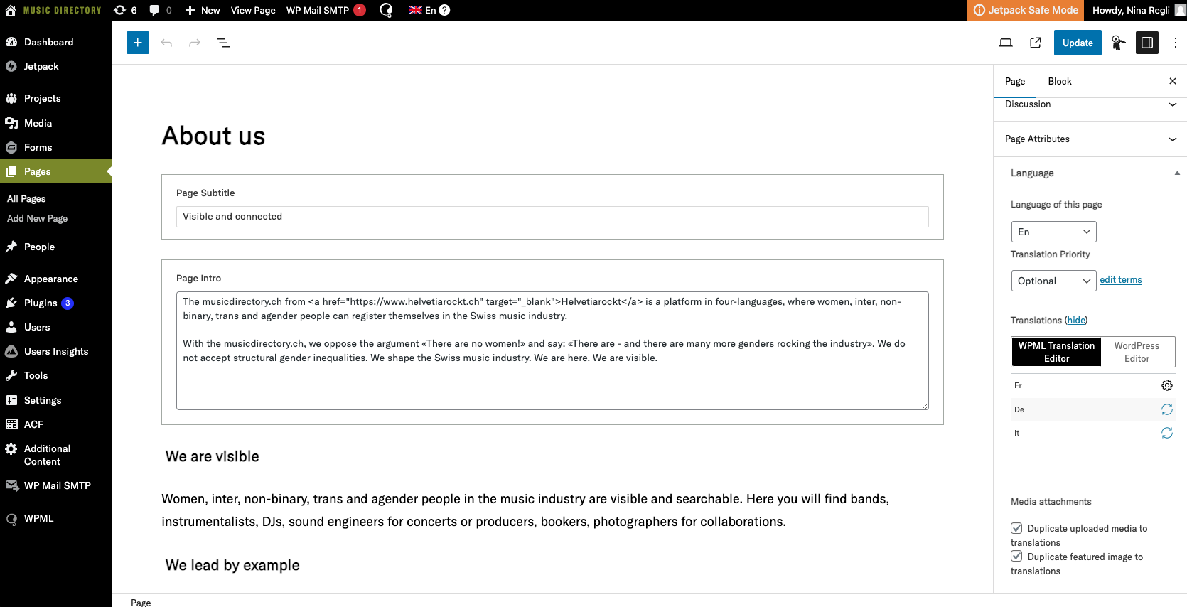

Ultimately, I'm trying to copy content of an acf block to a translated page. For that the acf block is set to copy. I'm using the WPML editor in order to update the translations of this block but instead of seeing the translated content I see all the content being copied from the default language, see links to screenshots. How is that possible? How do I manage to have the german content in the right column in the WPML editor?

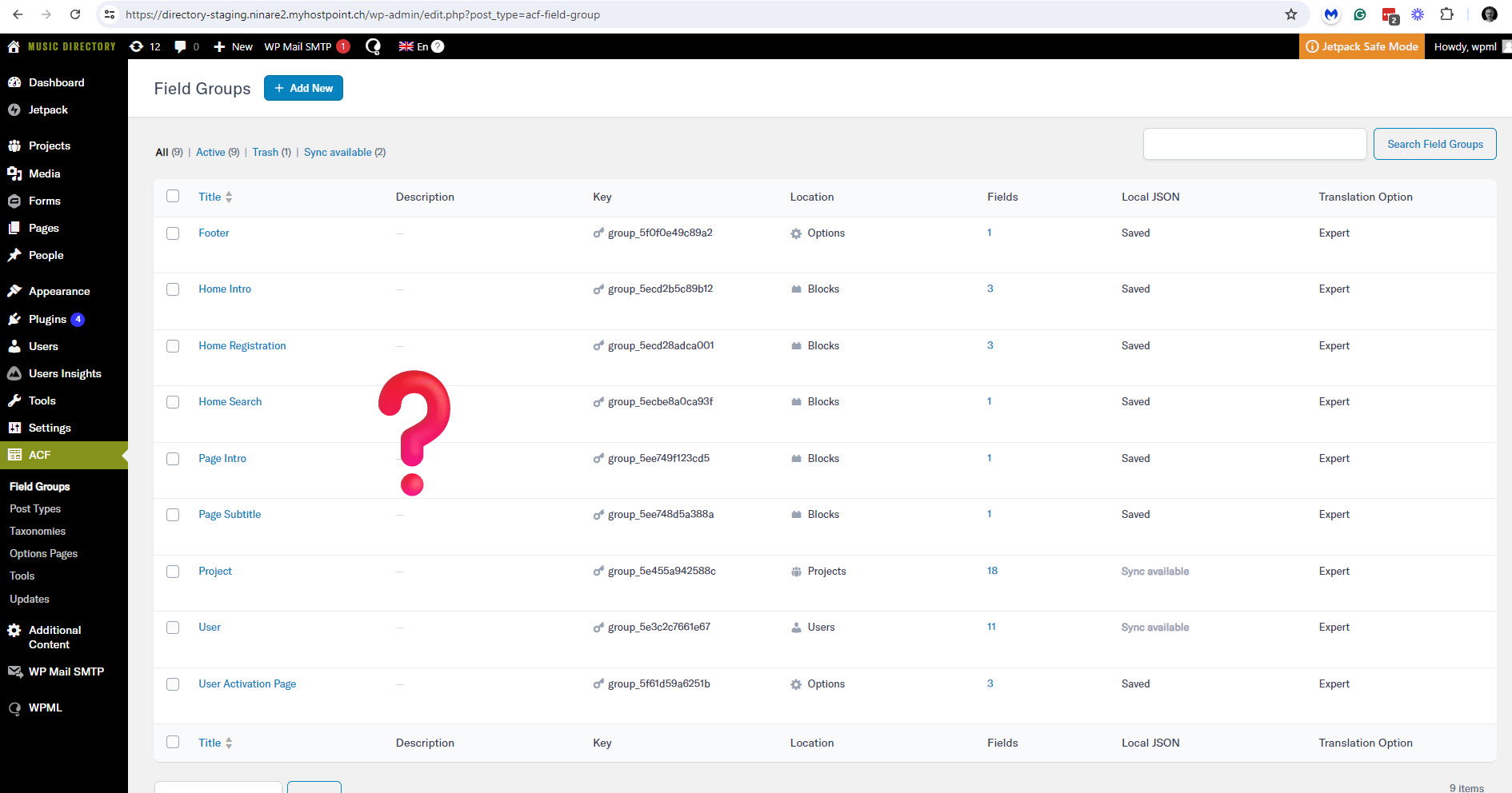

I'm sorry, but when I go to ACF -> Fields Groups, I don't see a group named "Page Supporter List." Please see the attached screenshot, no-field-group.jpg.

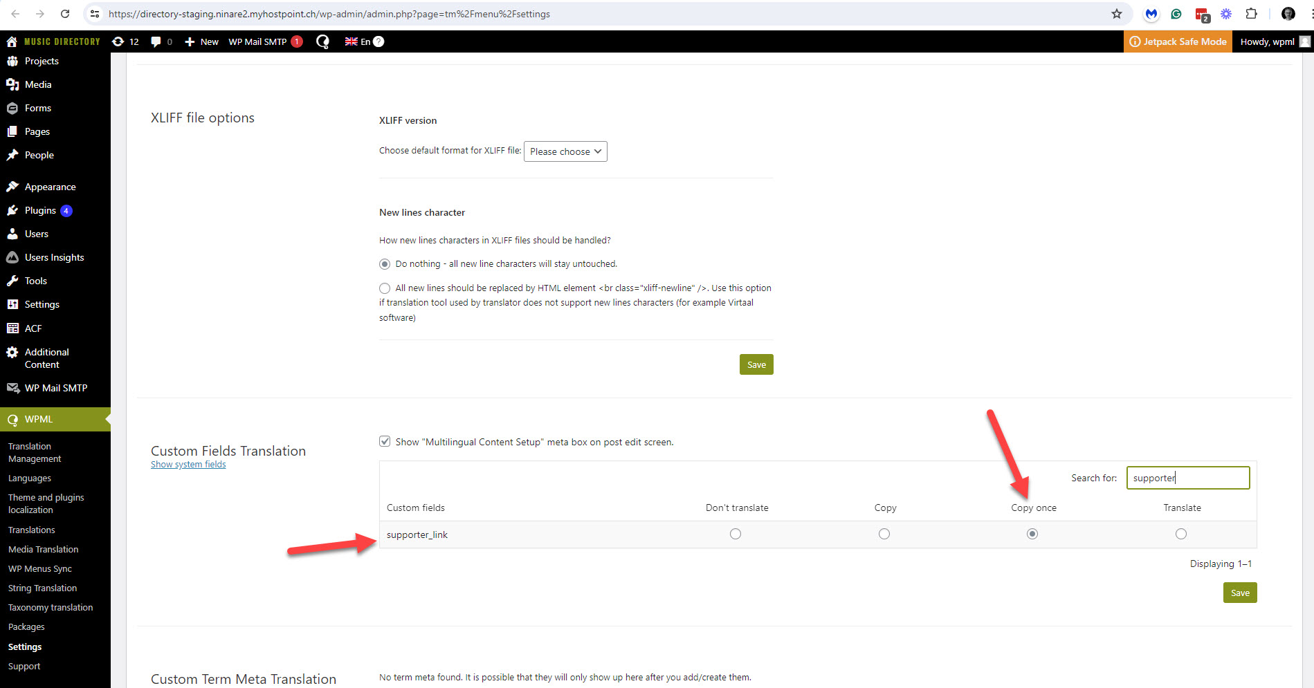

However, when I go to WPML -> Settings -> Custom Fields Translation, I can find one field with the name supporter_link. This field is set to "Copy once." Please see the attached screenshot, supporter_link.jpg.
Is this field in question?

The meaning of "Copy once" is: Copies the field value to translations just once, allowing you to independently modify the field values in translations afterward.
So you will not see it in the translations after the first time.

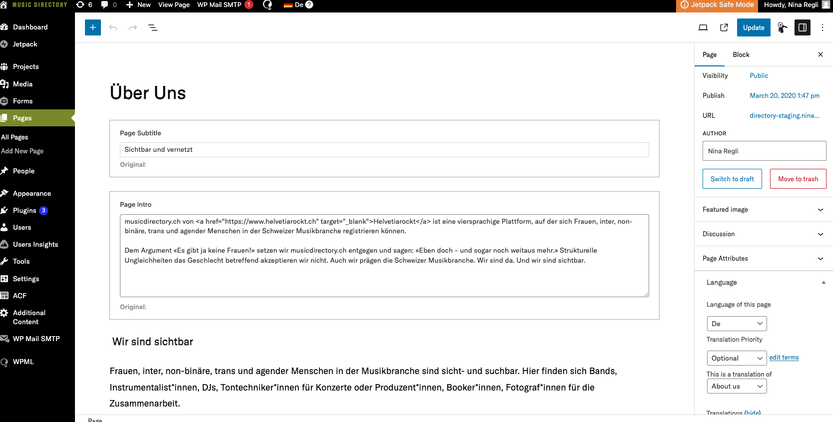

Thanks Itamar it seems indeed that for some reasons the block was in trash - it's recovered now. The situation is the following: the translations have been done with the WordPress Editor. If I understand you correct, these translations won't be visible if we switch now to the WPML Editor. I know that if the translations would have been done with the WPML Editor: the acf field content would be copied to the other languages. The question now is: Is it also possible to have the acf field copied if we use the WordPress Editor? Testing that it doesn't seem to work. (I adjust something in the supporter list in the english page, I go on the french page, update the page, the adjustments are not seen).

Thanks, I can now see the "Supporter List" field group. It is here.

I could see the problem on the page you sent me, but only in German and Italian. It worked in French.
Did you add the google.com links manually in French?
There was an ongoing translation into German with the Classic Translation Editor. I completed it, and now the links are also in German. I also added one link and image, which works only in German. But none of the new links work in Italian. Something does not seem fine here.

I switched between the WPML editor to translate and the WordPress editor to translate. I initiatially added the content in english and hoped that with the WordPress Editor it would be copied over. It did work with the WPML editor but not with the WordPress editor.

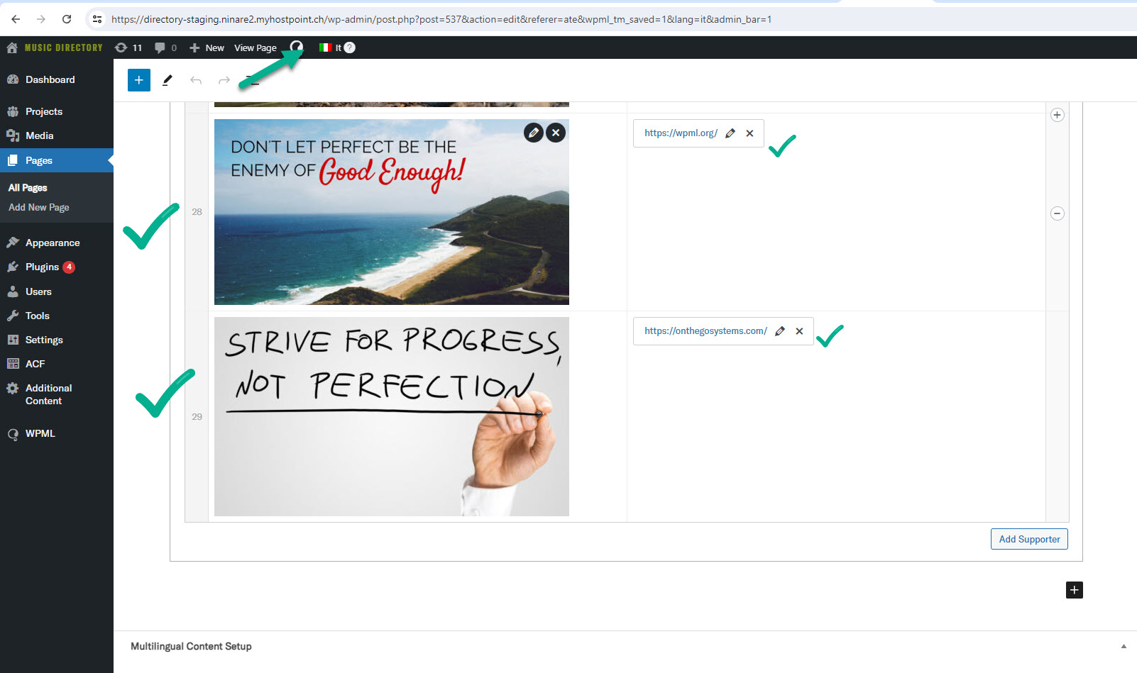

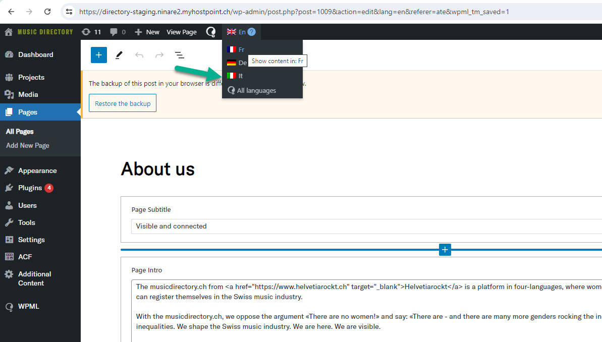

I switched the theme to Twenty Twenty-Four but then I could not see the fields. This is probably because the block is defined in your theme. So, I deactivated all the third-party plugins. Only ACF and WPML were active. When I use WPML's Classic Translation Editor the image and link are being copied to the other languages, French, German, and Italian. I can check it by switching the language with the top admin bar. Please see the attached screenshot switch-lang-admin.jpg. When I'm on the editing screen of the other languages, the test images and links I added are there. Please see the attached screenshot image-link-ok.jpg.
So please use WPML's Translation Editor to copy the fields to the other languages.
If you must use the WordPress editor please let me know and we will continue to investigate this issue.
