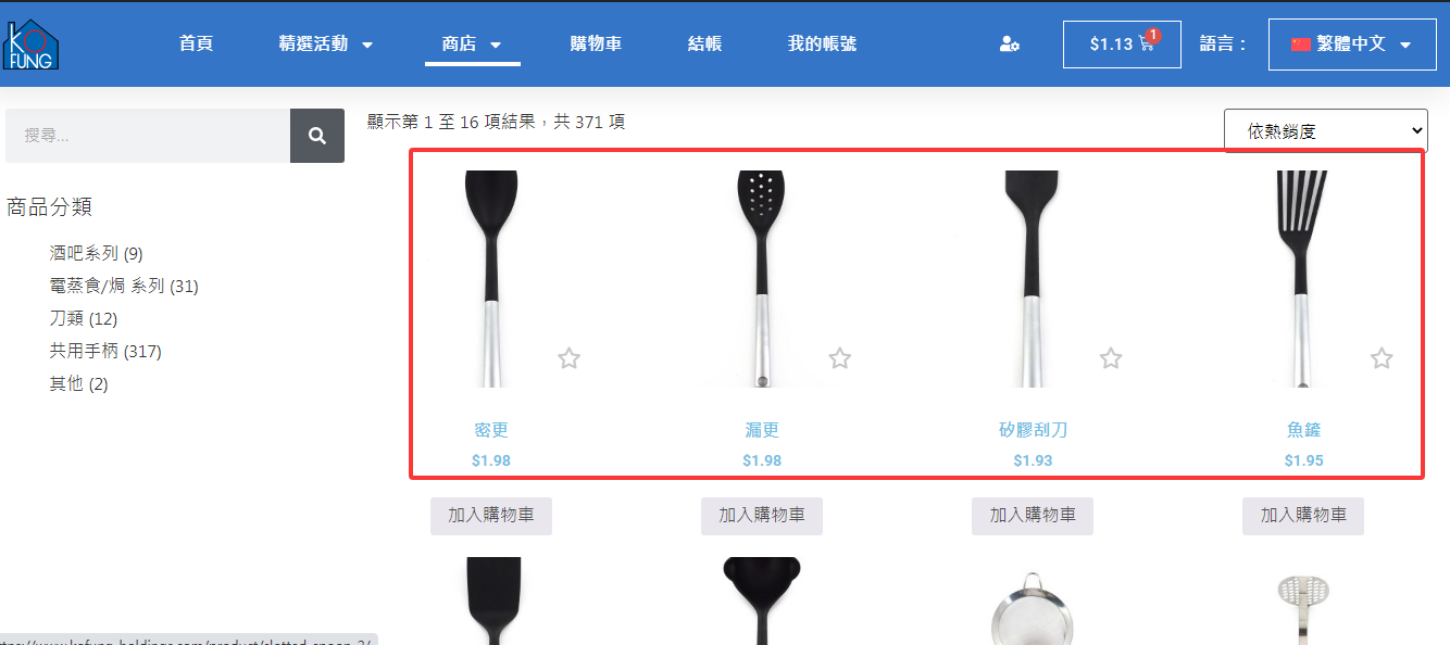

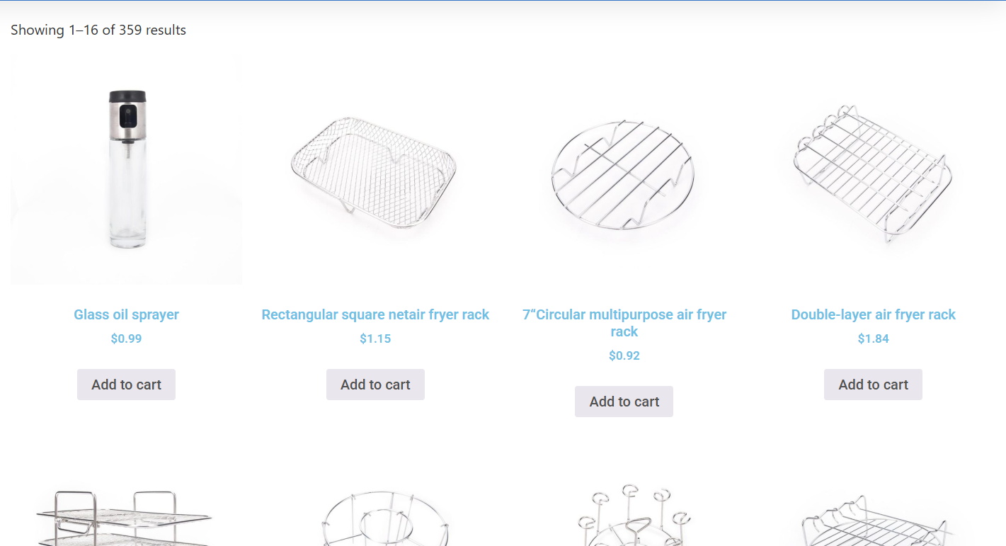

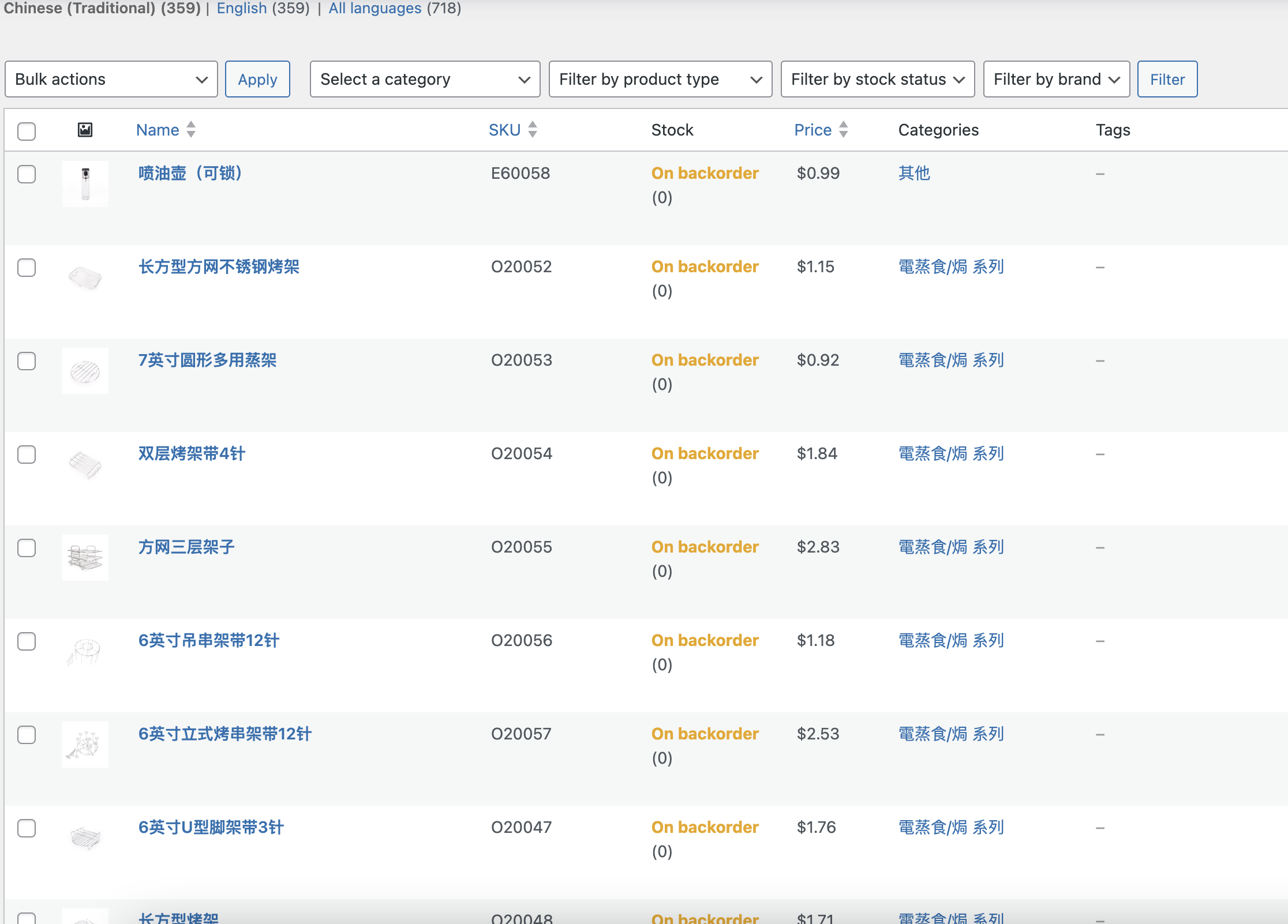

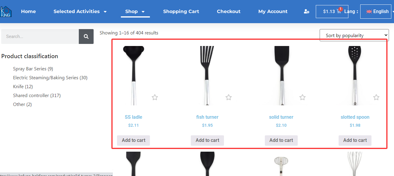

May 22, 2025 at 4:56 pm #17063012
Bigul
WPML Supporter since 01/2013
Thank you for the credentials. I was able to access the staging site backend and performed a few rounds of testing in a minimal setup (Elementor, WooCommerce and WPML plugins are only active).

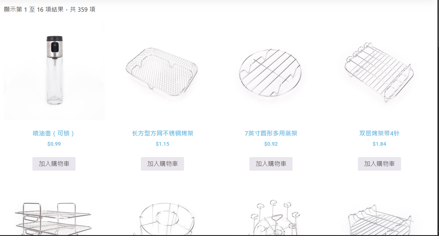

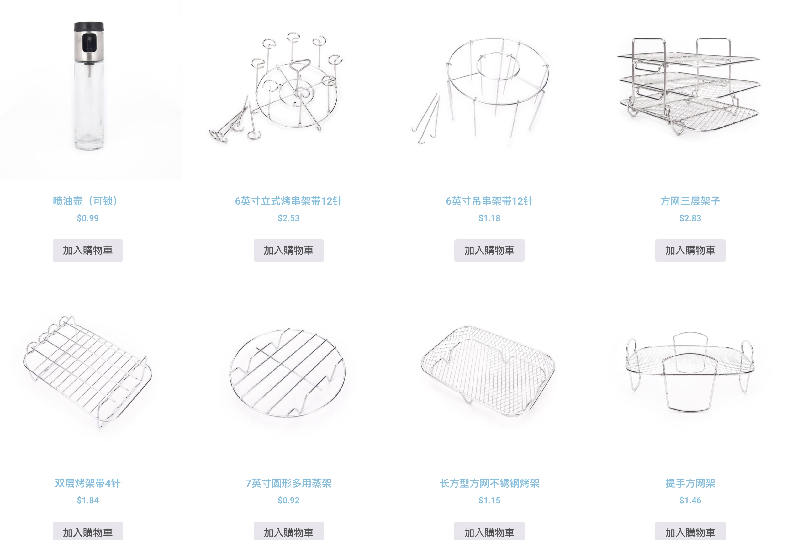

I have one question. Please check the attached images. The products are loading in a different order than the latest created order.
So, please visit the Shop page on the staging site (hidden link) and confirm whether it is showing the expected results in Chinese under the minimal setup.
Thanks!
Bigul
May 23, 2025 at 1:31 am #17063897
edmondC-2

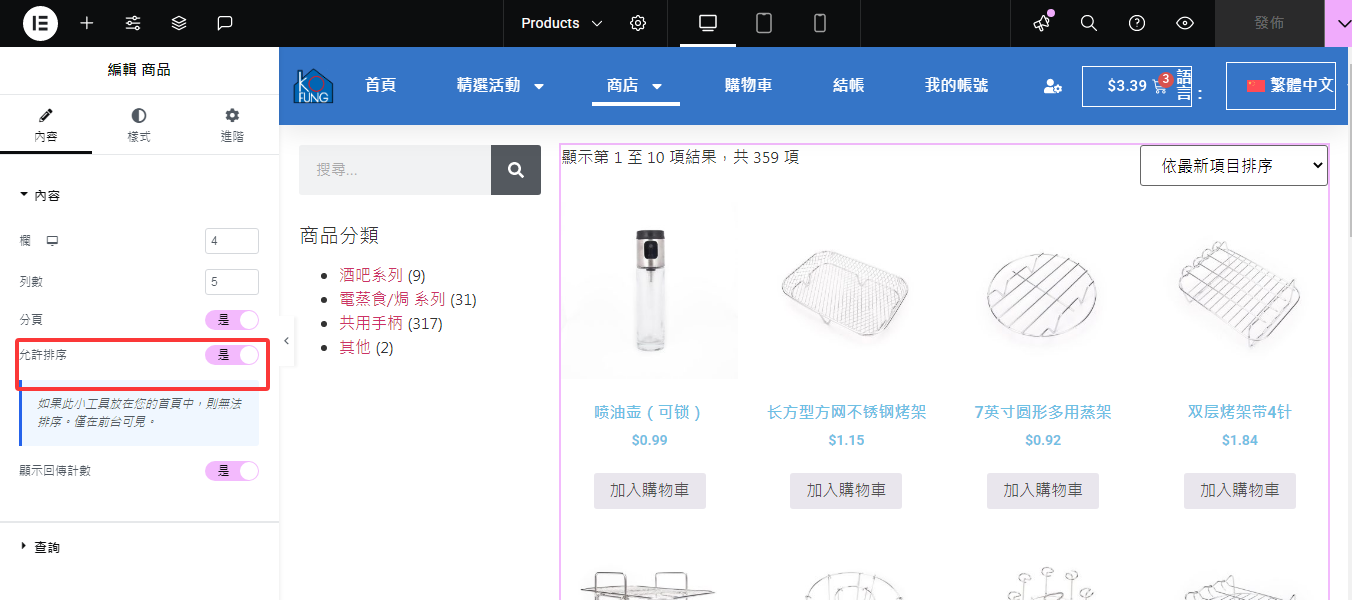

Yes, I saw it. It should be products added at the same time because they are ranked first by the latest product. It may be due to the first sorting being (date) and the second sorting being (name). I only have the sorting switch option in the Mentor editor and there are no other sorting rules, or you can see if there are any methods to make their sorting consistent. Thank you

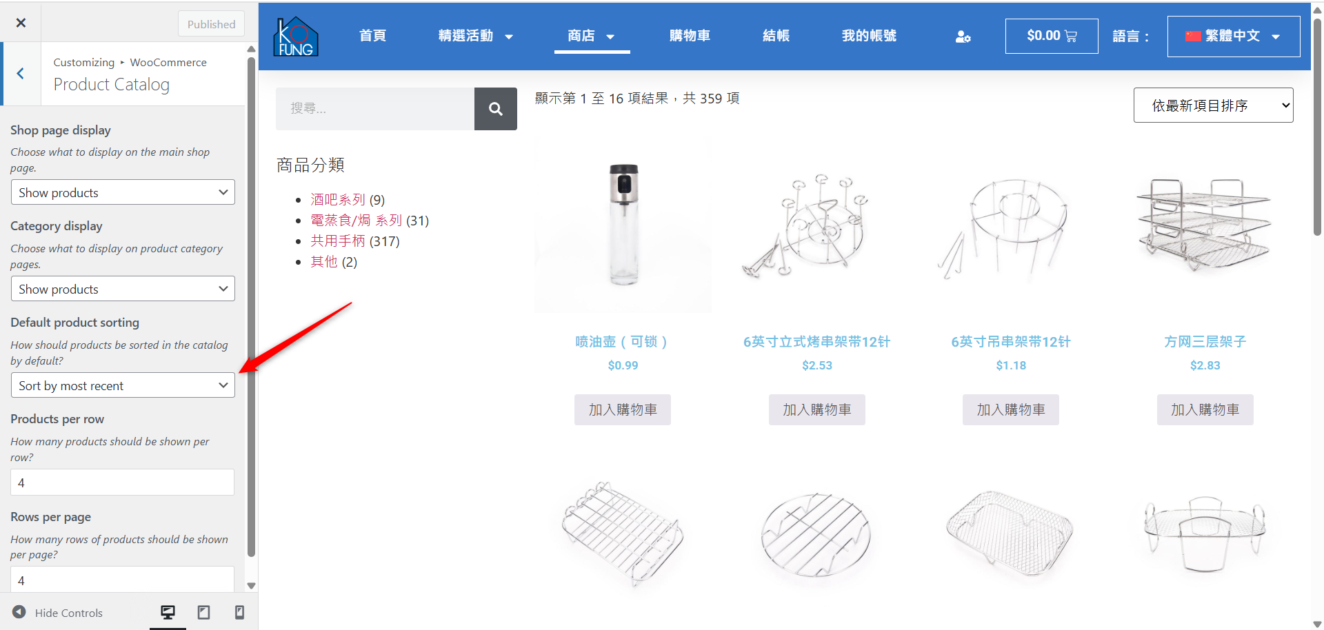

Thank you for the updates. To make sure, have you selected the *Sort by most recent* option in Appearance >> Customize >> WooCommerce >> Product Catalog >> Default product sorting? Please check the attached image for more details.
Thanks!
Bigul
May 23, 2025 at 9:57 am #17065355
edmondC-2
Yes, the selection is based on recent additions

June 11, 2025 at 4:42 pm #17127315
Bigul

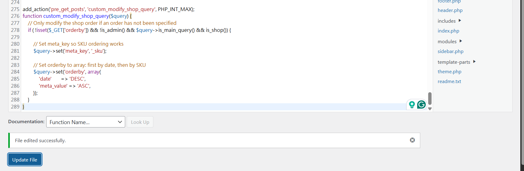

We are getting the expected results on your staging site after adding the following snippet to the theme’s functions.php file. This code sorts the products first by date and then by SKU.
Please check the results and let us know your feedback. Refer to the attached images for more details.
add_action('pre_get_posts', 'custom_modify_shop_query', PHP_INT_MAX);
function custom_modify_shop_query($query) {
    // Only modify the shop order if an order has not been specified
    if ( !isset($_GET['orderby']) && !is_admin() && $query->is_main_query() && is_shop()) {
        // Set meta_key so SKU ordering works
        $query->set('meta_key', '_sku');
        // Set orderby to array: first by date, then by SKU
        $query->set('orderby', array(
            'date'       => 'DESC',
            'meta_value' => 'ASC',
Thanks!

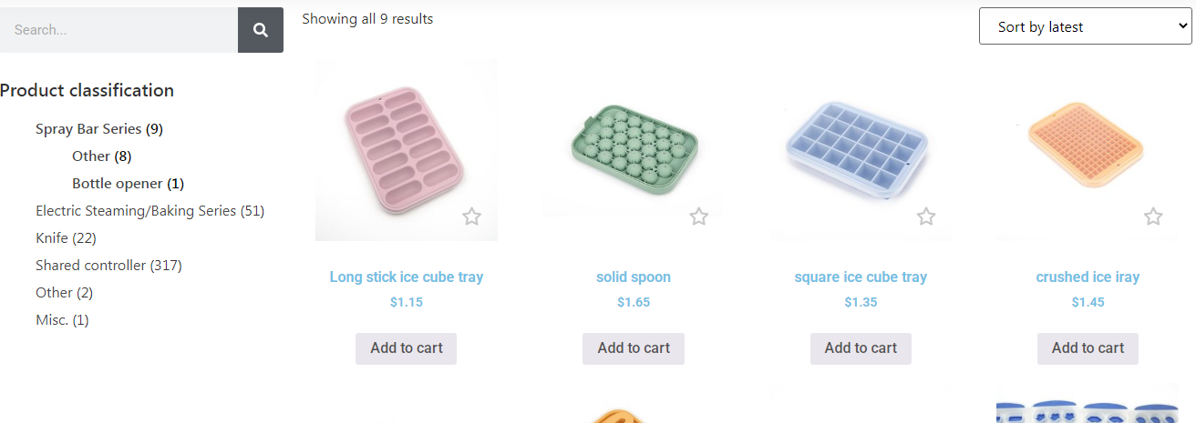

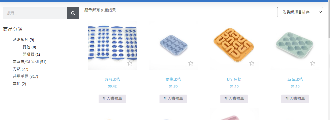

June 12, 2025 at 2:21 am #17128158
edmondC-2
Hello, the sorting of the product homepage is consistent, but when selecting a category to view the products, it is still inconsistent. Could you please solve this problem as well,
