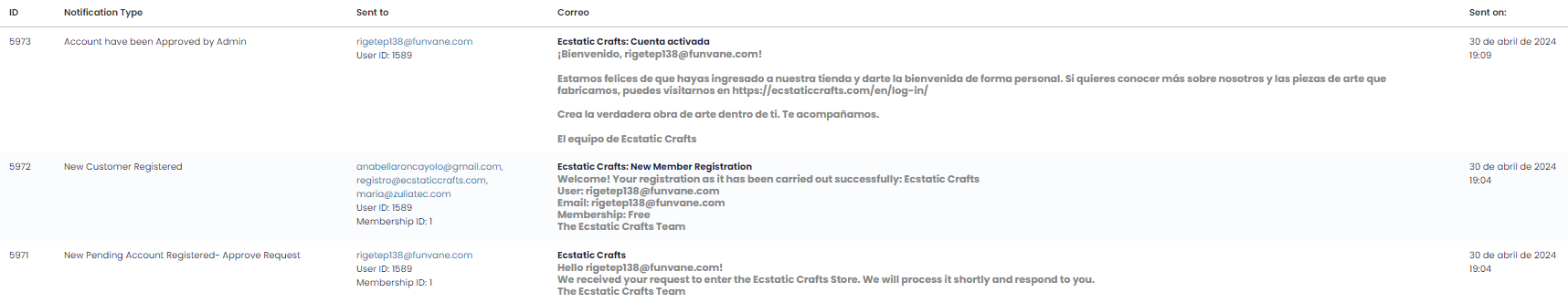

I have tried to replicate this, but even though I select the English language in the user profile it still sends me the approved account notification with the Spanish version.
I attach the image of the records so you can see that it only happens with that email despite making the language adjustment in the profile.
